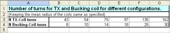

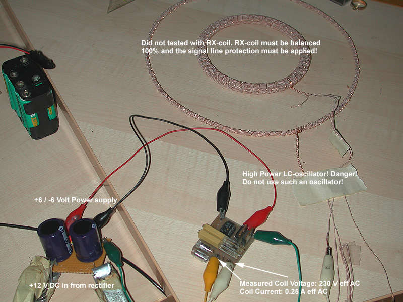

New Concentric Co-planar Coil with Strong MF.
    For all, who wants to experiment on different coil configuration, look at the table below. Keep the mean diameter of the coils as specified and take the number of windings for TX and Bucking coil as needed. Tolerance: +- 1-2 turns.
    Aziz
      Wow! The coil even can be driven with high power LC-oscillator.
      But I didn't tried the RX-part yet. Too much magnetic fields.
      I have to limit the LC-oscillator power and protect the signal lines.

          I found great fundamental background on IB-coils now. Some simulations showed me, that this coil type isn't good as expected! So do not waste your time! Wait until I have some more good news!
          The reason I found was the magnetic field strength decrease over the height z of the coil configuration. This decreases much more than compared to a standard IB-coil. It has obviously more magnetic strength on its nearby, but we want a magnetic field strength at a far distance to coil to achieve more depth sensitivity.
          I will investigate more on the coming days/weeks, to design a better IB-coil. I have to implement some features on my coil software, to get more compareable coil configuration figures.

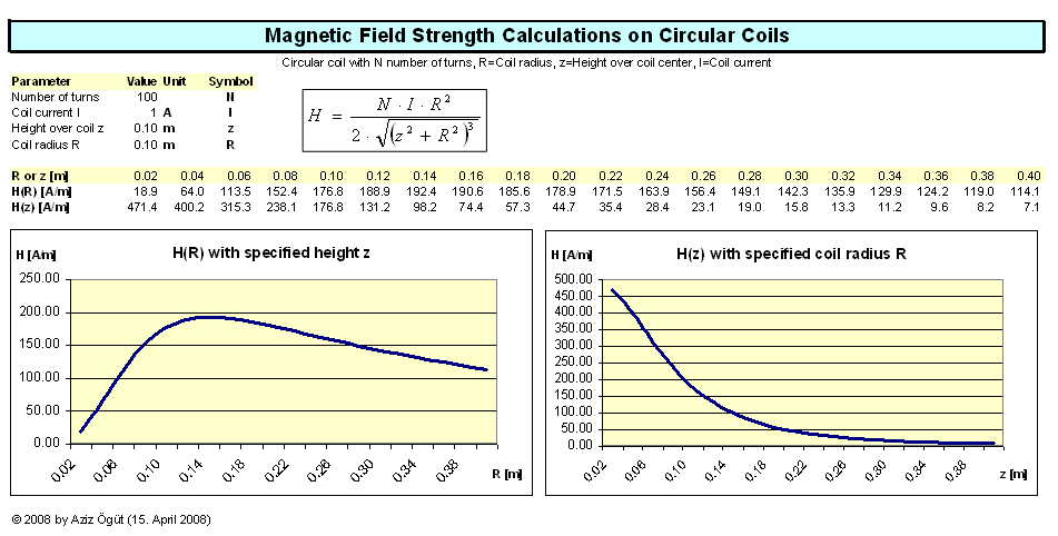

                  Has anyone figured out the sensitivity to a fixed given target and variable coil diameters with fixed number of turns? This could help me, to proof my results.
                  For all, who wants to experiment with coil diameter, magnetic field strength at a given height z, see attached files.

                      The reason, why I investigate into the magnetic field strength decay is following:
                      - on some coil configurations MF decays very fast to zero even it has a local strong MF (as this proposal coil design). I didn't notice this in the past.
                      - looking now closer to the decay behaviour of the coil configurations, to achieve a better depth sensitivity. This is my main effort. More depth sensitivity.
                      I didn't look much closer to this decay in the past. But this is what sells.
                      So, the dominating magnetic field coil should be as big as possible. But not too much, not to loose the sensitivity for small objects. If the TX coil gets too big, the magnetic field decays also at a given height center position. Of course, the size of the RX coil matters too.
                      This will lead to a far-field analysis of the coil configuration. Ignoring the near-field, I am focusing on the far-field now (more depth).
                      Any hints are welcome.

                          Metal detectors work by induction, and this is a near-field effect. What you are attempting to do is extend the range of the near-field, not perform a far-field analysis. It's probably just a terminology problem - like "complex resistance", when you really meant "complex impedance".
