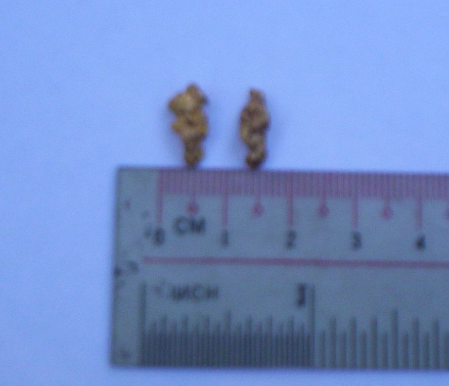

          Hi Aziz,
          Ground conditons are a big factor!
          I have attached a picture --sorry it's a bit out of focus--of some very small nuggets that I can detect with a 250mm coil in some ground but with a 350mm or larger coils are near impossible to detect in the same ground conditions.
          As ground conditons change the 350mm coil can detect them but not quite as good as the 275mm coil.
          Then also to make it more difficult for small targets, i have had to use larger coils in some ground conditions to cancel out ground noises, only god knows how many small targets i have missed due to this fact.
          This may be due to the fact that larger coils lack the punch of the smaller coils & therefor the eddy currents are to weak to detect.
          This brings the other question into mind, if we make the larger coils with the same intensity flux as the smaller coils will then the ground noise issues be the same--one would think yes?
          Bigger targets are no issue but they produce more eddy currents for detection.
          Smaller targets are harder to detect because they produce LESS eddy currents, if the smaller targets are induced with a stronger magnetic field from smaller coils they produce stronger eddy currents for detection.
          In some cases larger coils with weaker magnetic fields will of course not produce sufficient eddy currents in small targets, larger targets will produce more eddy currents.
          An object with twice the surface area of another, will have a detection signal near twice that of a smaller object but it will not necessarily be detected twice as far away.
          The larger target will produce the same detection signal at a distance farther away from the searchcoil than the smaller target.
          Three things determine whether the eddy currents produced are sufficient for detection. field strength, target size and surface area.
          Field strength for me is the big issue.
          Setting the detectors for mineralised soils etc also won't help the situation with large coils & small targets, it seems the more we do to cancel out nature the more we do to cancel out what where after.

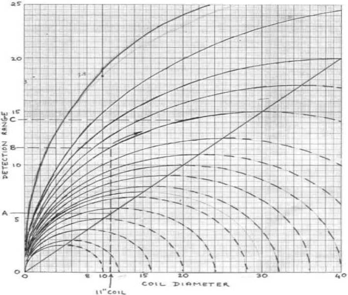

                          Qiaozhi
                          I don't have the graph. You might want to Eric Foster's PI forum and ask him to repost it. He gives more textual information at the link below but unfortunately the referenced graph is missing.
                          http://www.findmall.com/read.php?34,...593#msg-131593
                          Summary. You can increase the diameter of a coil until the coil radius equals the detecting distance from a particular target to that coil size.
                          bbsailor
                          • #58
                            Eric's original graph attached
                            Stefan
                            Originally posted by bbsailor View Post
                            Qiaozhi
                            bbsailor
