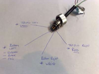

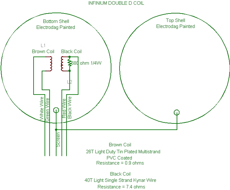

Hi Rov,
thanks very much for posting the Double D configuration.
I have drawn up a basic diagram to show the connectivity and I'll buzz out the pins on the multipin connector and identify which pin goes to each color.
I also have an inductance meter so I'll also measure both coils and I'm hoping that the 680 ohm resistor won't throw out the inductance reading too much.
