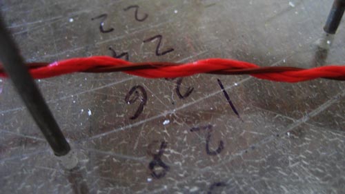

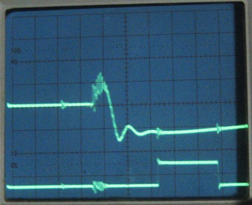

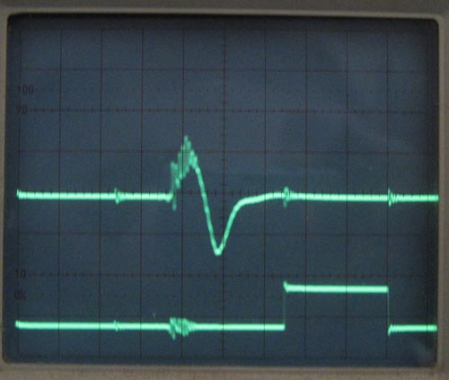

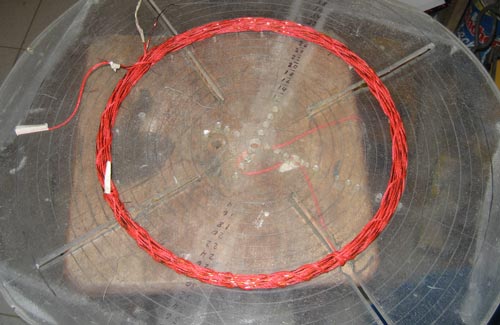

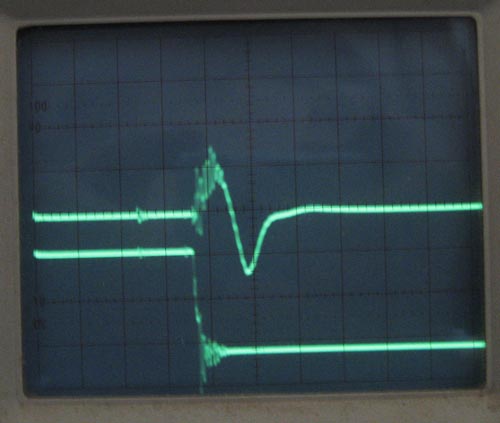

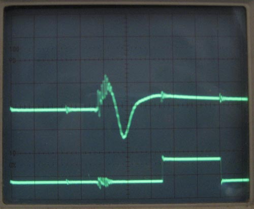

So now the coil is done, it did not quite come out as planned but I think the experiment was worth doing and the results do show some possibilities.
Below is a picture of the TX coil.
280mm outer diameter
0.8 Ohm DC resistance
23 turns #20 magnet wire with Polypropylene spacer
325uH inductance
Tinkerer
