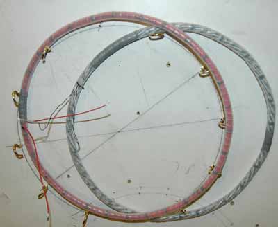

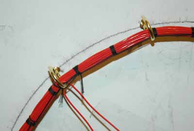

I got my teflon wire a few days ago and today I built two coils.

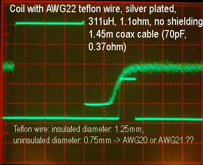

The first one is built with AWG22, silver multistrand wire, 19 strains. The coil has 21 turns. After the polypropylene spiral added (with no shielding) the inductance is 311uH (my LCR meter is able to measure capacitors with a precision < 1%, I hope it does about the same with the inductors). The resistance of this coil is 1.1ohm.
The inner diameter of the coil with the PP added is about 26cm, and the outer diameter is 27.8cm.

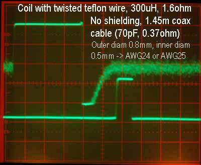

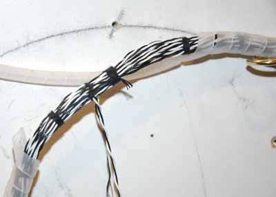

The second coil is based on your idea of using a spacer around the wire, to lower the interwinding capacitance. I used two twisted wires, AWG30 (or AWG26, I am not sure). Because of the twisted wires wound together, there is some air in betwen turns. The second coil has 301uH, 1.5ohm and also 21 turns.

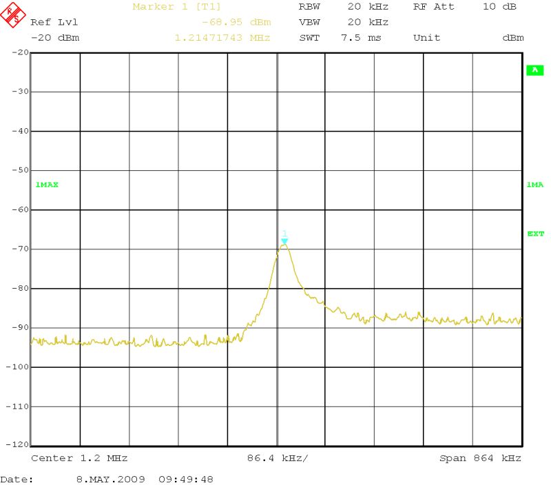

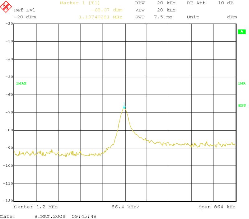

Tomorrow I will measure the self-resonance of the coils at work and publish it in here. In about two weeks, I will have the Scotch24 shielding and I will measure them again, to calculate the other parameters, according to bbsailor instructions.
Nicolae
