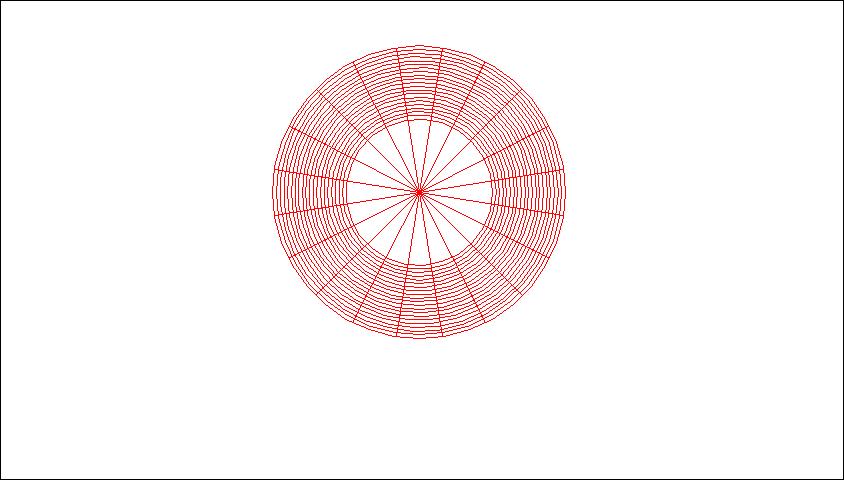

    A while back I presented the question "what if the coil loops were put in parallel instead of series?". One of the subquestions that's been chewing at me is just how one would go about accomplishing that. I drew up a possible way to accomplish this on a PCB layout (see attached jpeg).
    The trace widths and start/stop points for each loop were strictly arbitrary for the sake of example. Working trace widths would have to be determined, I drew each loop at 360 deg but 180 or 90 could just as easily be generated, and I used an inner dia 1/2 the OD because I'm still stuck on the idea of concentric coils. The area could be divided with xmt coil on outer third, rcv on middle third and hole for inner third.
    The idea behind this layout is to mechanically shorten the actual distance the xmt signal has to travel, to hopefully shorten the xmt pulse decay.
    In this case it travels at most two turns, instead of twenty.
    I don't know if this would be effective or not, but it's been bugging me, so I thought I'd present the idea to the forum and see what you guys think...

    I'm thinking it would have a Boat load of capacitance!
      Interesting idea, please report how you deal with (small) resistance and inductance of coil.

        While we are all just taking guesses, I'd say that 1 turn is going to have a very small inductance. If you parallel 20 turns together, the inductance of the coil is going to continue to get much smaller, approaching zero (not zero but very small). This will appear as a short to your detector and your FET might not be happy with it. Let us know what you find out.
        Boattow
          This is interesting... yes, L & R will be very low but for a PI I doubt it will matter... the FET already sees an almost-short. C should be about the same but with a much lower L it will have a much smaller effect. In the end, the coil should be blazing fast, question is does it give equivalent ampere-turns? I can't see why not, yet.
          - Carl

            Did some quick calcs and there would be 30.4 meters of wire which would be comparable to a normal coil of 600mm dia. , Im guessing that the ind. and res. wouldn't be far off either , so like carl says should be one fast bleedin coil, also pcb coils are better with smaller nuggy's....maybe it's a goer!!!

              Yeah, what I drew was strictly the xmt coil, for a PI, figured a rcv coil could go inside (concentric layout). Hadn't thought much about wether rcv coil should be traces on board or separate windings. Just wanted to present the raw concept to you guys.
              I literally live in my truck right now, and have my hands full designing the control box for a detector. I have no idea when I'm gonna have time to play with this idea, and am not really set up to be etching boards. If somebody else wants to explore this idea, by all means, please go for it!

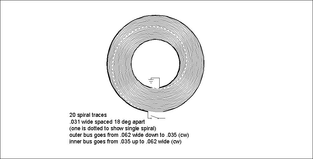

                  Right on! The one glitch ya might run into is connecting the individual wires. I suspect solder might cause problems, maybe a conductive adhesive?
                  I attached the wireframe I built the pattern on, I developed it in a CAD program. It (or similar) might help in laying out the pattern on whatever substrate you use.
