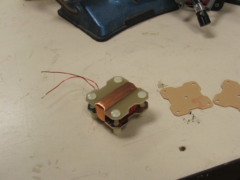

spiral PCB coil
    Use a two later PCB, 3oz copper (105uM) on one side, 1/2oz. on the other (17.5uM).
    Top side used for Tx, bottom for Rx (with twice the number of turns for transformer action).
    Paint with graphite for screening.
    You can calculate all parameters quite reliably using F4 as a layup (resistance, capacitance etc) and get the design right first time.
    Qiaozhi, if you or Aziz design it, I will pay to have it made. If I make 100, price will be £38 or thereabouts. Two prototypes will cost £225 each (based on a 350mm diameter coil with a 150mm hole in the middle).
    The bulk price for 100 covers the cost of building a commercial design VERY easily as the coil will save 2 hours per hand wound in labour (spend to save) 200 is even cheaper!
      Here's some questions for you:
      1. How many turns do you want on the top layer (TX) layer?
      2. How many turns on the bottom (RX) layer?
      3. What track width do you require?
      4. Have you thought about whether you want any nulling?
      There is a flat spiral coil calculator here ->
      If you can supply the details, I can send you a Gerber file.

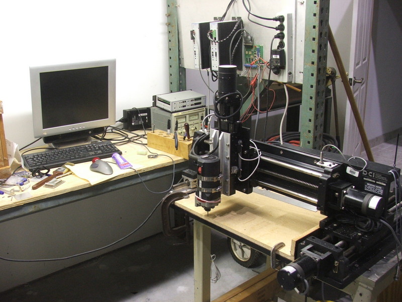

        Qiaozhi,
        My cnc is a recycled automated IC wafer tester. It came from
        Applied Materials in San Jose and was going to the crusher.
        Lucky for me a friend saved it.
        I added the z-axis, motor drivers and RS232 interface.
        Very useful for cutting out panels, making widgets and engraving pcb's.
        For lots of diy builds, check out CNCZONE.COM forums. Many machines on ebay also.
        If anybody wants to start a thread under off topic or general, I would
        be happy answer any questions.

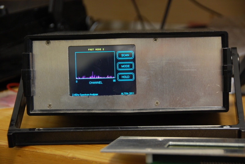

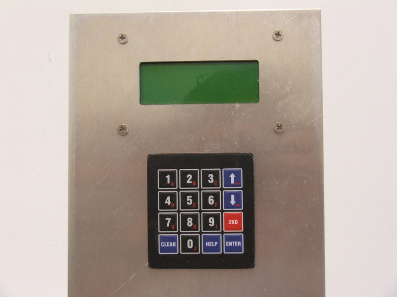

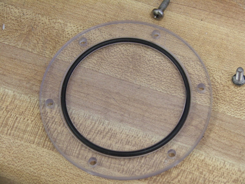

        Here's some stuff I have made
