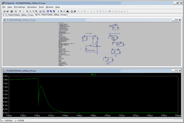

                          A spacer between the coil winding and the shielding greatly reduces the coil to shield capacitance.
                          What influence does the coil capacitance have?
                          Below is the coil current of a traditional PI, critically damped, with 100pF capacitance.
                          Take note of the coil current decay and the time it takes to reach near zero A.
                          Tinkerer
                          • #73
                            coil to shielding capacitance
                            100pF capacitance

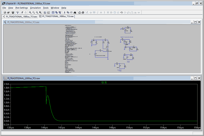

                              Coil to shielding capacitance
                              Now, how does it look with 500pF capacitance?
                              Take note of the time it takes for the coil current to reach near zero A.
                              Also look at the coil current decay slope. See how it drops first and then goes up again. What this means is that the current generates eddy currents of one polarity in the target and then as the current direction reverses, it nulls these eddy currents and only when the current is on the final slope it starts generating the eddy currents that give us the target response.
                              Tinkerer
                              • #75
                                Good graph Tinkerer,
                                500 pf including including the cable capacitance if a good yard stick for the Minelabs.
                                Have you opened up a ML coil to see that the winding is level with the bottom of the foam in order to place the windings as close as possible to the target.......but in doing so the ML winding is hard against the Shielding thus adding maximum c. Their testing must of told them that it is more important to gain 4mm of depth in relation to coil to target proximity than to reduce the coil capacitance and to optimize DV/DT.
