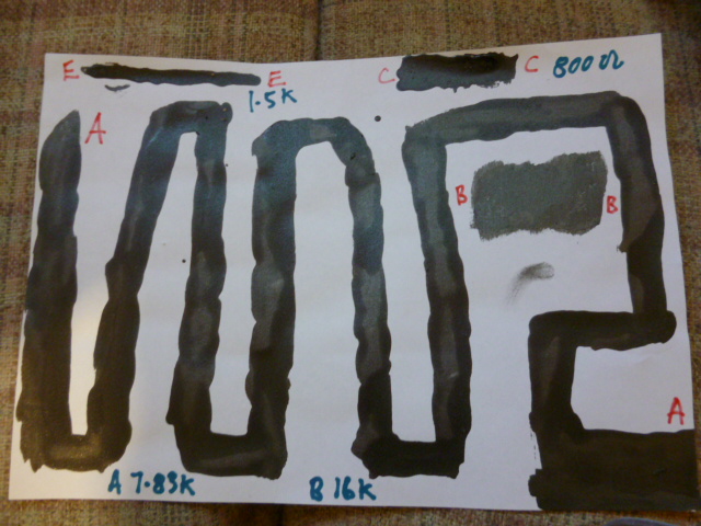

        • Today just for fun I tried making a crude shielding paint using ordinary wood varnish (not marine varnish) and graphite powder.
          I used four teaspoons of varnish and two teaspoons of Pressol brand (made in germany) graphite powder,
          mixed it up and painted some snail trails about half inch wide on some printer paper .
          It still has to dry properly but some initial testing with the multimeter looks good,
          more to report later.
          • Well the varnish has dried and the results appear to be ok.
            The long snail trail is roughly 56 inches or 1.4 meters long
            and has a resistance of 7.83K AA, it is painted on very thick,
            you can alter the resistance by varying the thickness of the paint
            BB is 16K I painted this very thin
            CC is 800 ohms
            EE is 1.5K

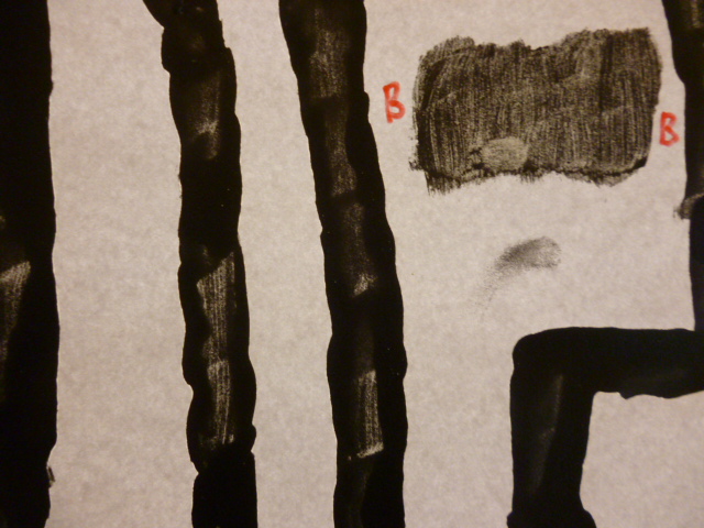

            • If you hold the paper up to the light you can see how thinly painted patch BB is
              and you can see some brush marks in the snail trail to.
              The only real difference I can see between "marine" varnish and ordinary varnish
              is marine varnish is supposed to be more flexible and UV resistive
              but I can bend the paper over and it does not effect the resistance
