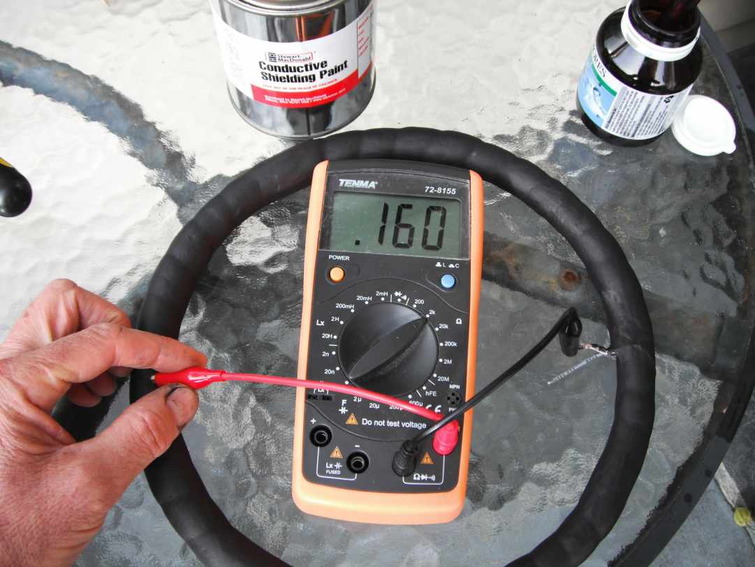

            It seems good Simon, 160 Ohms across coil from 2 thin coats, I can hardly tell I've used any from the tin.
            I may give it one more coat and see if my Minelab spits it back at me.
            Appears to be more carbon in it than I'd like, but all the same it's very similar to what Coiltek use.
            Will report back as to how it performs in the field.
            Cheers
            Kev.

              160ohm seem lowish already
              • #97
                Hi Davor,
                Minelab PI are very very fussy when it comes to coils and the shielding must be right if you want to build an operational coil, let alone one that surpasses stock standard.
                The graphite card Minelab use has a resistance of 40 to 45 Ohms per inch, and the coil above measures 35 to 40 Ohms per inch so it's in the ballpark.
                Of course from a frequency domain perspective, from which I believe you are viewing this, it would be way too low, so maybe for VLF you'd need to water this paint down a bit.
                I tested the coil at a beach which is littered with volcanic rocks, and it performed superbly, super sensitive while stable, now I need to test it on the goldfields which I intend to do within the week.
                The spacer on this coil between the windings and shield is a very low density foam which has a very low loss tangent, and I think this is contributing to the excellent sensitivity and
                depth it is achieving. Here's hoping it will also cope with highly mineralised ground.
                Cheers
                Kev.
