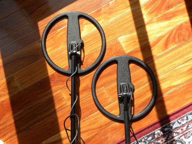

      Db I was just looking thru my US Plastics ca. and came across this sheet ABS so I jumped to their site and came up with the url for it, I tinyized it.
      http://tinyurl.com/2ayduxc
      I haven't gone to Micro-Mark to see what their prices are but you mentioned that the sheets were small, well USP's sheet is 4' X 8' which should open up possibilities a bit.
      Dennis
      Yes, that description sounds similar to what I got from
      http://www.widgetworksunlimited.com/Thermoform_Plastic_Sheets_s/36.htm
      It does lead to a significant amount of waste though and it may be more efficient to order plastic in rolls. It generally has been costing me about $6.00 to make a shell but I think with a little research we could save a few dollars.
      More importantly though is my search for resin.. When it's all said and done, around $50.00 for a complete coil... All materials including shipping costs. Still, far cheaper than a commercially made coil and we can make them to suit our needs.
