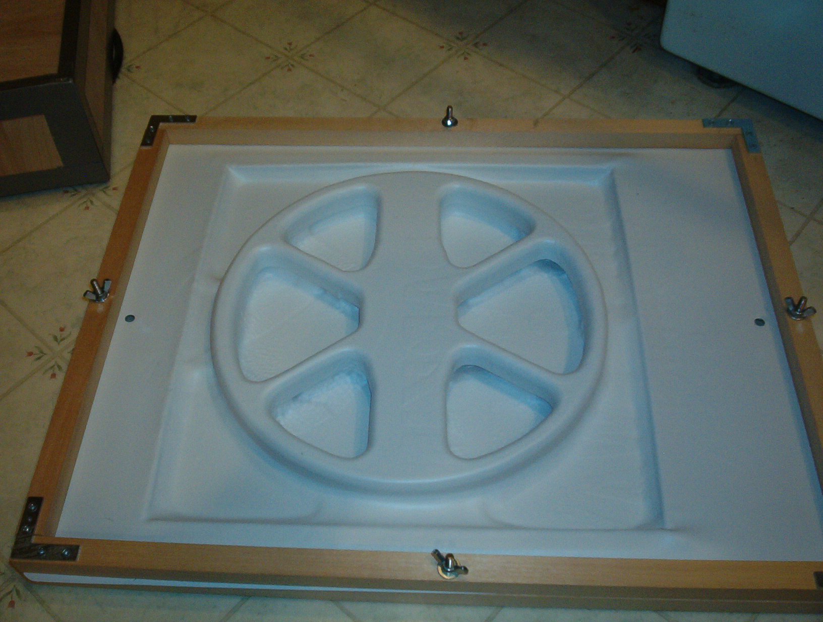

    I have been experimenting with making my own coil shells with some success. I have been using what I have on hand. I the example below, I used a simple plastic sign, heated in an oven to 425 degrees and placed onto a vacuum form.. Really easy to make.

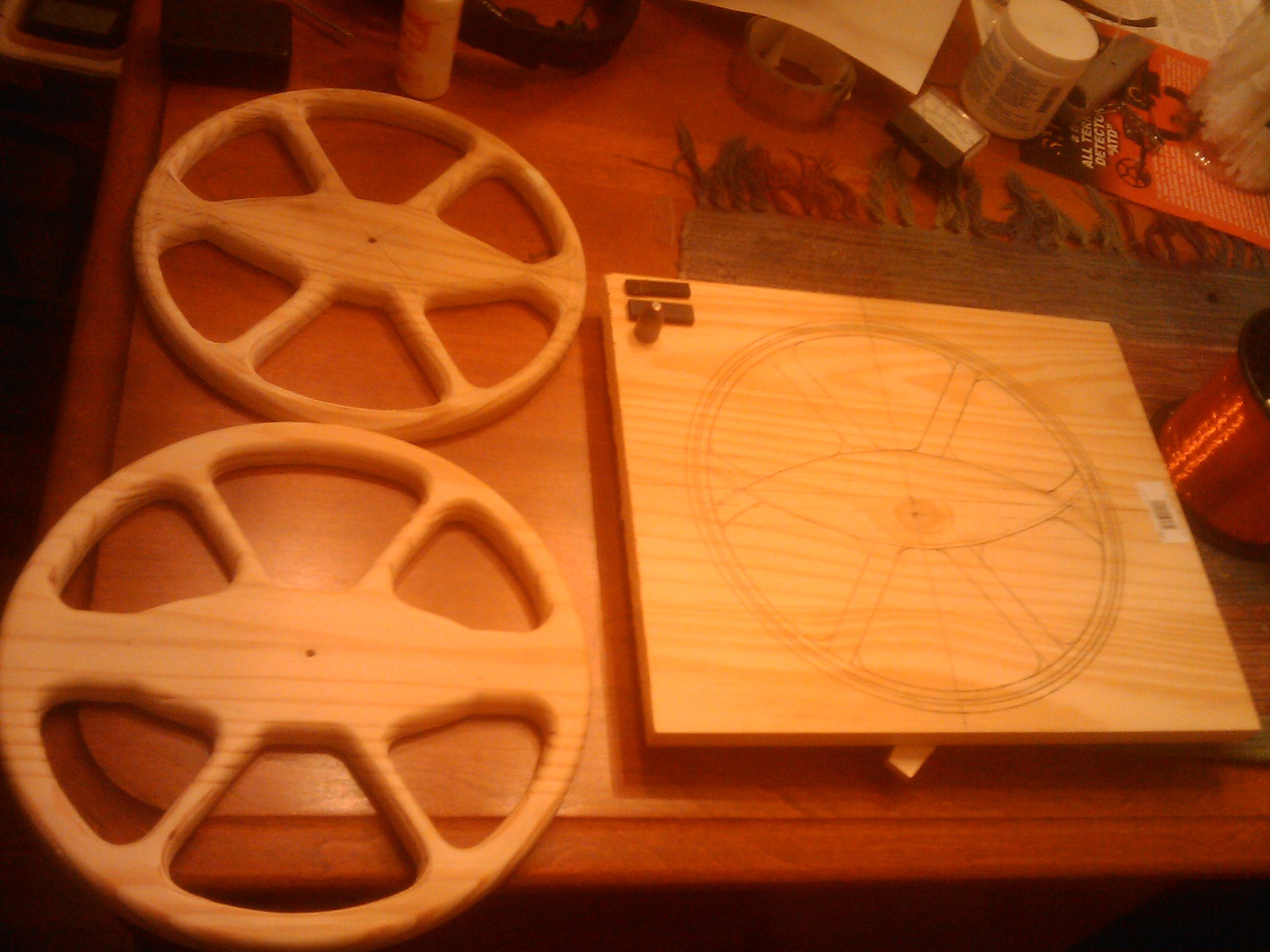

    How do you trim after forming? How are you making forms? Are you also making covers? or just filling up with epoxy?

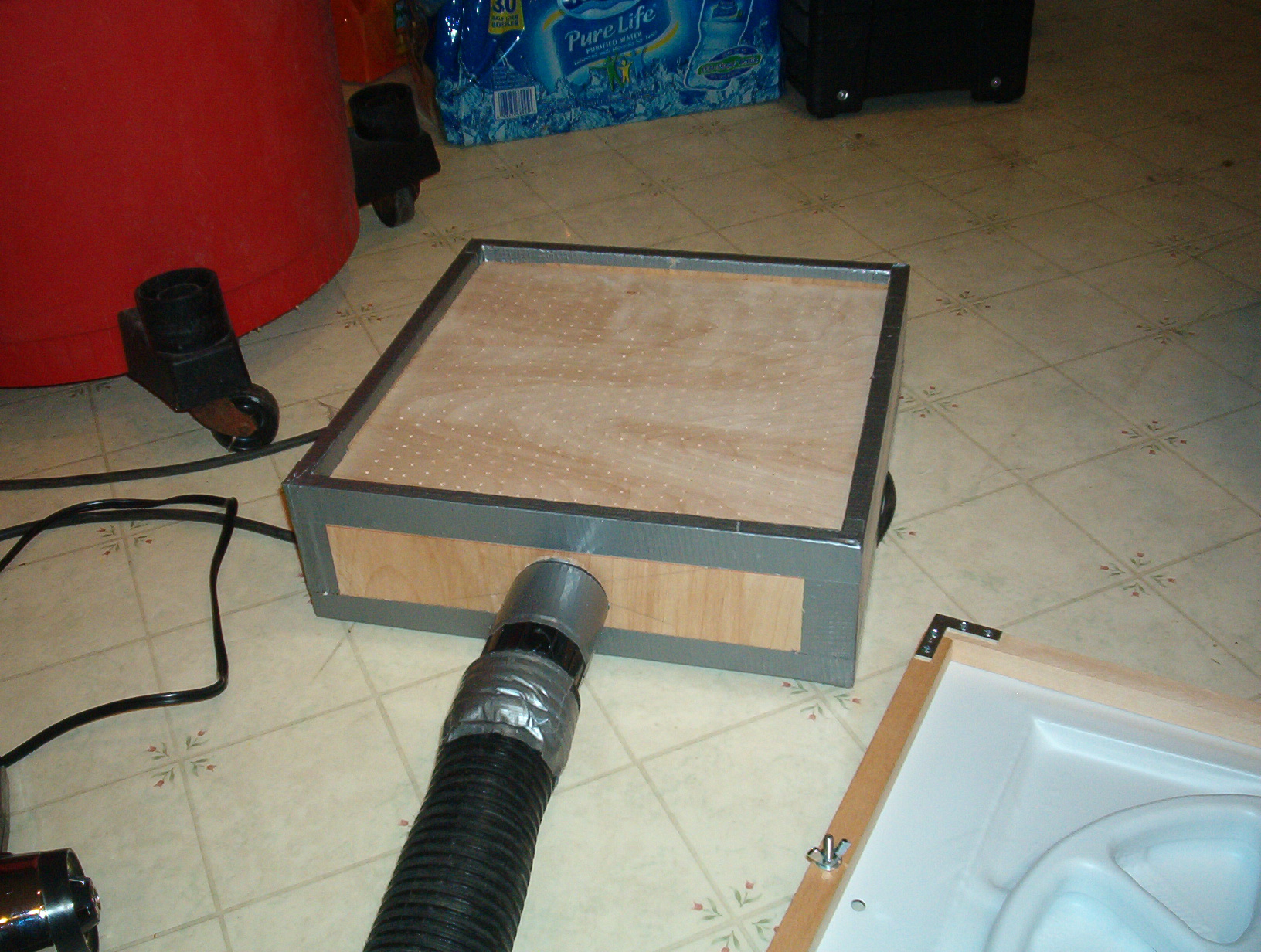

        Thanks for the information. I started with a wooden box and just drilled tiny holes, like an air hockey table. Then hook up a shop vacuum.
        I use a wooden former for the coil housing. The sheet of plastic gets put on a frame while it goes into the oven. Leave it in for about 1 minute @ 425 degrees. When it starts to sag, turn the vacuum on, take the frame out of the oven REALLY fast and lay it on top of the vacuum form table. Voila!

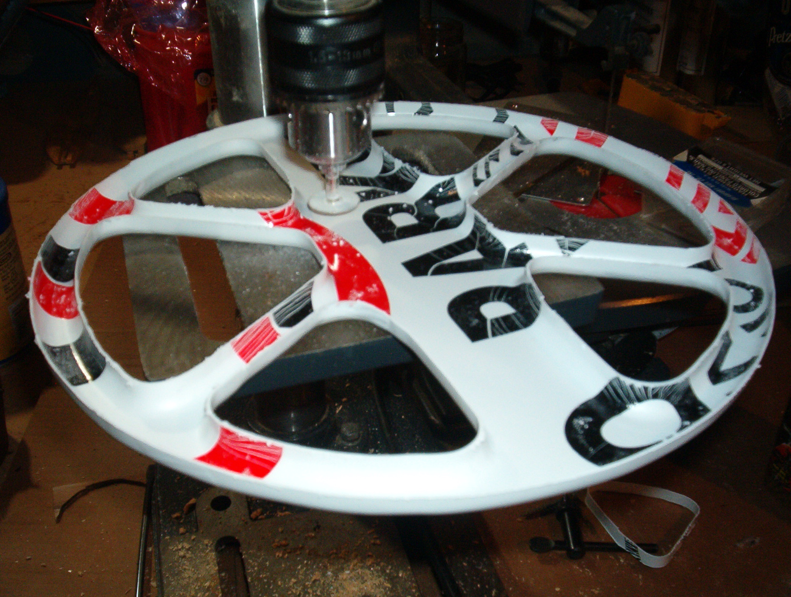

        I have heard that you can use a bandsaw to cut off the excess, but I just use a Dremmel cut off wheel on a drill press.
        Here is what the finished coil looks like:

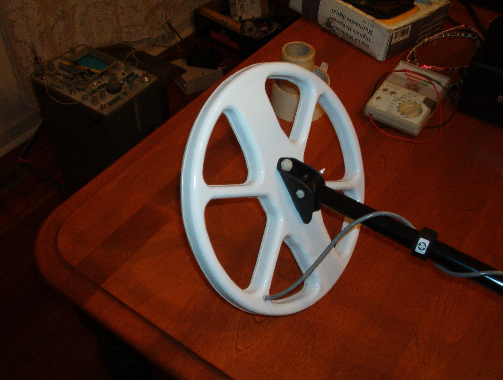

              Masterpiece. Congratulation.
                would a hot wire work to trim the excess or just make a mess of it?
                Barry
                  Yes, a hot wire cutter would work well. That's what the pros use. I never tried one though.

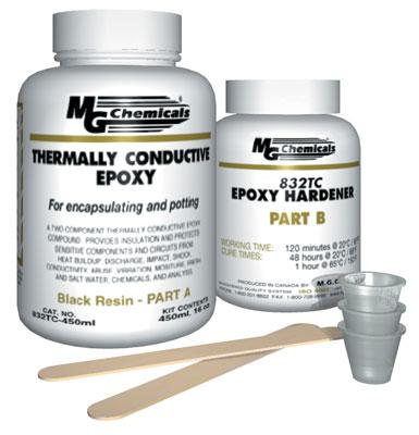

                    I think that I found what I was asking for - Epoxy.. I will order some and try it:
                    Or another one that looks like it may be fit-for-purspose:
                    I will post again here when I finish the next one.
                    Thanks everyone for the help.
                    Don
                      Still, another:
                      http://www.mouser.com/ProductDetail/...tMdf5xlKQhWcq2
