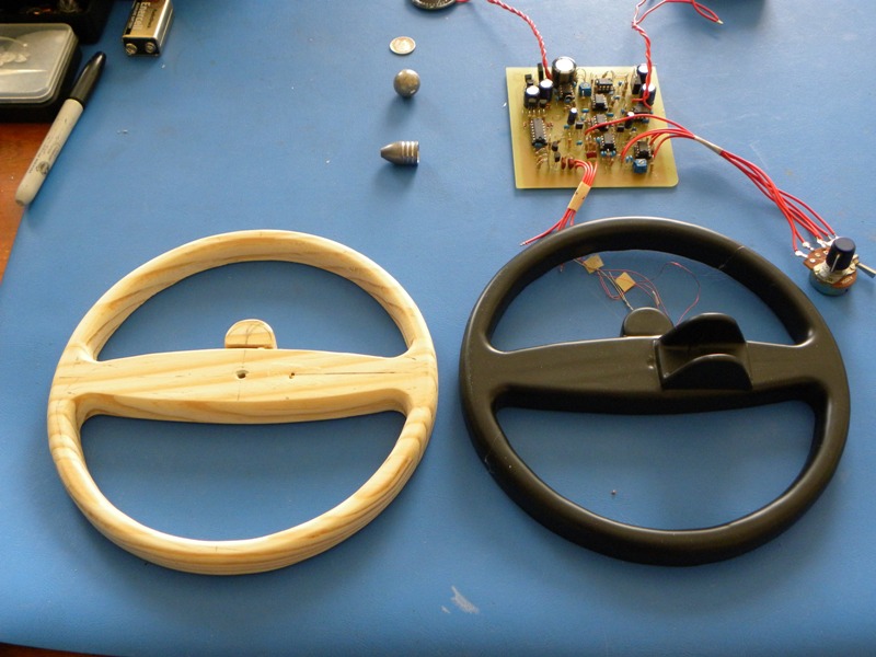

Vacuum forming coil housings
    Today's project

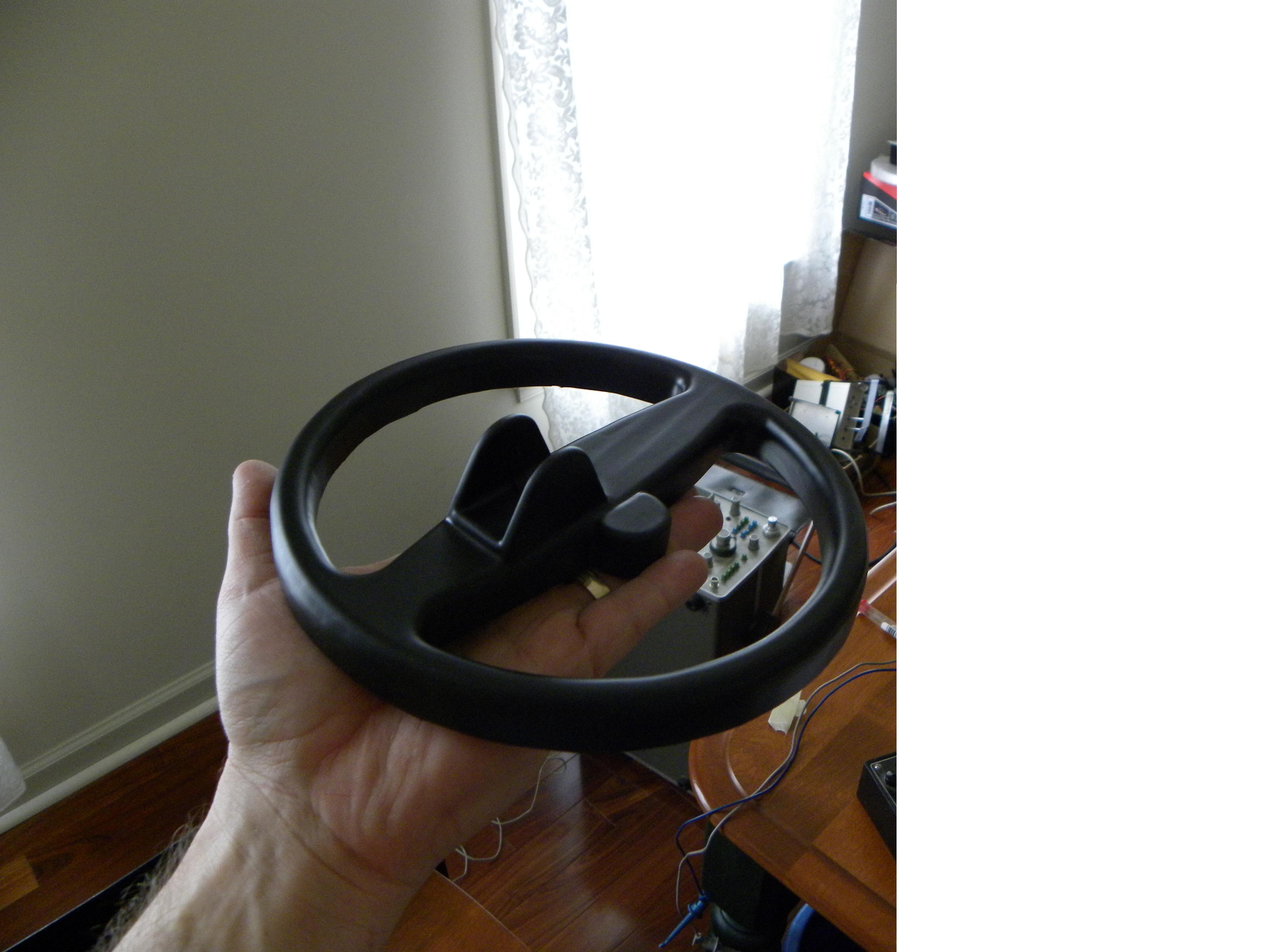

    8" coil for TGSL.

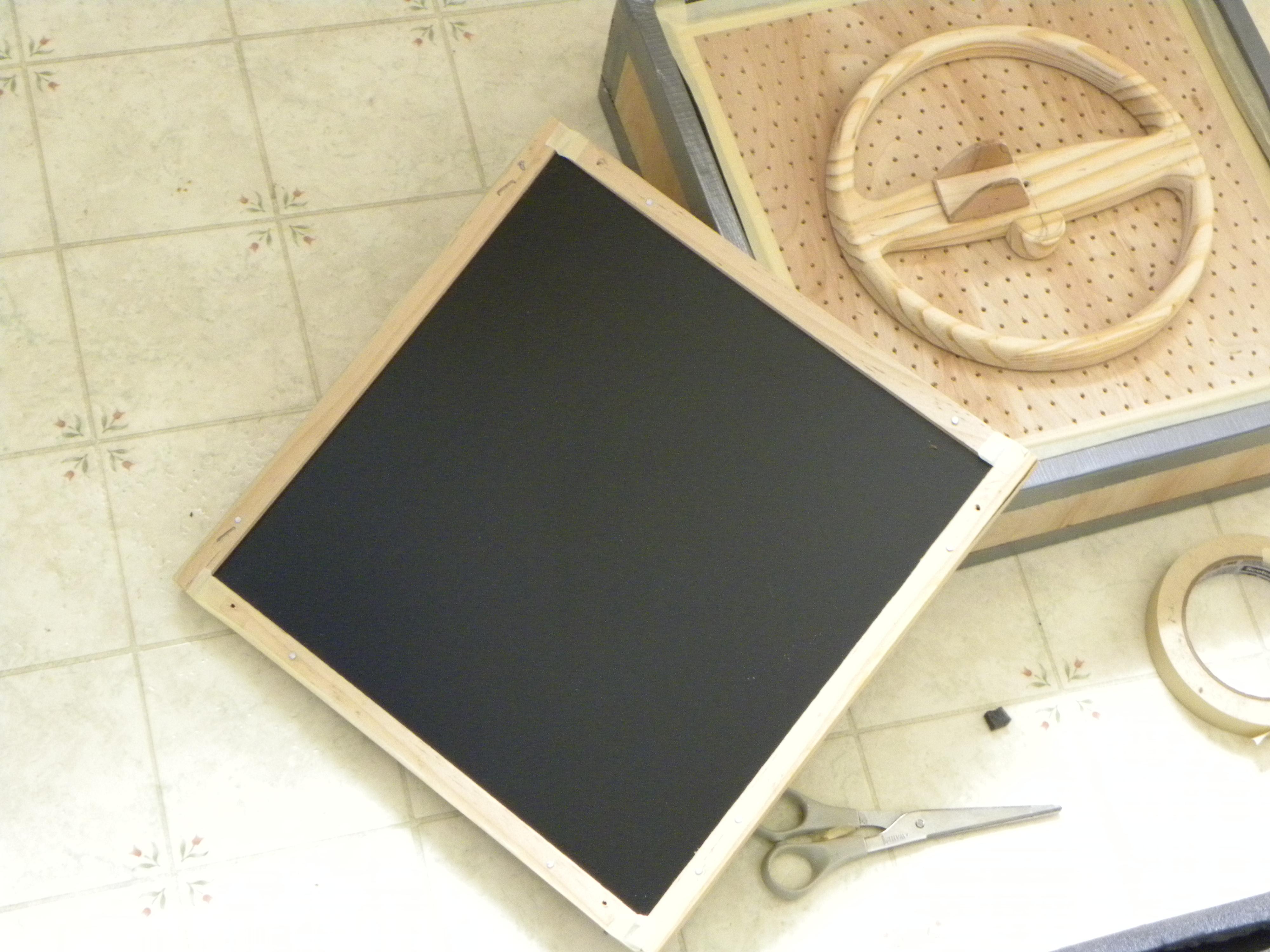

            dfbowers , nice work , I will start a next days for a wood box assembly , I bought yesterday a Polypropilene 1 mm it's thick enough? so a wood model how thick you make ? I have a 15 mm . Thanks a for your reply

              Do not worry. Your English is fine. For a form I used 5/8 inch pine, about 15 mm ?? It is soft and easy to cut. I just used a jigsaw and a router to smooth the edges.
              For the box, just make sure that it is big enough, so you do not have to make more than one! Construction is not important.
              A few things I have learned after a failure or two.. It is beneficial to have some space between the box and the form in order to get the correct shape near the bottom. I just added .25 inch spacers. Use gloves to help the vacuum pull down on corners.
              Have some sort of a guide to help direct the frame onto the board. You cannot reposition if you miss!!
              .060 inch or .062 inch is what all my store bought coils are made from.. Seems to be about the right thickness to start with.
              Good luck!
              Don
                Ok Don , I'm Alex not Luciano ;-) , so this evening I cut a square wood of 15 mm impress with a 26 cm loop pattern , I will cut with a router and manual saw
                tomorrow ,I will make a box , thanks for your hints , I will post a few photos.

                        I made the bracket out of 1/8" hardwood, glued together in 3 pieces. I could not get it out of the shell after forming, so I just left it in there! It work just fine that way, with no false signals in use but I wanted to fill with epoxy. I will try making a few more shells this week.
                        Don
