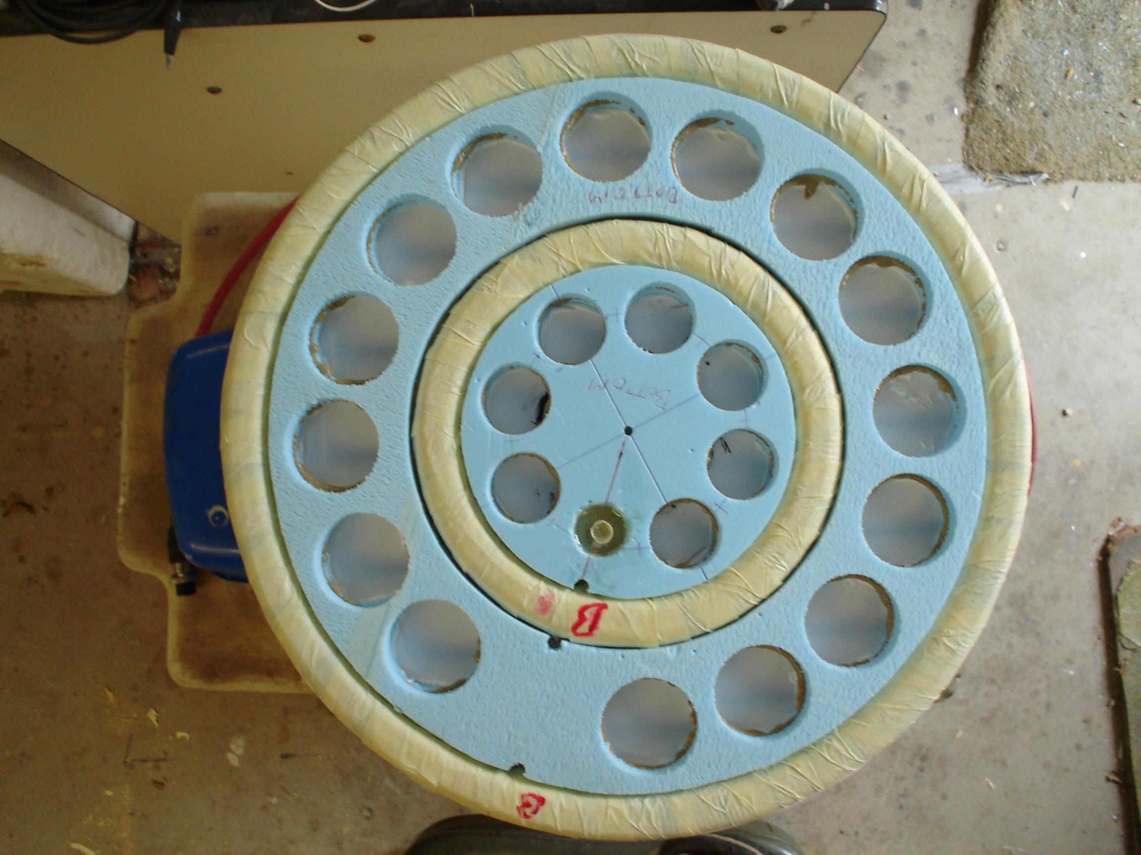

                    Hi Aziz and all here is one of my latest 18" Duel-Field coils prior to closing up the housing this is shielded and bonded into the top of the housing.
                    Regards, Ian.
                    • #85
                      Hi Ian,
                      your coil is looking great. I like it.
                      Looking forward to see the finished version.
                      Aziz
