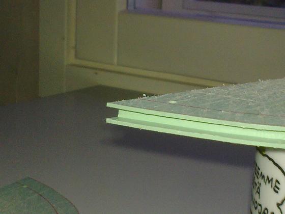

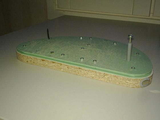

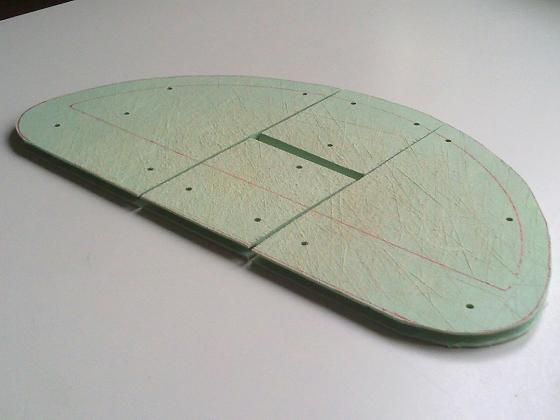

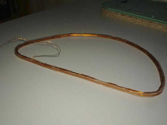

I was planning on using 1/4" dowels but I have not drilled the 1/4" holes in my platform. Good thing.
After reading about your problem, SB, what I may do instead is to use either L or D shaped hooks covered with a piece of Teflon tubing. I'll raise the windings off the platform surface and hope that whatever varnish or glue I use won't stick to Teflon.
"D" hooks would act as a channel. I have yards of regular shrink tubing but I'll need to purchase some Teflon.
