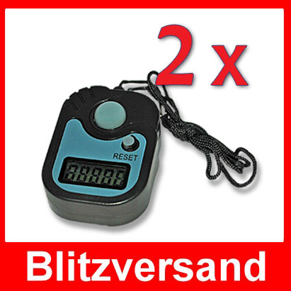

      Simple turns counter for coil making
      I often loose count while winding a coil.
      Can anybody recommend a cheap, simple turn counter?
      Tinkerer
      I don't know if you are still interested in a very simple answer, but I bought some really cheap electronic counters on ebay, added two thin wires so that I could add an external micro-switch.
      My first attempt did not count correctly because the switch needs about a 50:50 on to off time to count exactly right.
      So I placed the D shape on a bearing so that the half round of the shape holds the micro-switch closed for about 50% of the time/turn. Works great.
      See the picture for the ones I bought! I got two for about $5 if I remember correctly. I placed the wiring so that the button still works.....there was even a spare battery included for each one!
      If you want any further infos just ask.
