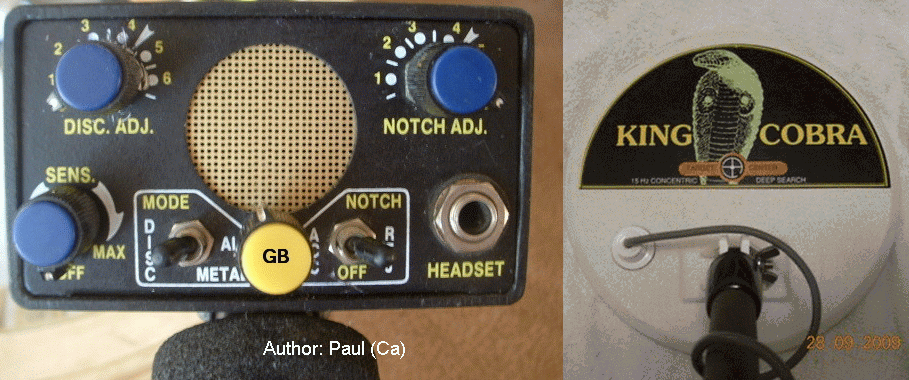

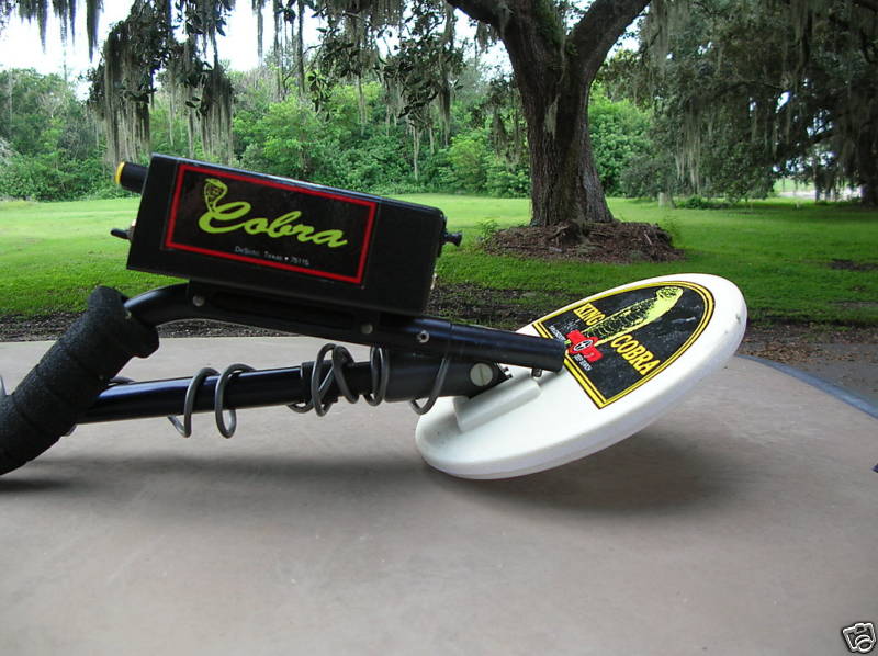

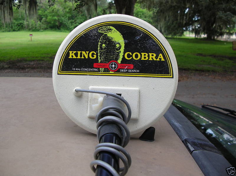

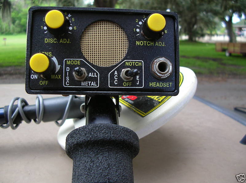

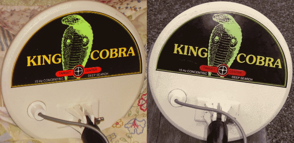

Already one year has passed since KT315 announced for the first time that it requires Search coil for King Cobra. Since he again mentioned that today, we tried to understand what that particular coil and looked for pictures to get data based on which we can design and make a coil. We found two photographs in the web from various sources to make sure that the perceived irregularities in one of them are not random. These irregularities are:
1. Used clevis is too narrow (less distance between the ears). This poses a risk of clevis breakage and it certainly bents at waving.
2. Metal bolt is used to tighten the clevis. This creates a parasitic signal in RX winding, which prevents the proper induction balance.
3. The notation "15Hz" on both coils clearly refers to the operating frequency of 15 000Hz. This frequency is too high for use on the salty beach because it creates too strong GND signal. (To be continued)
