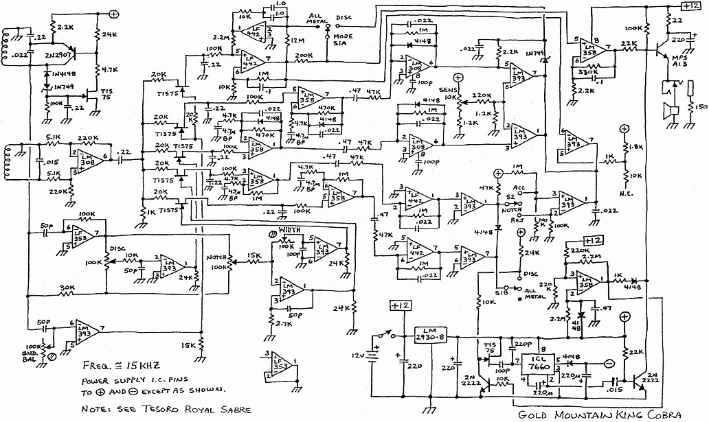

    The discussion is interesting and going in the very good direction. Set up however from the detector CobraKing. I send the part "of the true" schema KingCobra.
    The oscillator is very strange. The input amplifier is also atypical. The all this detector is atypical, but works sensationally.

      Sorry, I think about Cobra II production Discovery Electr. This is much more interested Cobra Gold Moutain Cobra (from your schematic) is typical, some modified Tesoro. This not especially interest for me. Detector from my schematic was know so Viper.
      Mrand

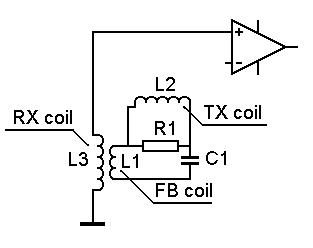

                      I'm looking forward mr Mrand or anyone else to send in the forum the rest of the circuit diagram in posting # 15 to understand how it works. It differs significantly from a conventional metal detector. See how by means of L1, inductively is loaded the RX coil L3 with resistance of R1:

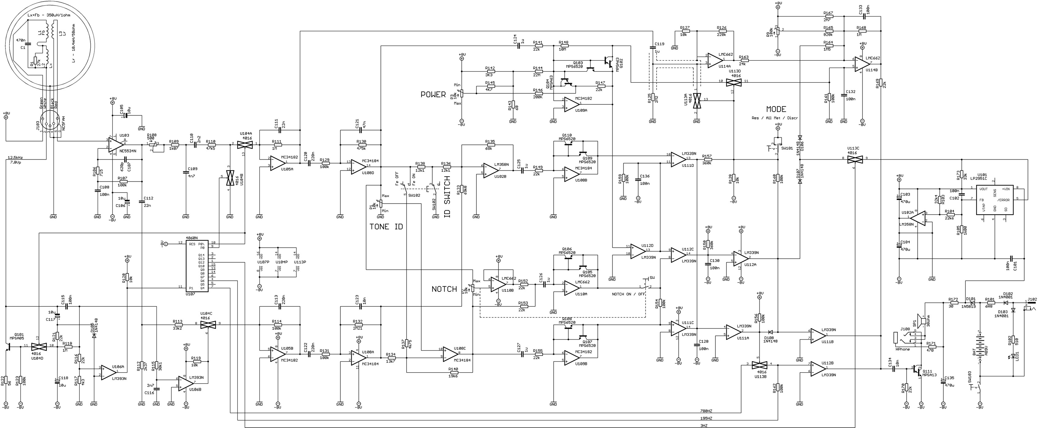

                        Sorry for the delay. At present I am very busy. (With what? Soon I will show). Circuit of the detector is very interesting and atypical through. It works superbly. Worth it is the wider discussion on the forum. Therefore I send the full schema. I drew him directly from plate. 2 weeks of the difficult work, because somebody applied crazyautorouter . I hope that I did not commit errors.
                        Mrand

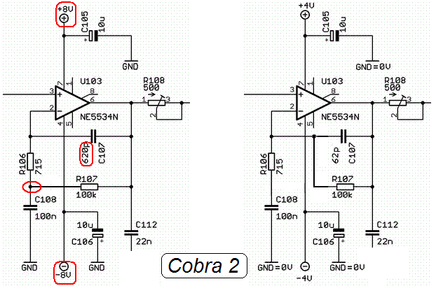

                            Errata in drawing
                            Errata in Cobra 2 drawing.
                            I have not managed to find instructions for use of the Cobra 2, to convince that what I say is correct, but based on the lettering on the circuit of Mrand in postings # 26, I think he has made the following errata:
                            1). Supply rails are +4 V and -4V relative to ground if battery voltage is 9V (as is written near to it).
                            2). Resistor R107 should be connected to inverting input (pin 2) as shown below.
                            3). Capacitance 620p of C107 is too large. If it is 10 times smaller, it will form cutoff frequency 26kHz which is more acceptable than 2,6 kHz.
                            Please somebody to help me to find instruction manual for this mashine!
                              I have manual in the PDF format for Cobra. Now I can't find him. Probably "the devil covered him with the tail". When I will find, at once I will send.
                              I once again will check, but rather I didn't commit the error. This detector is the collection of unconventional solutions. The supply voltage is not +4V, -4V. I accepted the unlucky convention (I drew for myself). It should be: 0V (not -8V) and +8V. The masse is 1/2 Uz (+4V). The detector is supplied from 8 AA (alkaline battery or Cd-Ni akku).
                              Mrand

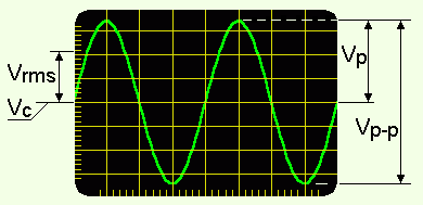

                                Hi Mrand,
                                Explain me, please, voltage across TX coil. What means notation " 7.8Vp":
                                a) Amplitude (peak) as shown with Vp in the figure below,
                                b) Swing (peak-to-peak) as shown with Vp-p below, or
                                c) Vrms measured with an AC voltmeter.
                                How is DC voltage supplying the oscillator (Q101)?
