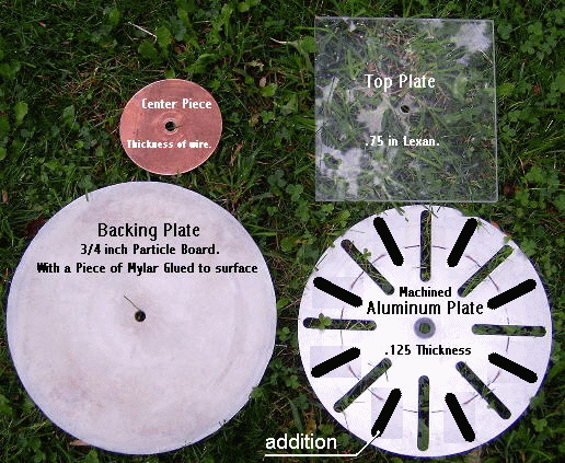

Hi, is there a right approach to winding spiral coils. In my winding, there's an area where the wire entering the winding overlaps with the spiral body. And I can't figure out a way to make the wire not overlap the spiral body. 1) is this area a problem? won't the detector constantly be set off since it's metal wire. and this over lapping area is in the coils field of view?
2) whats the proper way of winding spiral coils?
3) are spiral coils that take up the whole coil diameter deeper and sensitive, than traditional "ring" coils? My Minelab sucks when it comes to the really small gold, so I'm trying to know if spiral coils are the way to go. I'm hoping to get at least 9" depth for a BB size object.
By the way, I'm working on a 8 inch coil for my Mine lab SD 2100v2. using spiral coil calculator here, I was able to target a 310uH Inductance using 45 turns. I know I need to target .5 Ohms. Also, I'm using single threaded Tin plated 20 AWG copper wire. I couldn't find any teflon insulated wire so the insulation of this wire is PVC. The full specs of the wire are found here. I tried finding multi stranded tin plated wire but was not successfull at 20 AWG. I read that when making small coils you need tin plated stranded wire because the eddy webs are much stronger and therefore the coil much sensitive.
