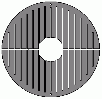

        After watching th[FONT=verdana,geneva,lucida,'lucida grande',arial,helvetica,sans-serif]is[/FONT] video I see my mistake. I tried a quick fix by enclosing the coil in some aluminum kitchen foil shielding and grounding the shield to the detector.
        Unfortunately, the detector was able to detect the shielding and all I got was a persistent hum. I'm going to try next conductive paint if I find any.
          Mario, try to cut alu foil as shown below
            I tried it. No luck
