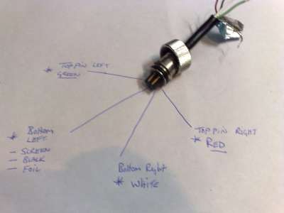

    I did get a Garrett Infinium LS power DD coil from a friend, however his dog chew of the connector. As of this I am looking for pinout.
    It have 4 wires
    Green
    White
    Black
    Red
    Thanks for your help

    Can you make some measurement on those wires (inductance and resistance)?
      Dont have a multimeter at this moment.
      however i did find this see
      http://www.geotech1.com/forums/showt...t=14582&page=2
      This garrett coil have the same wires color as the coil what I have.
      do you think that will be the same?
        Yes, good finding. This have to be Infinium DD coil:
        With resistor one is RX.
          Many thanks

              Two (or even more) coils can still be connected as mono (in spiral coil manner).
              On DD PI coil, you do not need damping resistor on TX, but on RX coil.
