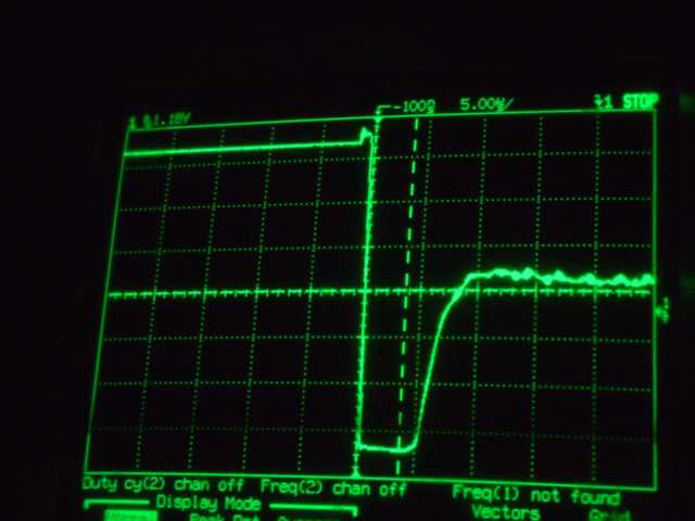

      For bench testing, immerse coil in water (adjust salinity) and observe opamp waveform, (dumping R adjusted before), if not changes, shield is good. If not intended for water, just check any capacitive effect, laying hand over coil etc must not produce response or change in waveform.

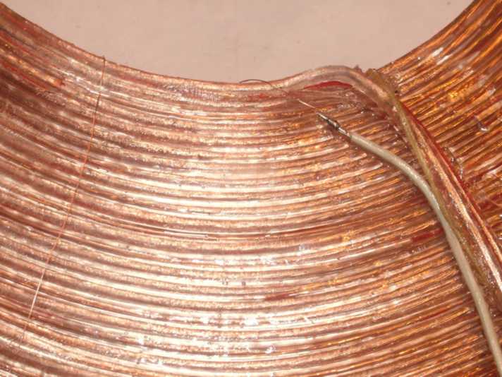

      This is one well proven and very good coil for typical PI like surf or Bara, I can recommend this to anyone building those detectors. Coil is 25cm, made of 2x.25mm PVC insulated wire (like speaker type), 2mm insulation, 12.5cm ID, (DVD spindle cover) 25 cm OD, 30 turns, wires in parallel. Shielding is either lazy man’s way, spray everything whit graphite, or, better, use sandwich made of two 4-5mm layers, cardboard and epoxy will do, im using rubber like 4mm laminate floor substrate. This is to reduce shield to coil capacitance.
      IMPORTANT 1 Connection is: outer side of coil and shield to GND, inner side to coax center conductor. Reversed, will be much slower.
      IMPORTANT 2 Build 25cm coil this way, 28 cm is fine, same recepy, 35 turns 14cmID, 28cm OD, but DON’T make smaller one, 20cm coil will be way out of specs for typical detectors (this on picture is 20cm, but built for something completely different). 2:1 ratio seems to work best.
      Whit 25cm version, inductance will be around 270uH, optimum dumping R 310-350R for unshielded or sandwiched coil, around 270R for simply shielded, depending on shield and detector type 10uS or faster sampling can be achieved. Excellent pinpointing and “discrimination” by ears. If you don’t have casing, make just “ears” and cable holder, then use epoxy/fiberglass (boat repair kit), one layer will do, to enclose it. Below is scope pic of coil response, but I cant remember exact detector configuration used (pulse widht, transistor type etc), should look somehing like this anyway.

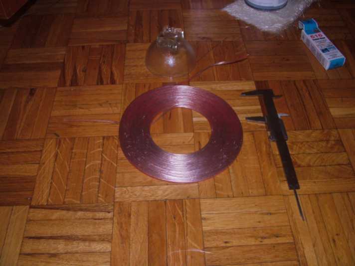

            Tepco great information thanks, one question
            you said 2x.25mm PVC insulated wire, but is it 2.5 mm wire ?
            in the picture the wire looks thicker than .25 mm
            cheers
              Wire is 2x .25mm sq (not dia) litz inside, having relatively high resistance ( 1.6R, both wires parallel, something like 20m ) but insulation is 2mm PVC, intentionally chosen to increase interwinding distance and reduce self-capacitance. Wire is “speaker type” with transparent insulation, like used in 5\1 or 7\1 home theatre wiring for low power speakers (but useless for actually connecting speakers), cheap and commonly available, just looks much thicker on images due to insulation.

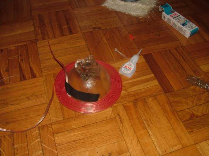

                          Tepco,
                          forgive me my ignorance, but what is the advantage of using 2 coils in parallel :

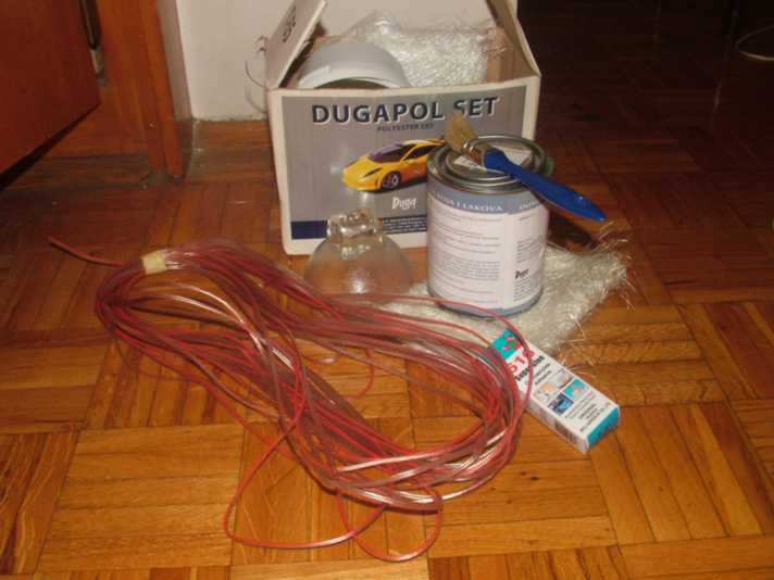

                          instead of a single coil of 15 turns -- cheaper -- less weight...
                          I can see the obvious advantages from your pictures, like it is easier to stick the windings together with some sort of super glue.
                          Any other advantages of using a "double" coil in parallel ?
                          Thanks for your information,
                          -- Bernard
                            You need certain number of turns (30) to get required inductance, but wire diameter is small (whit lot of insulation around) so both wires must be connected in parallel to keep resistance low enough.
                            You can have many advantages using this coil, two separate but magnetically strongly coupled coils, ideal for bipolar center taped drive, balanced, or two coils floated and driven with different voltage etc, just lovely for experiments.

                              I replay to PM publicly because this may be interested to someone else too.
                              For “sandwich” type coil, two sheets of material is placed above and below coil, shield is applied to this material from outer side in order do increase shield to coil spacing and reduce capacitance. I measured actual values some time ago, cant remember exactly, but almost 300pF is added if this “sandwich” is not used, graphite sprayed directly to the coil. Not dramatic, however, if coil is not shielded at all, may get like 8uS sampling, whit sandwich shield around 10, directly sprayed like 12-13, not lightning fast but good enough in most cases.
                              Whit typical detector design, MOSFET avalanche period and capacitance will limit sampling speed more than shield and coil self-capacitance itself, so there is no need to make something too complicated, you can try this coil completely unshielded, it is inherently very fast.
                              I never measured exact wire length needed, probably around 20m or so, obtain 25m, it is cheap anyway.
                              DUGA product is not the best and strongest resin, but just good enough for this, nice large and cheap package. Make some small-scale test first, resin is not too “energetic” in reaction, providing longer work time and very little heat during hardening period. (some other, more energetic types can screw up VLF coil balance due to excessive heat release, but not important for this)
                              In order to exploit full potential of this coil, detector must be properly adjusted, R dump value, and minimal sampling delay. Then this simple and cheap design can overperform about anything else, dual field included, in overall performance, i can even recommend this for factory made detector upgrade.
