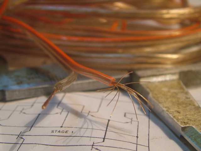

    I don't know of any litz wire that is "commonly available". Could you post a link to a source/spec? I see some on ebay and could order some from a wire specialist, but I don't know of a "common" variety anywhere. Is that clear insulation the same stuff that is on non-litz speaker wire?
    In this case, commonly available means cheapest and ubiquitous thing you can find on local flee market or everywhere. Very little Cu inside and lot of plastic around. Very low quality and cheap product, not good for anything else, but just fine for PI coils, no mfg. specifications available.
    It consists of 2x 14 individual .15mm dia. uninsulated wires (something between #34 or 35 AWG) giving total cross section of some .25mm sq. (or like #23 or 24 AWG, to hell whit imperial units) per wire, but this is not important. Main reason i’m using this is larger insulation diameter (around 2mm) to keep wires separated and reduce coil self-capacitance. Also very nice to work whit mechanically. Similar conductor to insulation diameter ratio can be found only in specialized, high voltage rated, more expensive and hard to obtain cables. I never actually measured insulation specs, just tried it as is and coil worked just fine.
      just to clarify then, it is common "speaker wire" as it doesn't look like litz from the photo...
        This is exactly same wire like posted in previous photos, (just may look different on pics, not exactly Hollywood production) may not be best for speakers, products of similar “quality” (this is almost junk but good for this purpose) may not be available everywhere.
        Regular “speaker” wire usually have larger cross-section conductors and less insulation around, but in this case, cheapest thing does the job.

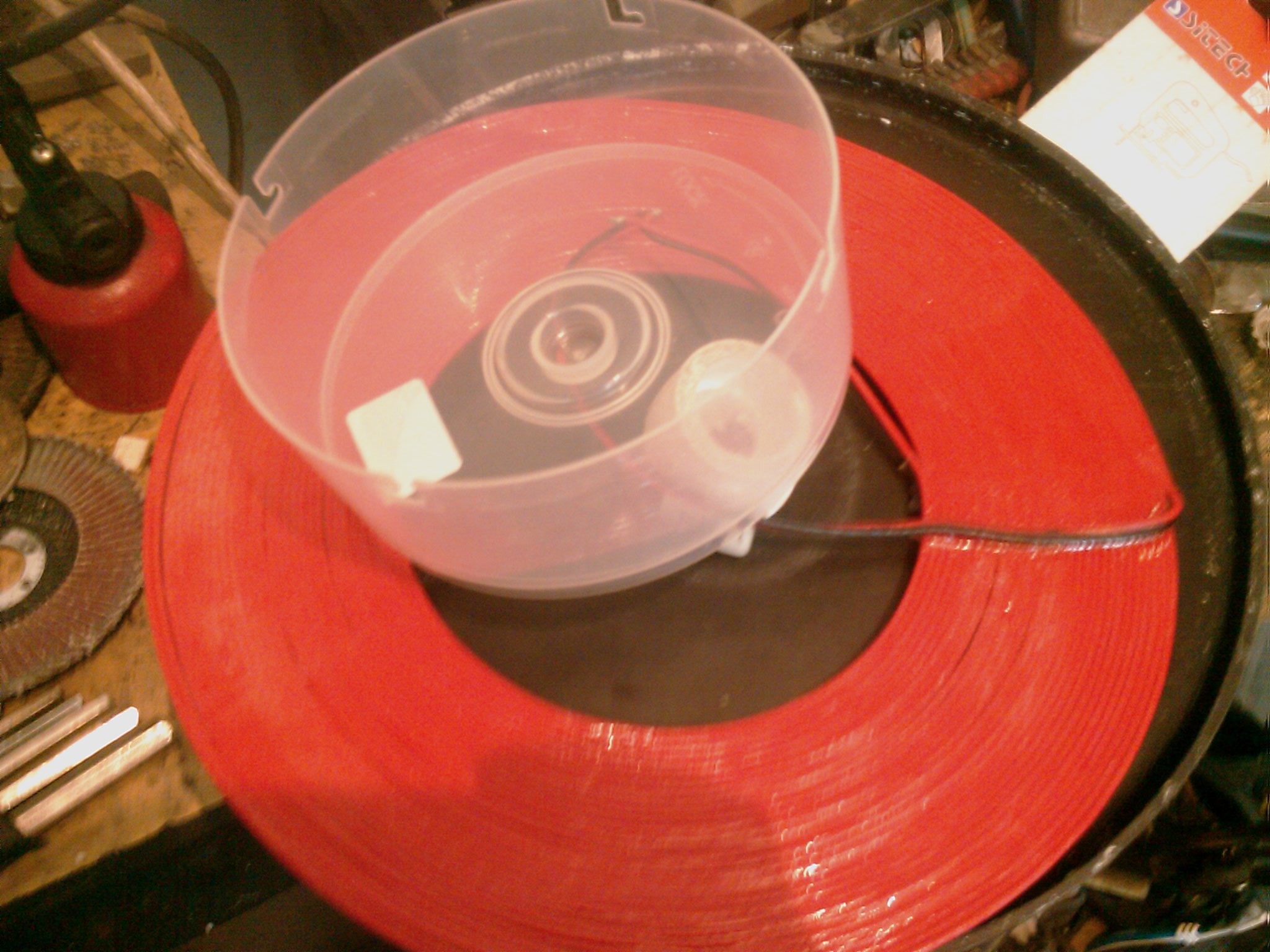

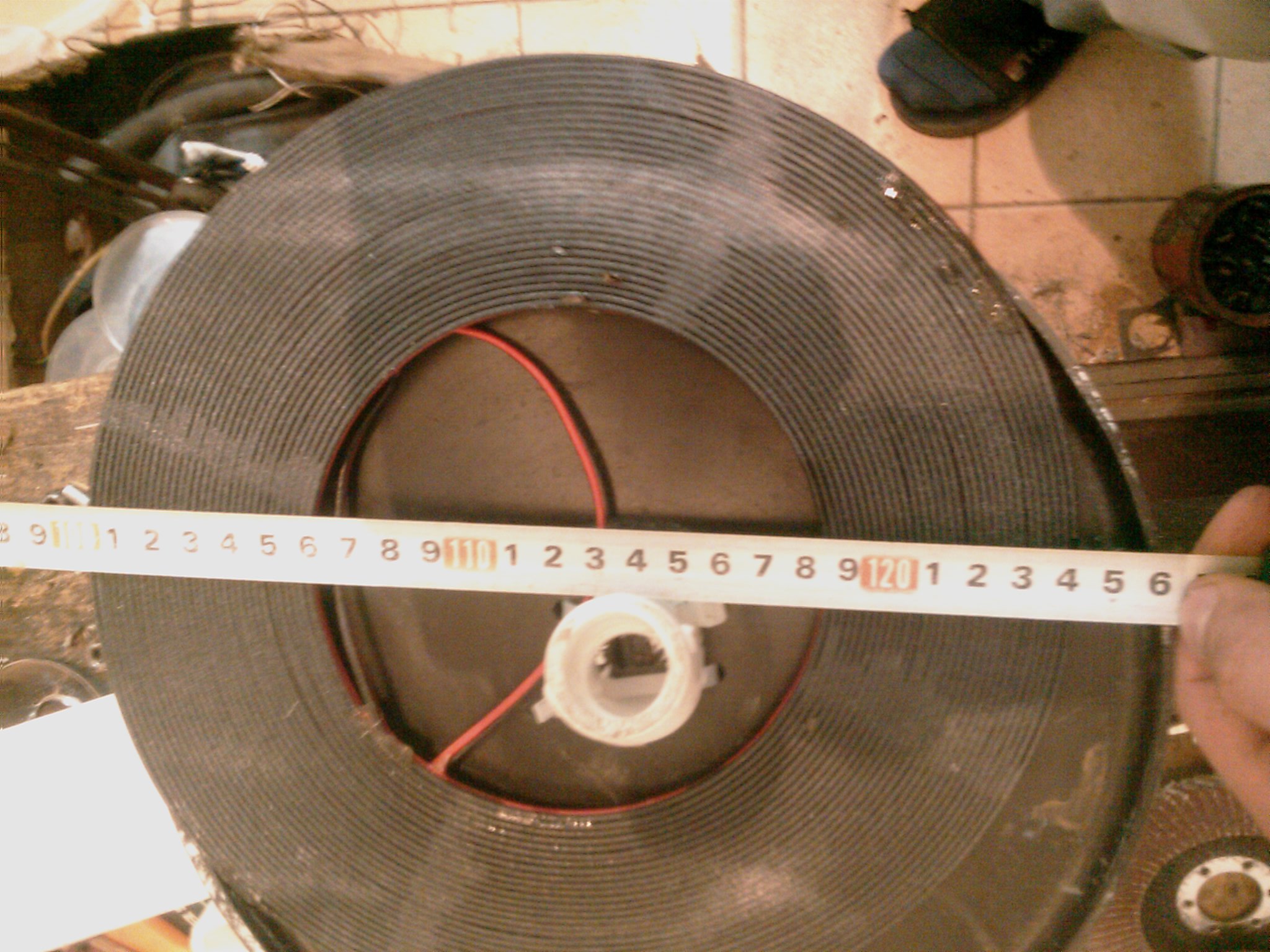

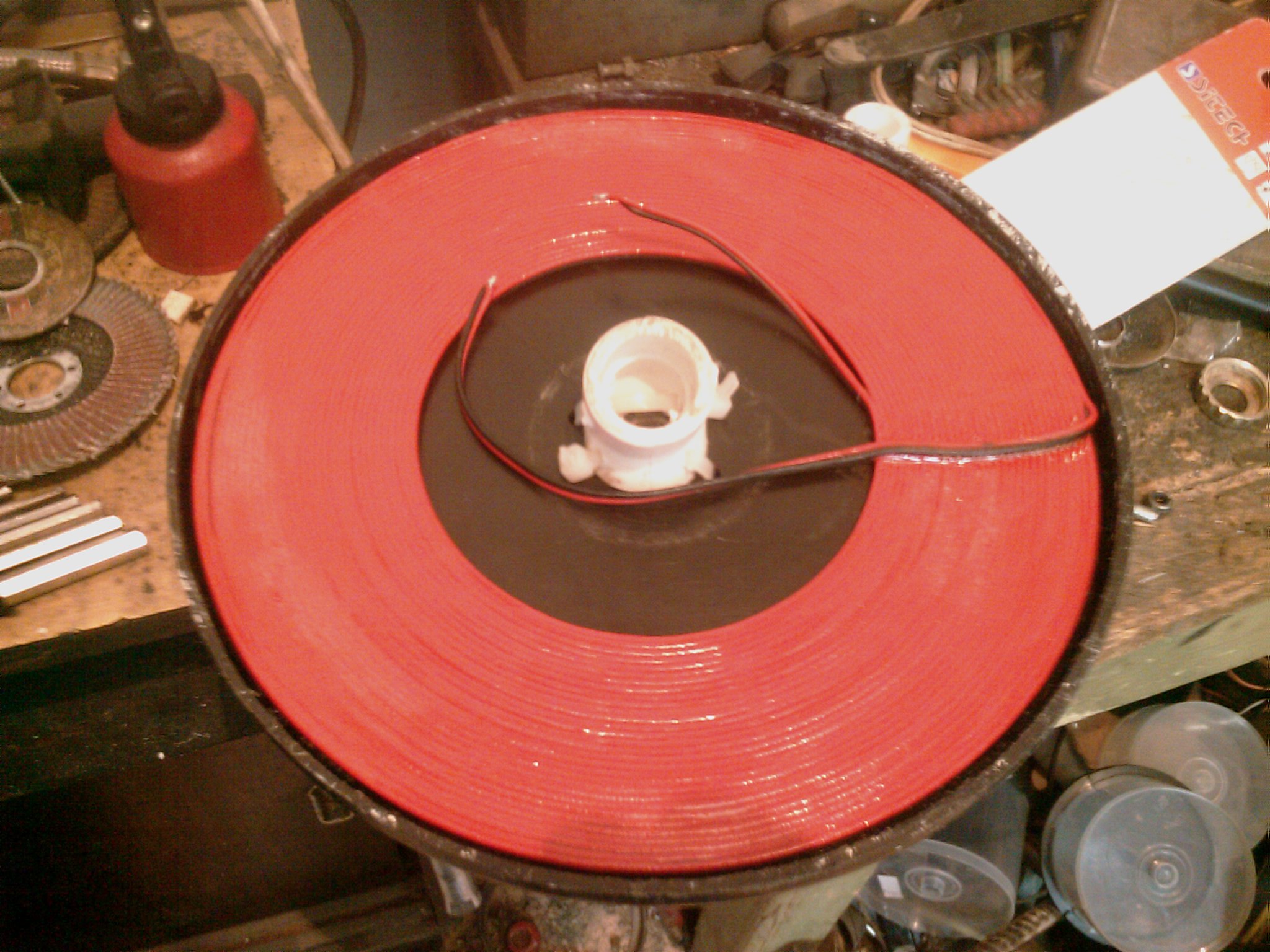

          I've made today coil with some 0.5 mm wire with insulation thickness 2mm, it took me some 18 meters of wire.
          Coil is coated with epoxy and for now unshielded, and on first test I got good detection so I'm pleased with results.
          I think is quite better than dual-field coil.
          Btw. the inside diameter is 12,5cm (DVD spindle cover) but outer diameter is 24 cm, probably because I wounded it damn tight.
          Tommorow i will play with some damping resistor value (it's bit tricky to do this without oscilloscope) and post results after.
          Regards Marko.

                      Correct me if I am wrong, but I think when he called it Litz wire
                      I think in this case he meant multi strand wire as shown in the picture.
                      Multi-stranded wire is exactly what it says - many strands of wire twisted together. This makes it more flexible and less liable to break than a single solid core.
                      Litz wire is not the same as multi-stranded. In Litz wire, each separate strand is insulated from the other strands, with the main purpose of reducing eddy currents in the wires at high frequencies.
                        This has been painful.
                          Sorry, my mistake, i messed up this wire issue, not intentionally, just wrong name for it.
                          This IS multistrand wire, i call it litz wire, just because local term for it is ”licna”, and not checked what i wrote.
                          Otherwise, making this type of coil on PCB is not recommended. Aside being more expensive and more difficult for DIY, PCB version will end up with excessive resistance, even double sided and using 70um Cu. Shielding problem still remain, so back to sq.1 again.
                          Coil is very lightweight, even with shield, epoxy and all in place, not much Cu in it, mostly plastic. Encapsulated in epoxy-fiber still one of lightest.

                              For this Tesla coil i first rubbed both covers with fine graphite powder and then sprayed with Graphite 33, for connection i used CU plate 0.5X0.5mm pulled out from PCB.
                              Coil it self is placed inside cover in sandwich with 2 layers of rubber insulation on both sides (because of coil to shield capacity) .
