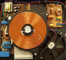

                As for cheap Litz, one source is Induction Hobs - often stripped from kitchen refits and given away. Ebay is good source, old stock or defective units..

                  Regarding the induction hob, what strands/awg is the wire used and how much is in one? A typical coil may need 90 feet. Also does the wire come off that without a problem? Sometimes mfr's glue the wires together and they won't come off without damage.

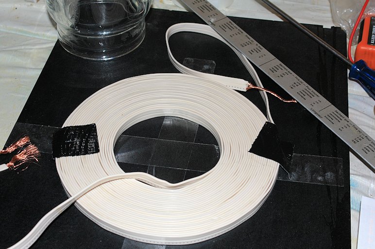

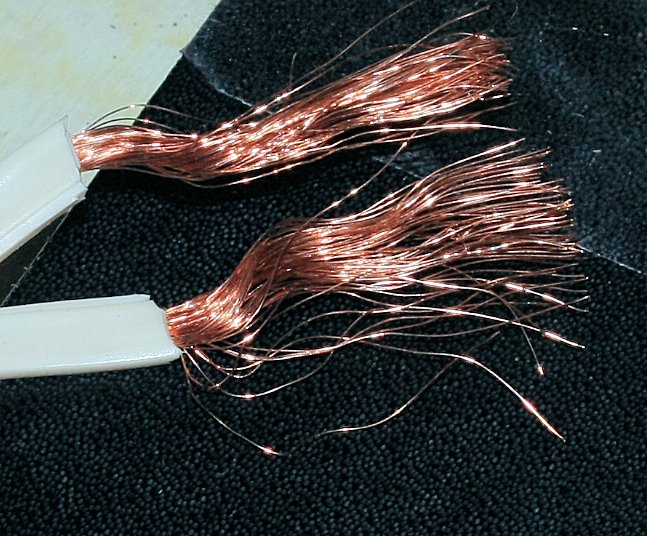

                      Unknown wire info sought
                      Whilst waiting for my Surf PI kit, thought I'd play around with the coil. This is not the wire I'll be using for the final coil, just wondering what different wire will do/look like. This I think is FM, or maybe some manner of computer wiring. I picked it up at a thrift store. The OD is 12mm x 2mm. There are four strands of fine wire (two to an end) each of which are approx. 4mm x .5mm (actual wire size - flat). The image shows one end split down centre. There are 27 winds, with an OD diameter of 22.7 cm. The insulation is very pliable, almost rubber-like. The wire is very slippery, so must have some manner of coating. It looks like pure copper with unknown clear coating. The stuff is like fuzzy hair and have no idea how many strands per line (in excess of 50?) The only markings on the package were: Part No. 32283 2/16 Gauge - 50FT. Any ideas? My multimeter gives a resistance reading of 0.1
                      • #41
                        I think I saw this wire at a Local HI FI shop. They recommend as speaker wire.
                        Henrik
                        • #42
                          Thanks. If it works will be pretty heavy! However, would overcome buoyancy problem and work well in water. That is, if these old arms could stand the resistance for an hour or so!!

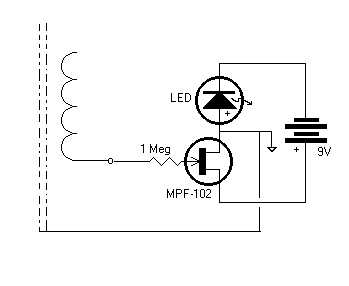

                            Here is a video to go with the simple circuit posted earlier in the thread. This is just testing the effectiveness of carbon graphite on paper.
                            http://www.youtube.com/watch?v=CiCRF_Bch1k.
                                I've watched this several times and just can't visually/mentally grasp it. The led is not aimed at the camera so I can't tell the difference between when it may be on or off or in a shadow or not....
                                Unless the series resistance of the fet is really crappy I would think this circuit needs a current limiting resistor for the led.
                                If this is proving that rf energy is building on the fet input enough to bias it on, would ferrite beads on the cable junction (discussed in the patent thread) have the effect of eliminating the rf?
