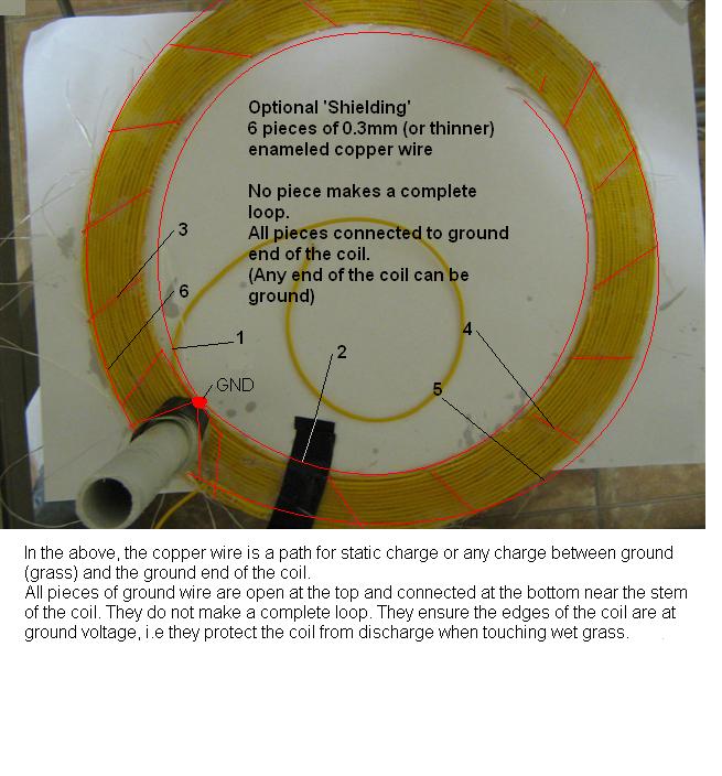

          As I understand it, 6666 is talking about using only the drain wire (without either a graphite or "wrap-around" shield). This thin wire is sufficient to provide shielding on its own. The question is: "What is the maximum spacing you can get away with before it becomes ineffective?".
          • #80
            Yes only the drain wire, in this picture is a description, the winding are sparse already.
            I dont know the answer to the question : "What is the maximum spacing you can get away with before it becomes ineffective?".

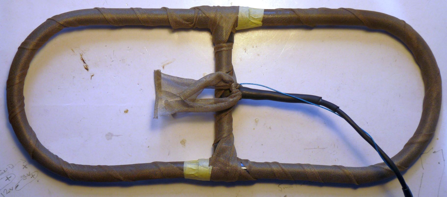

                    • #85

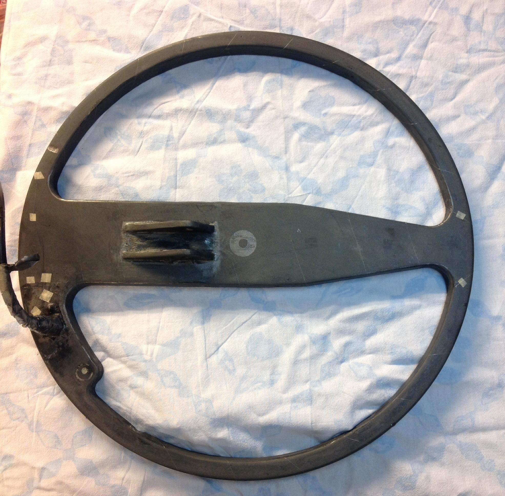

                      I find this thread a highly interesting read. Especially since I'm dealing with PI shielding right now.
                      Am now using silver coated polyester mesh-cloth spiral wound around coil as my MPP squealed when getting near the ground outside -it started at 2 feet-
                      Indoor tests are good so far, no appreciable loss of sensitivity, will be testing for real outside the next days.
                      The SRF drops by about 3.5% with the shield.
                      Cable with plug, coil and shield comes in at around 591 kHz now.
                        Is it working for you ?
                        • #87
                          Can't say for real outside yet - weather is still crappy. Should be better in a few days.

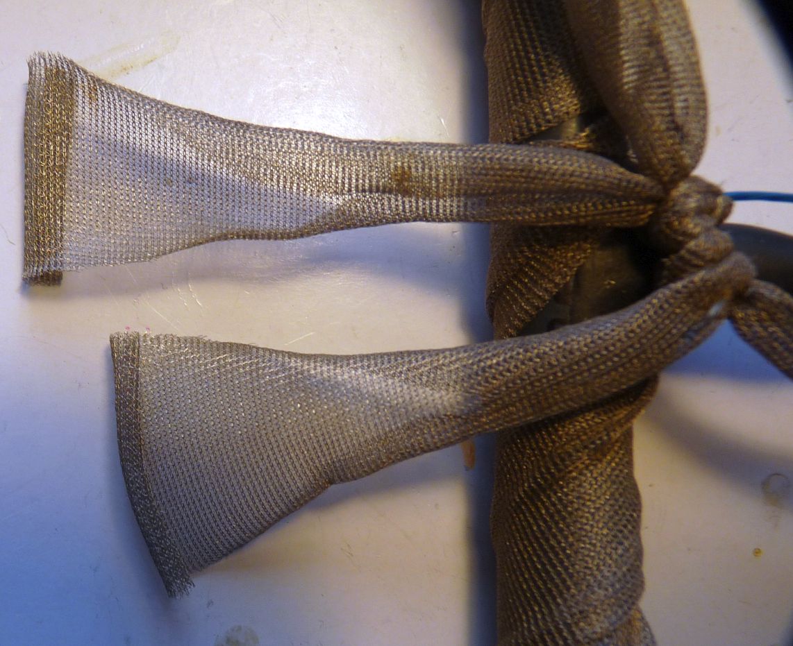

                          The material likes curling up at the edges, so I wound it with thick edges anyway to see if it had any detrimental loop effects.
                          There are none that I can see with the inside tests. Trying to wind it cleanly is much more work.
                          In case you're wondering why the shield is on the outside, well, I thought (hoped) I wouldn't need one.
                          I found the information about shielding I have read quite ambiguous. Well, now I know. Alas, I definitely need one.
                          So I did this quick job to see if it is a viable option, without having to get into the graphite paint business
                          and having to wait for stuff to arrive. The two spots with masking tape are the gaps. They are narrower underneath.
                          Three pics:
                          • #88
                            @6666
                            Have tested outside for 2 hrs. now, many people around with cell phones.
                            Results are good for me. No interference to be heard. Waaay better than before.
                            I only get a slight change in threshold when lowering coil from 2ft to ground now.
                            The SAT takes care of that.
                            Waving it in the air with abrupt stops and direction changes is also not to be heard.
                            So earth field cancellation also works fine.
                            Dug up all kinds of small and big stuff.
                            • #89
                              Thats a good result, glad it is working for you
