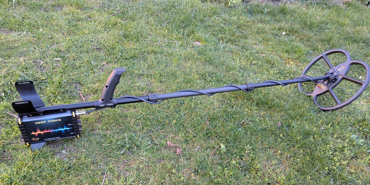

Deep Force by Mikron Bulgaria - A new PTS Hybrid 2025
  • Deep Force by Mikron Bulgaria - A new PTS Hybrid 2025
    See
    Deep Force discrimination in the ground
    ​https://www.youtube.com/watch?v=L5C9TdyorsM
Name:	Mikron Deep Force.jpg
    This Deep Force is The Next second Hybrid model Deep Seek relics Metaldetektor over 40 centimeters deep manifactured by Mikron Bulgaria in 2025. Working with new PTS Technology principle trade secret of the company Мiкron Bulgaria
    for First PTS Hybrid model AKA Smart Pulse https://www.youtube.com/@Mikronbg/videos
    arleady discused here https://www.geotech1.com/forums/foru...ka-smart-pulse
    Last edited by Hristo; 12-13-2025, 04:56 AM. Reason: "As long as there are cattle, there will be butchers" - Prof. Bradistilov
    DEEP FORCE CONTROLS
    SENS
    DISC (mechanicaly combined dual pot with IRON BIAS function to save space on Panel and ease intuitive tuning) demo how it works on free by manifacturer upgraded first model AKA Smart Pulse - with this new cool feature https://www.youtube.com/watch?v=5o49qV_T-IE
    GND BAL
    THRESHOLD
    ON/VOL.
    CHARGE
    PHONES
    RELIC / COINS
    PTS hybrid metal detector​
    These hybrid designs are designed to be mainly relic machines, where the main goal is maximum depth. Then discrimination, and lastly sensitivity to very small targets. It is not impossible to do, but a lot of things have to change, it is not just a matter of changing the timings, as is the case with GPX. The result will be a completely different scheme.

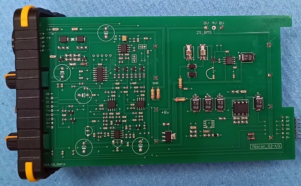

    The PCB look inside box:
    Click image for larger version  Name:	IMG-20250905-213434-630-2.jpg Views:	0 Size:	248.3 KB ID:	443521
          Can I see more photos? On the other side of the board.
            The circuit board's trace layout doesn't look professionally made. It looks like it came straight from an autorouter software. JCLPCB manufacturer your PCB based on the data what you provide. They will not tell you whether your PCB layout is good or not.

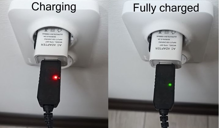

                    Click image for larger version  Name:	PXL-20260408-144444473.jpg Views:	0 Size:	418.7 KB ID:	446890
                      The Battery Charger included with the REX DeepForce is simple look like a ordinary USB cable that can be plugged into phone chargers, power banks, solar MPPT controller chargers with USB typeA ports for charging, e.t.c power sources 5V/0,5A. Stefan (CEO Mikron) mentioned that the built in LiIon battery is 7 amps (8.4V), and for me the charge was about 5 hours. This time will obviously vary depending on what charger is used, it's not bad to keep in mind?
                      "The charging time will not be shortened, no matter how powerful the adapter is connected. It is slower, but it is a fairly universal solution, because you can use any USB for charging - a network adapter, a computer, a laptop, a solar panel, a 12V adapter from a car cigarette lighter, and also a Power bank, with which, by the way, it can continue to work even after the battery is completely discharged.
                      The Smart Pulse kit also includes such chargers, only the first 20 or so were initially equipped with 220V chargers
                      It often happens that after someone has received the detector, they call and ask where the charger is, thinking that it is just a connecting cable. The 5V-> 8.4V converter, as well as the automation, are inside the USB connector. While charging, it lights up red, and when fully charged, it lights up green and stops charging.​" - Mikron answer.
                      LiIon Battery Charger specifications:
                      USB TypeA connector
                      Imax=0,5А
                      LED dual color indikator

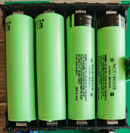

                          Hi Hristo,
                          If the cells are PANASONIC MH12210 type (as viewing on the picture), the capacity is 2.9AHs (according the datasheet) and if the power supply DC source is 5V 0.5A (popular cheap USB charge AC/DC charger), and if the second additional DC/DC adapter haves 100% efficiency, the time for full charge of all 4 pcs LiPo accus have to be 2.9AHs/0.125A = 23.2hours. It is too much time to charge if you want to use the unit for the next day. The optimum solution of the power supply is one of the hardest task in every electronic unit. In this case, the more good solution is to use 24V AC/DC adapter for charge these 4pcs. LiPo accus in reasonable time with according charge solution.
                            Thank you. It would be interesting to see a photo of the board itself, under the batteries.

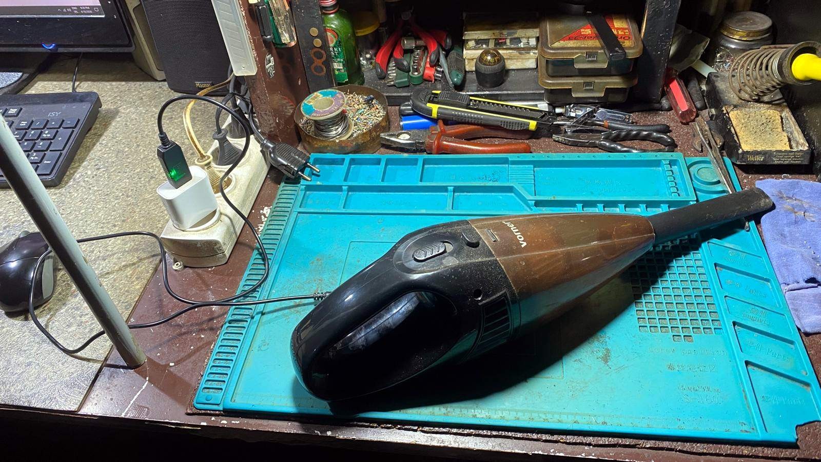

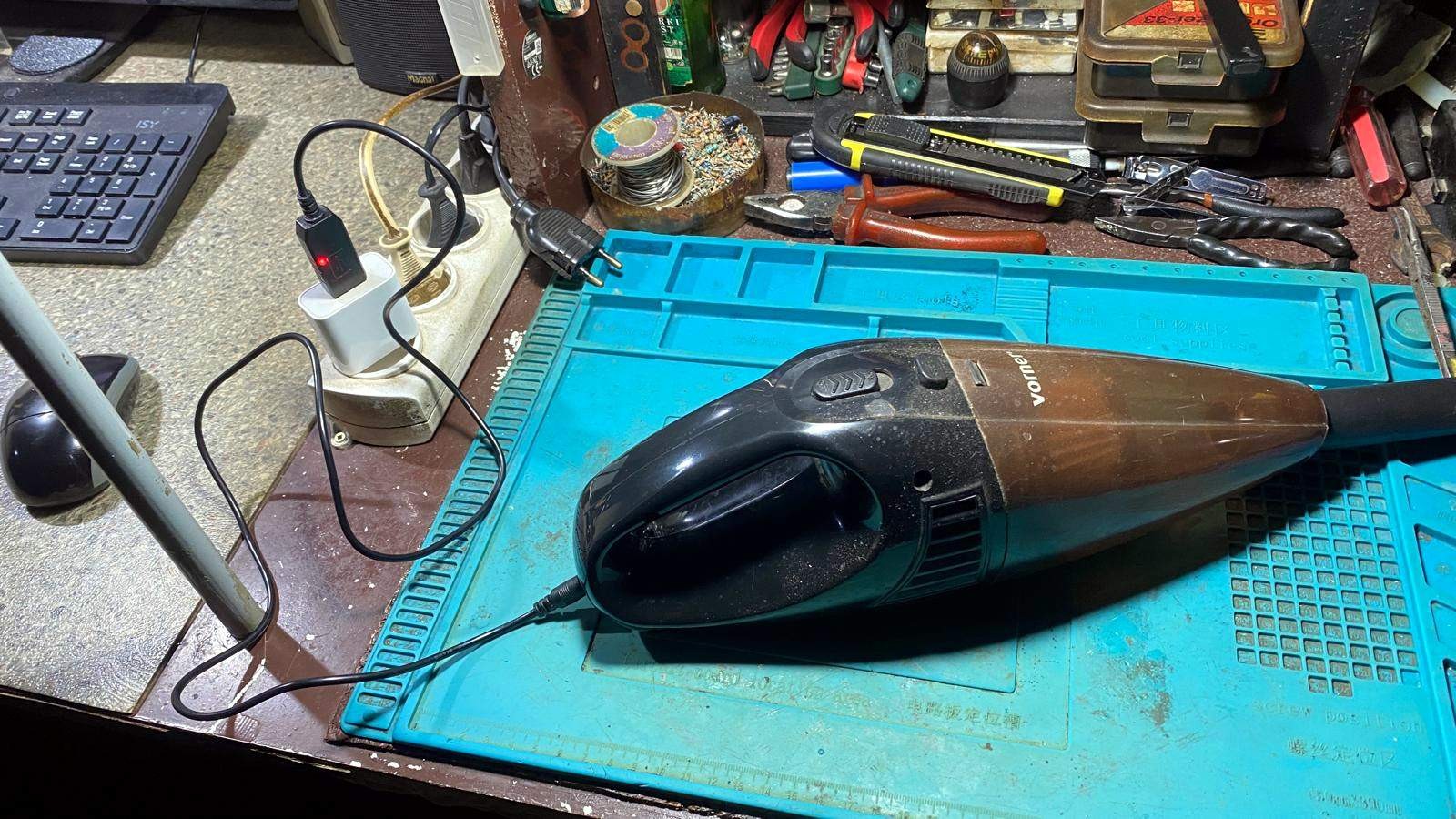

                              I have the very same charger for handheld vaccum cleaner (~$10 whole package):
                              Click image for larger version  Name:	image.png Views:	0 Size:	450.3 KB ID:	447225Click image for larger version
