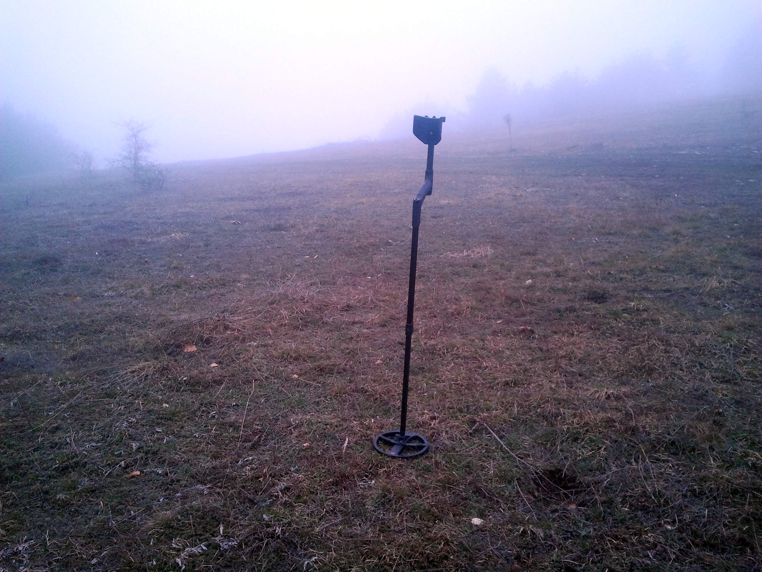

        • In the mist...

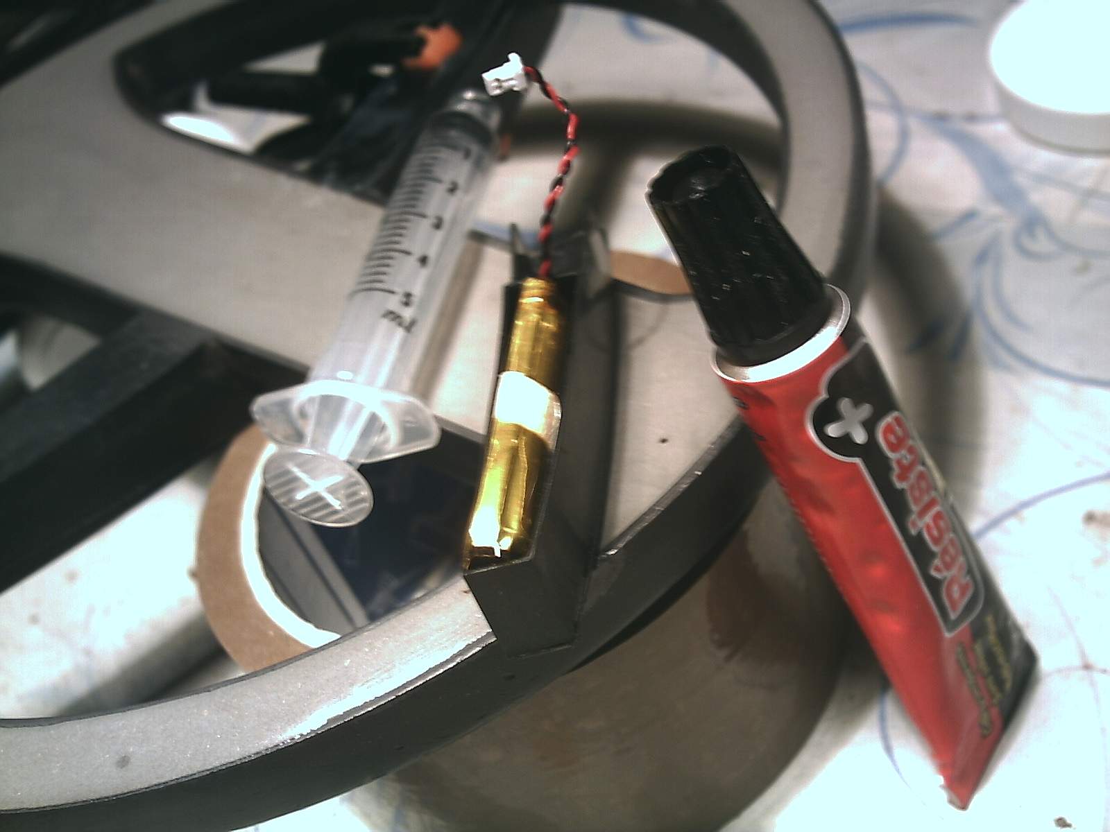

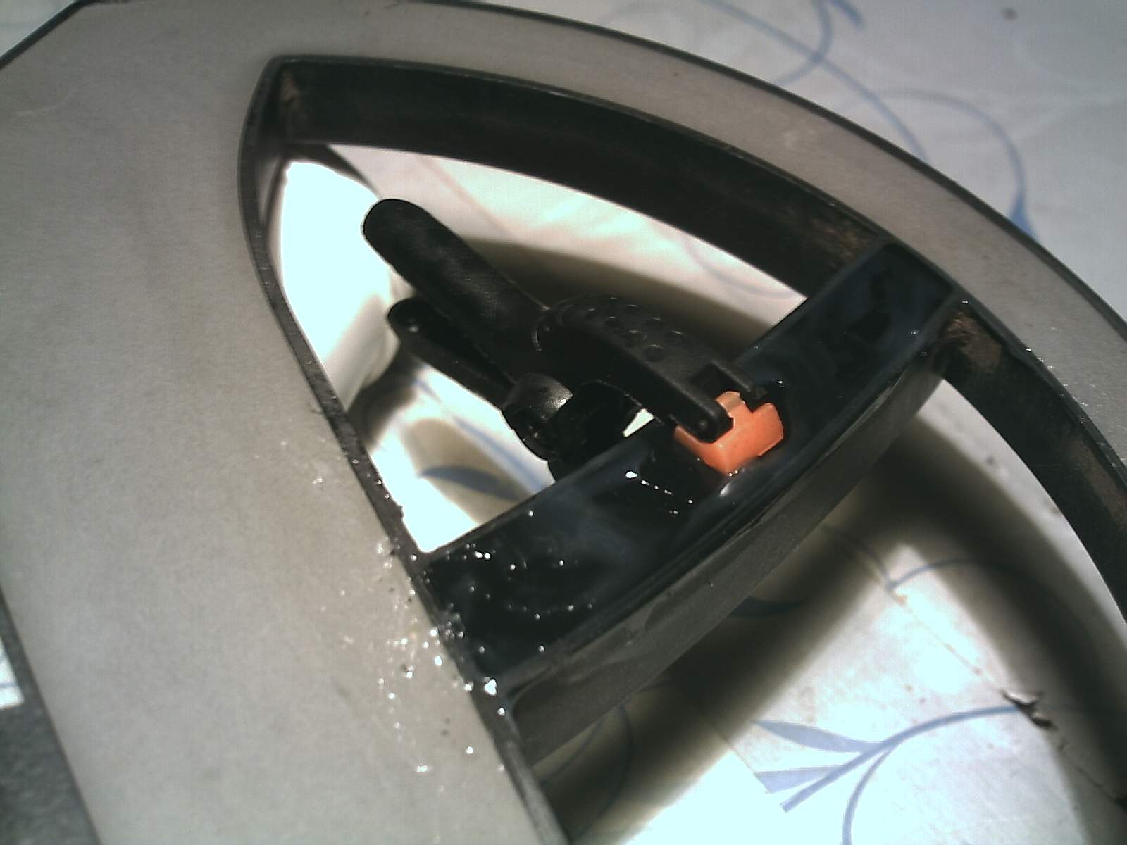

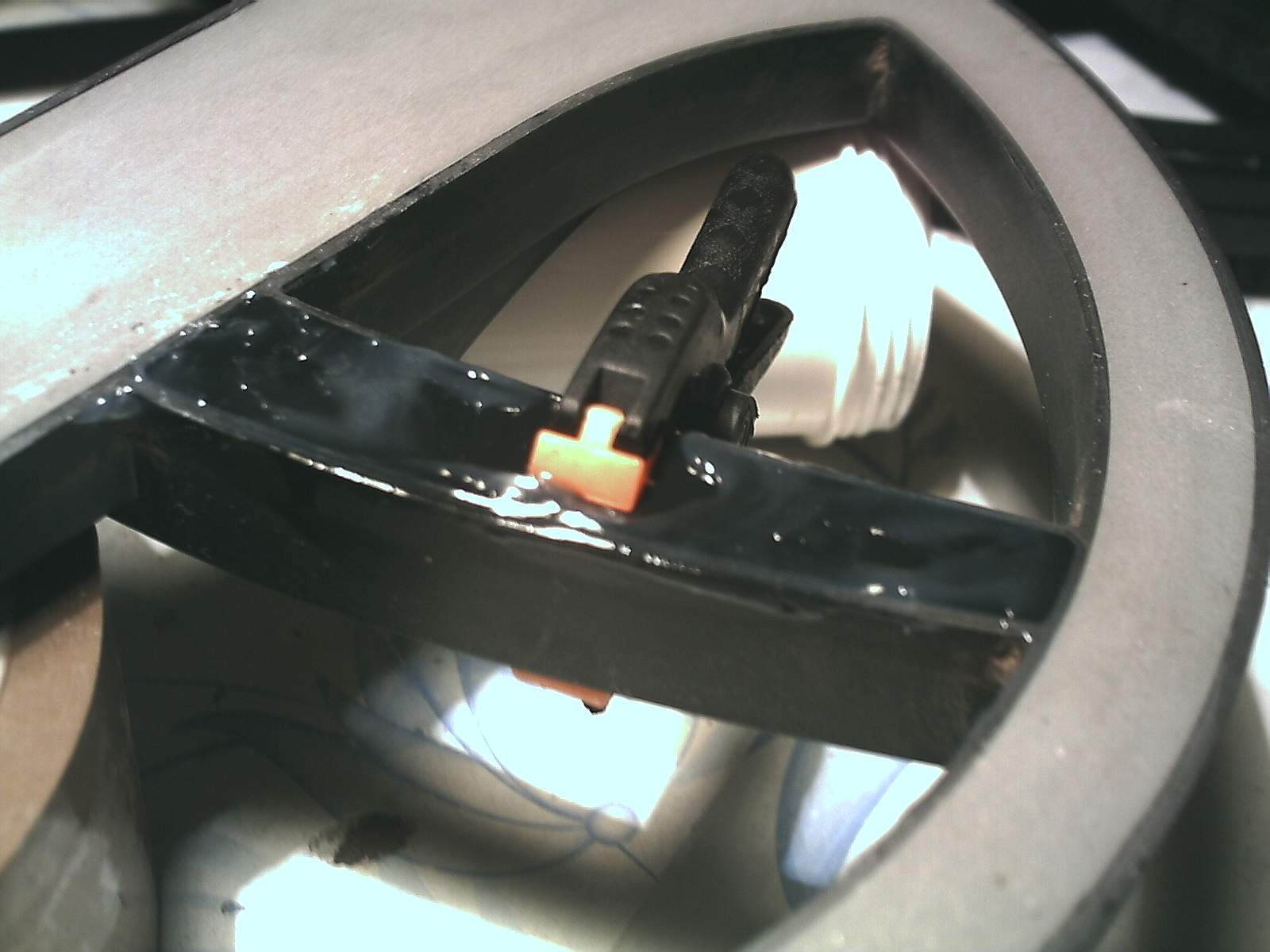

                        Seems you are not following some already posted and explained things here on these forums... or you keep forgetting all the time.
                        My batteries, at my two coils; are still in perfect shape, after 4 years and so.
                        But also i have been replaced batteries for other people at their coils, for several times so far.
                        Nothing is easier. Very simple and fast operation.
                        Yet one small "problem" still exist; obtaining original battery replacement set is sometimes a bit time consuming.
                        It takes several days to obtain set from supplier.
                        That's why i searched for faster solution, some batteries for lately popular quadcopters&drones are 100% suitable, and cheaper from originals.
                        So; there is no actually a problem with Deus batteries at all.

                          • As long as you and the XP company still exists everything
                            will be fine for the Deus users!
                            Really, you do a great job here and I'm glad if
                            the original accus lasts more than 3-4 years.
                            Perhaps 2-3 years more. Interesting pix.
                            But the best solution would be Li-Po cells in
                            all kind of sizes which can be inserted into
                            devices like those for ultra-bright LED-lamps.
                            Very simple, no soldering and as if these would be normal batteries.

                              Deus coil is having pretty limited space for larger batteries.
                              Yet i founded two LiPo battery models designed and sold for drones to fit perfectly into Deus coil.
                              This is the "problem" for each 4 to 5 years to solve... not a big deal.
                              Battery is not soldered inside, it has standard plastic connector.
                              All you have to do is to open small compartment and replace battery.
                              Later use silicone to glue cover and that's about all.
                              Than after 4 to 5 years do that again...
