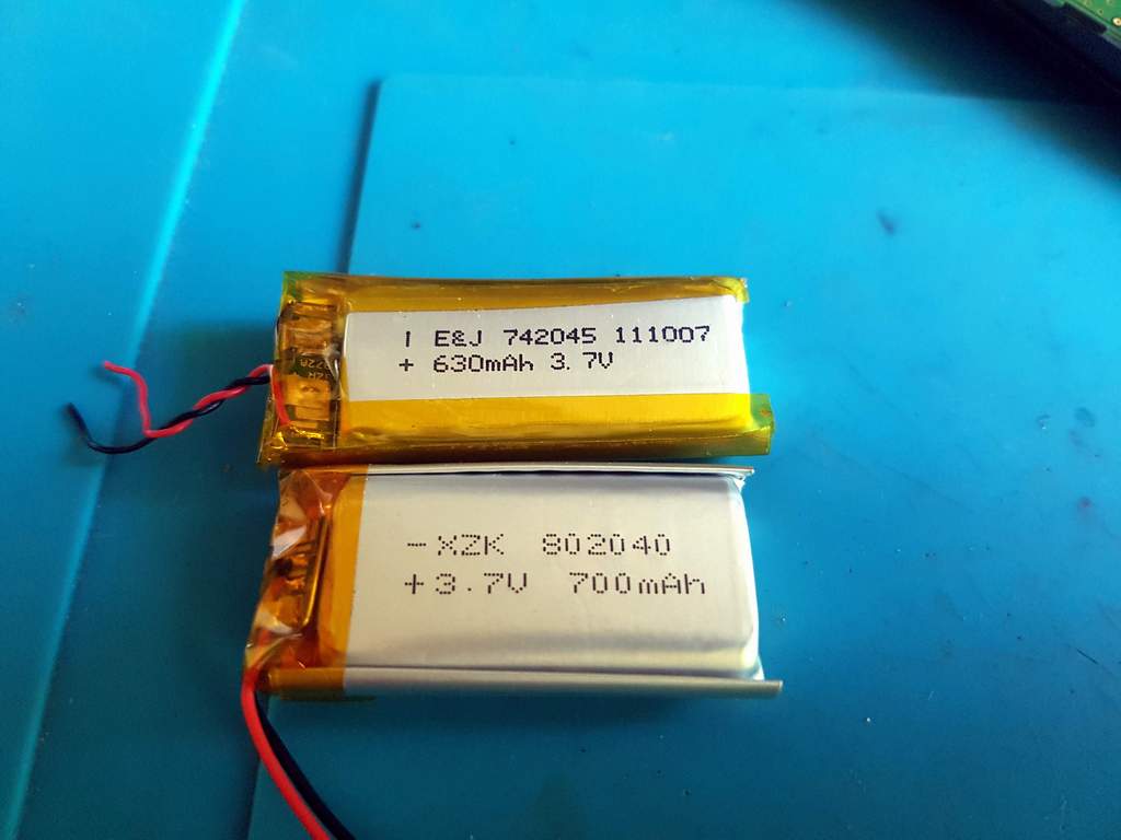

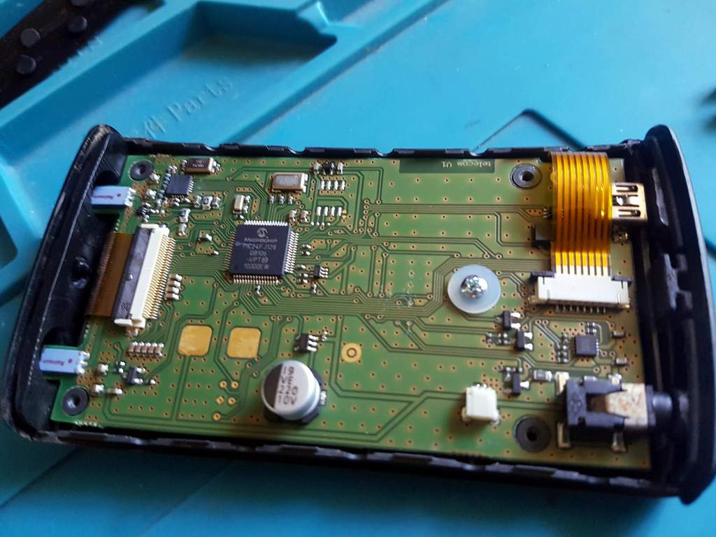

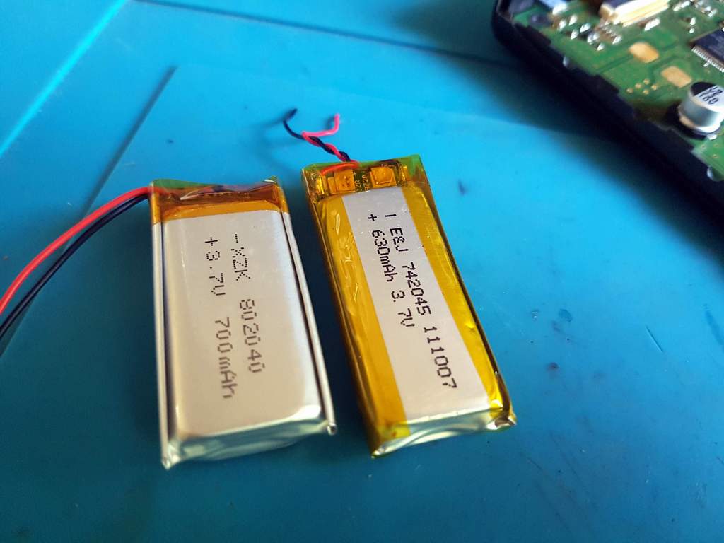

                            • Finally, after 10 years (and a few months more); I decided to replace the batteries on the Deus, on the remote and on the coil.
                              This is the first time (I know it sounds unbelievable, when it comes to me) that I opened my remote and coil!
                              Because... in the meantime, I changed the batteries for others, so I've already seen the inside, that's the only reason.
                              The batteries were supplied to me by a friend on Aliexpress. At a good price.
                              The "original" replacement set is 50e !!! For one battery!!! So that's the main reason I've been putting this off.
                              Such prices are an insult to intelligence.
                              And these batteries from Ali are 10x cheaper.
                              The original batteries didn't completely fail, they could still be used, so I put them aside and will keep them.

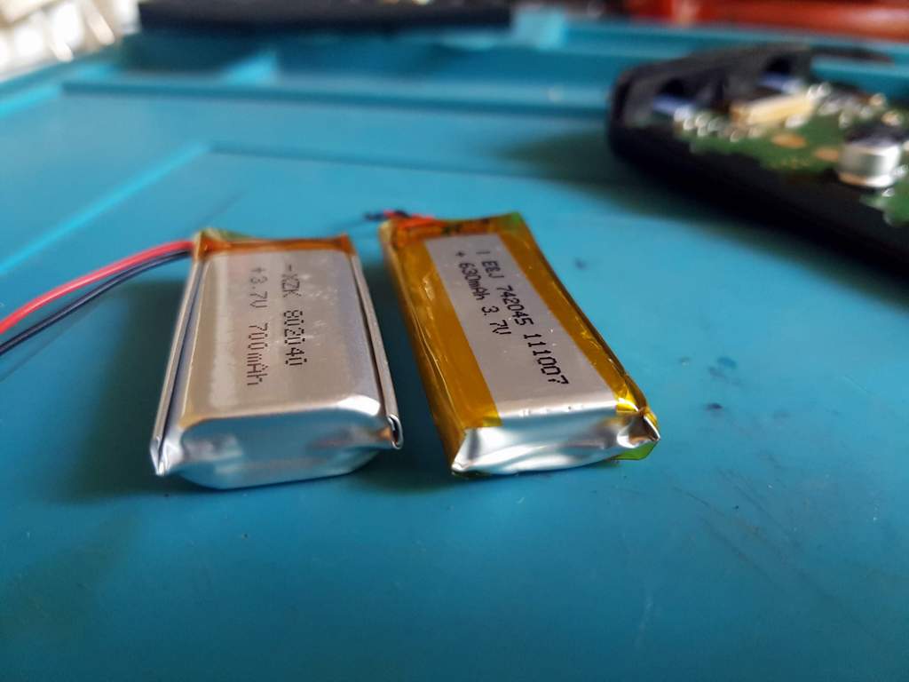

                              When I opened the coil to take out the old battery, I smelled a characteristic smell, the kind Lipo batteries emit when the casing is punctured or cut.
                              And it seems to me that that battery is very slightly inflated. In the end; it also showed a decrease in capacity, while the battery in the remote still did not.
                              Still... 10 full years! A rare case indeed.
                              I think the main "formula for success" is that I never put away the detector and the coil without first putting both on the charger and charging the batteries to the end.
                              Always after returning from the field.
                              And when I don't often go to the field, I regularly recharge the batteries every 20 days.
                              This type of Lipo battery seems to require constant attention and "tension".
                              Another possible reason may be that Deus does not "pull" the current suddenly, but consumes it constantly and evenly at the same pace.
                              And there is one more thing, never in these 10 years have I changed the TX power. It is always at the default value.
                              These are all just assumptions, maybe not all of them are true. But it is worth mentioning.
