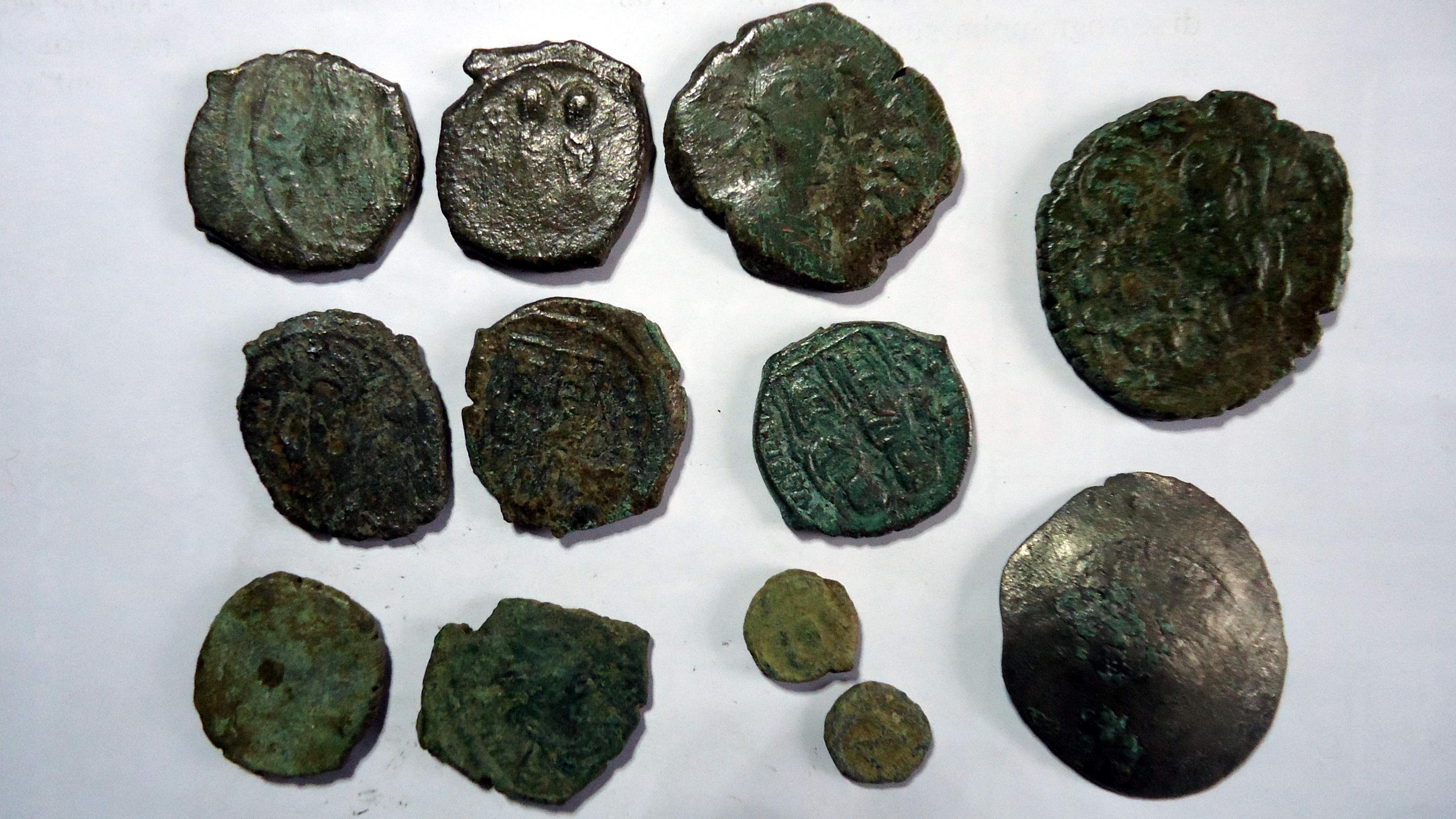

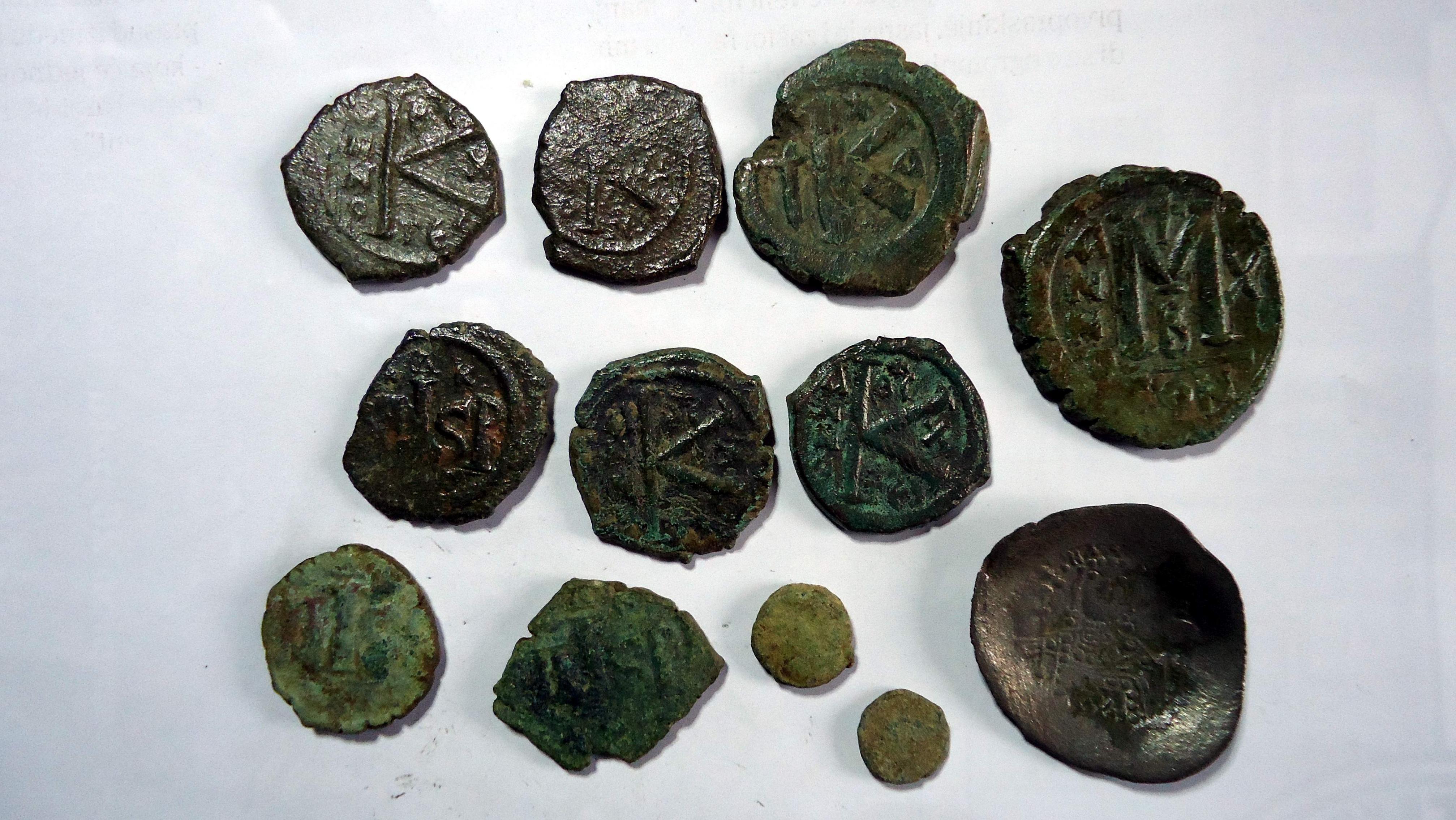

    nice coins! what age they have>?
    VI century, Justin and Justinian.
    Lot of sites here from that period.
    http://www.forumancientcoins.com/cat...s.asp?vpar=886
    http://www.apmex.com/product/94862/b...7-ad-ch-au-ngc
    • Later on, washed a bit in water:
