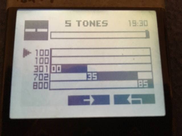

    • it doesn't says nothing about improving big iron and deep rusty targets sounds you know what i'm saying )
      and the pic from earlier post:
        [ATTACH]39164[/ATTACH]

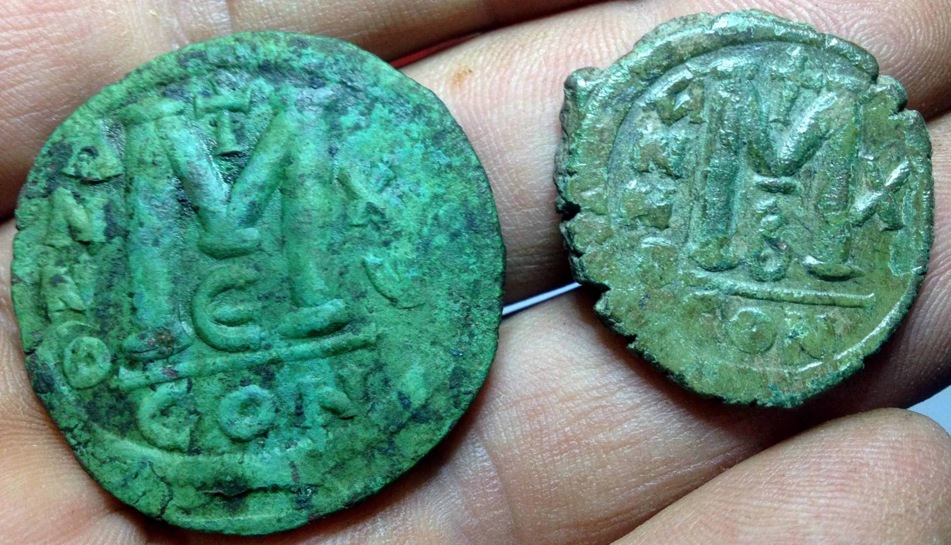

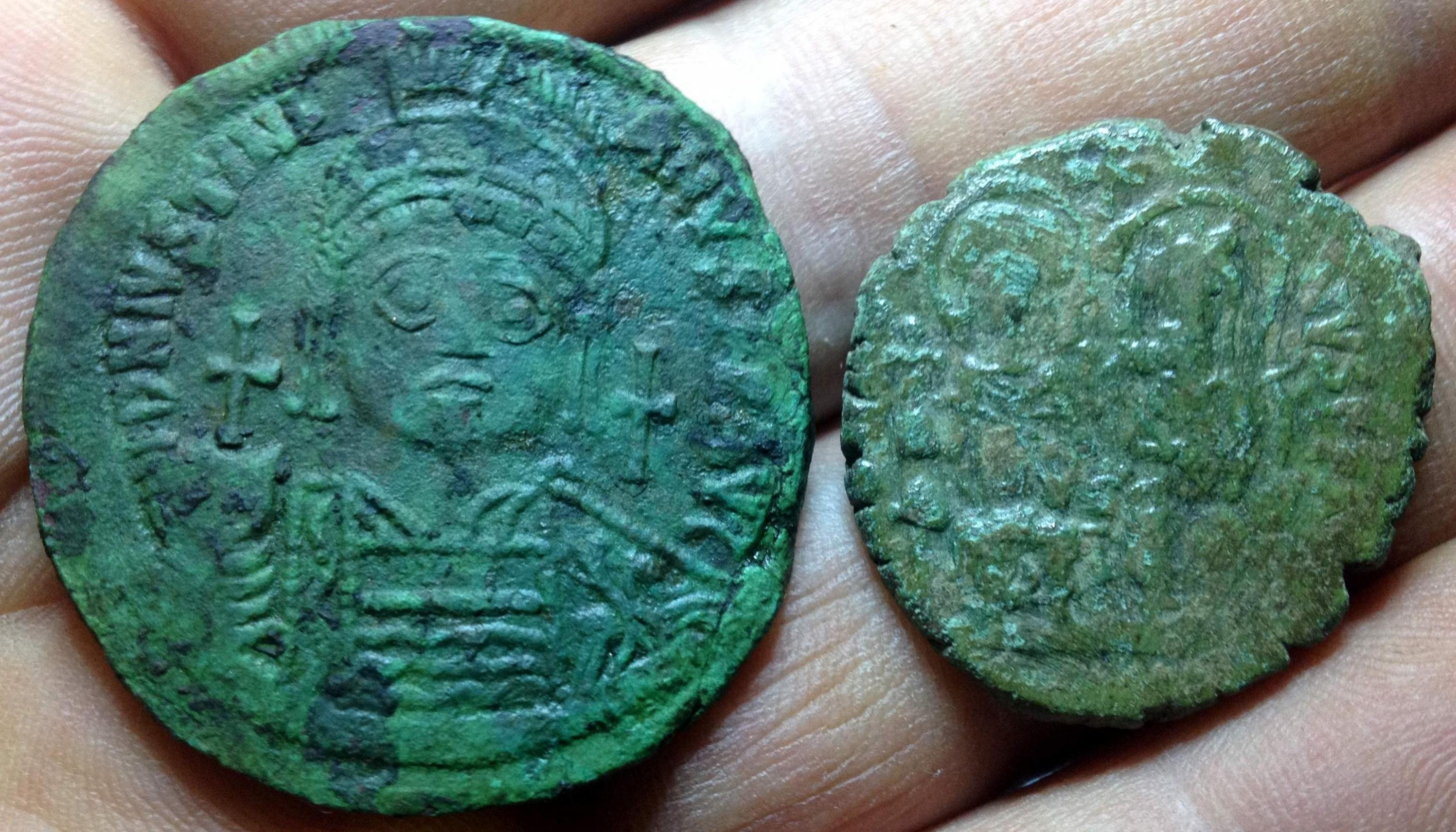

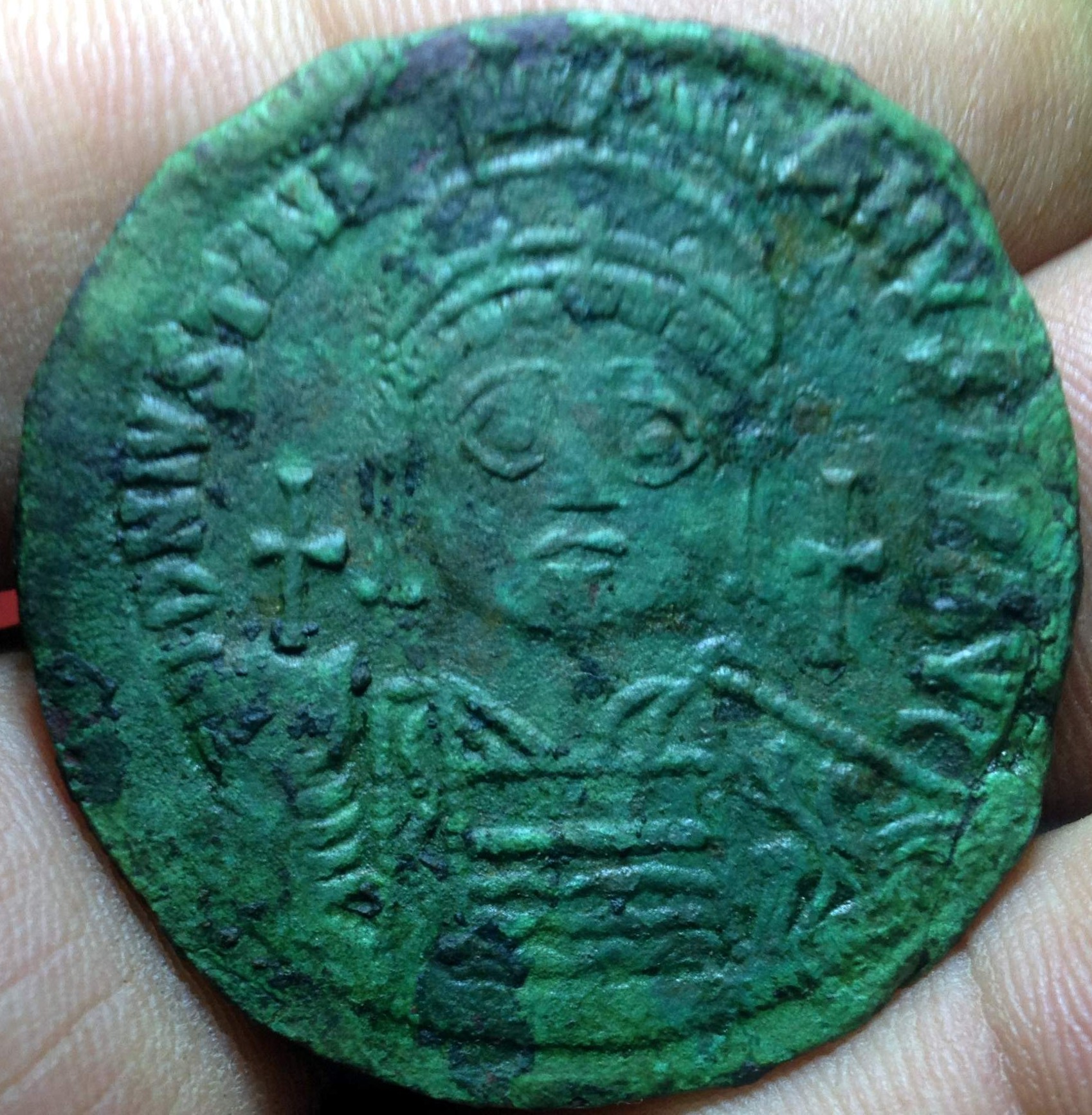

            • Today i went out and visited the same site from the other day, same where i discovered gold coin.
              I deliberately wanted to go there and compare behavior of V3.2 with V4 and it's new features.
              I made 2 programs explained on Youtube video from my previous posts.
              I named them "Iron3T" (3 tone) and "Iron4T" (4 tone).
              But unlike on video i lowered frequency to 12kHz on both, also adjusted Silencer on "2".
              So when i first walked inside the site it was "baddabooom ... brooom ... brooom..." all over the place!
              Constantly on each step! Deus... the machine gun!
              Ok. 5 minutes later i adjusted Disc from previously -6.4 to -4.7 and all of the sudden it became much calmer.
              Because at -4.7 there is no more ceramics.
              That site is pretty much exhausted, no more finds... UNTIL i got very strong and "fat" audio with side-chatters and VDI = 99 !!!
              "A large iron" you may think, so was i. Deus was on "Iron3T".
              Than i switched it on "Iron4T" and "fat" audio changed to "brooom ... brooom... blurrrp..."! Ha!
              Logically, because guy from video designated VDI99 with 120 pitch.
              Than i switched it back again on "Iron3T" and i started "shoveling" around.
              You may not believe... but approximately between 35cm and 40cm deep; i discovered probably the nicest and largest coin in last 4-5 years!
              I took a photo of it along with the same kind of coin that i discovered the other day; just to illustrate the sizes and differences:
              • It is a coin that large; you can kill a horse with it, if you throw it!
