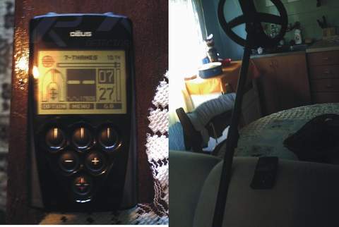

    • #62
      Aha; i used 7. place in program memory.
      Previous "Wet Beach" adjustments i find as least beneficial for me here.
      Also named it "Thames" !
