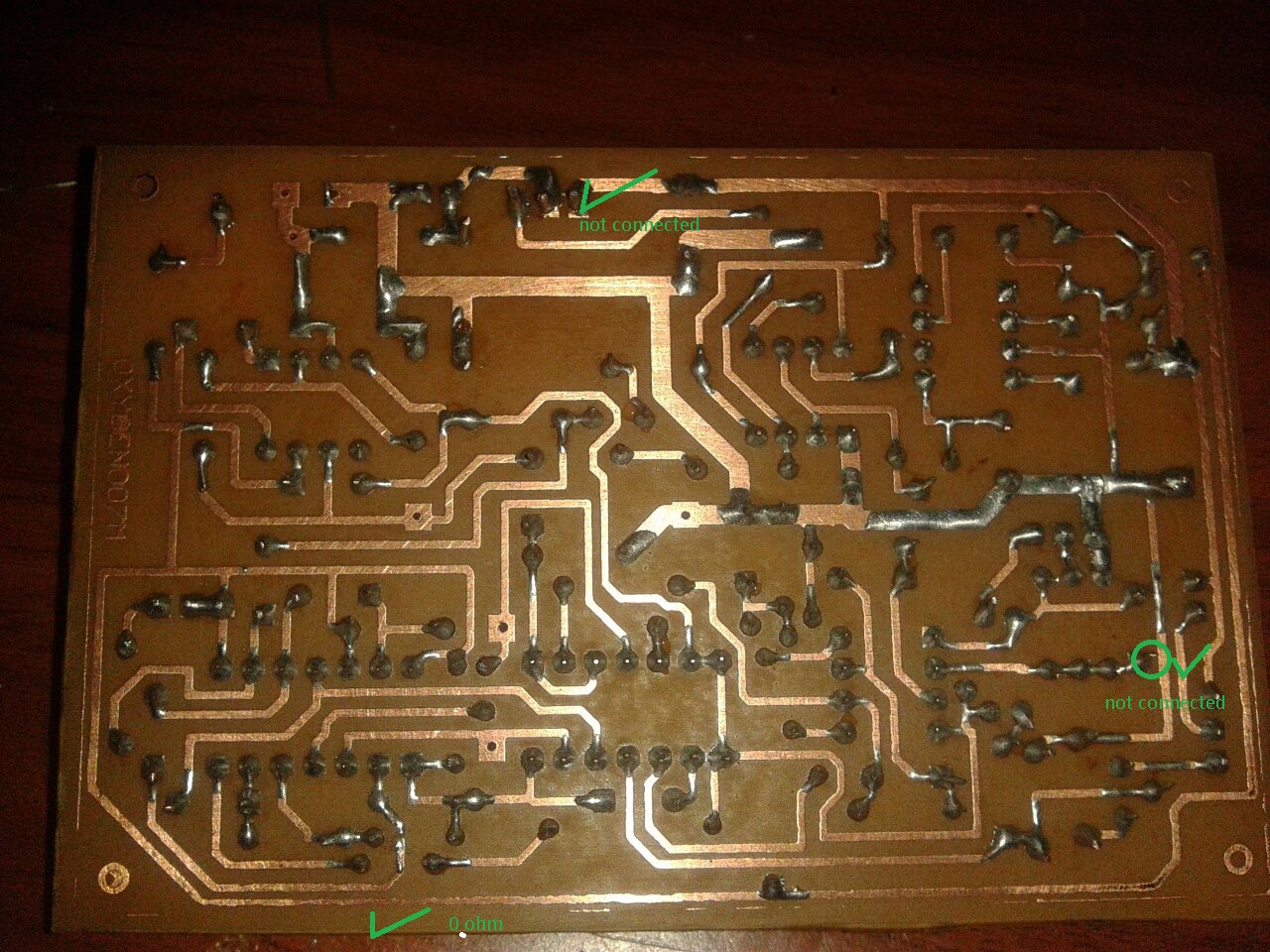

                Originally posted by eessoo View Post
                i did another one but with the same problem
                and U6 get a little hot
                how can i test it to find the problem?

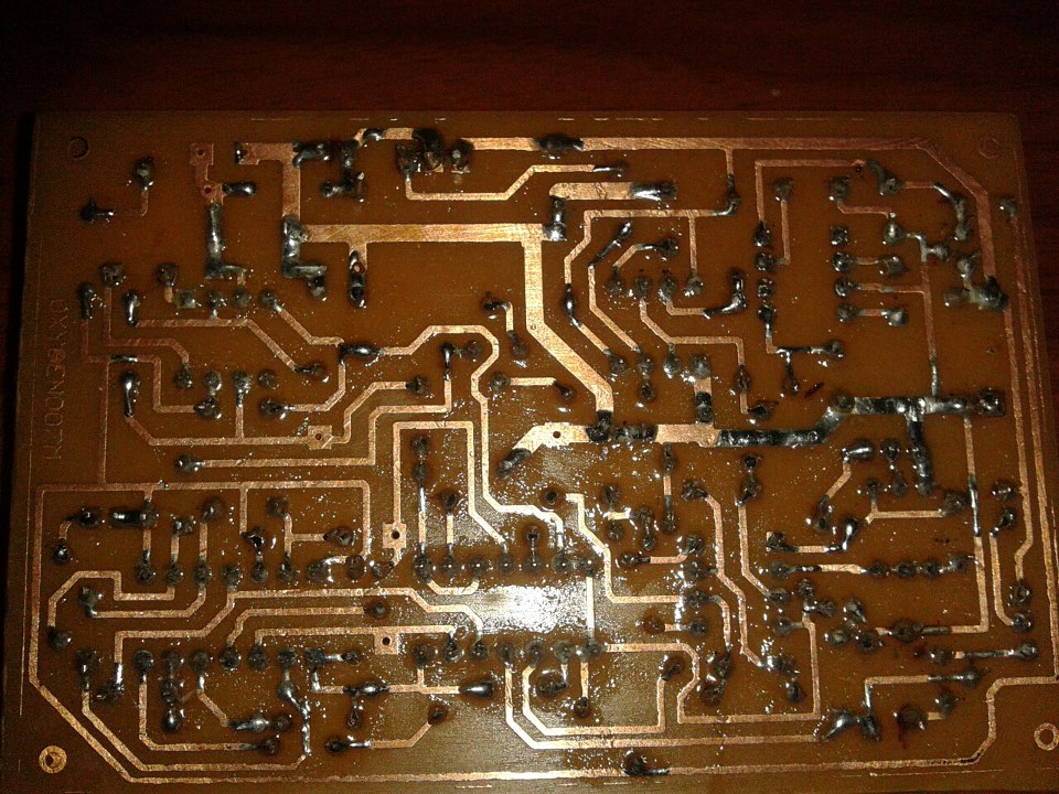

                WHO wrote this? your PCB is ALL fluxed
                WHO SUGGESTED YOU TO USE THE ACTIVE FLUX?

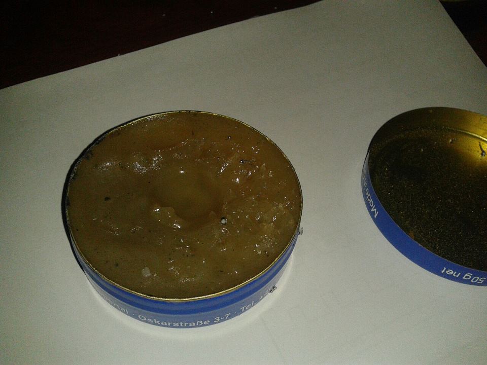

                      i made a mistake, i thought this stuff prevents dry joints and keeps the PCB clean
                      here is the flux i used http://www.alibaba.com/product-free/...showimage.html
                        It is very important that you get it all off, because your circuit will not function properly. I spray a good amount of flux on my boards and scrub it off with a toothbrush. While the board is still wet with flux remover, rinse under tap water and use a seperate clean paint brush to flush off all remover. If board is abit sticky or flux still showing, clean again and dry the board thoroughly. I hope this helps.

                            i used alcohol and tooth brush to remove it and it worked!
                            here is the picture Before and After cleaning
                            i think i will get some distilled water Just to make sure it's clean
