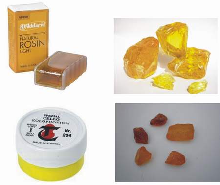

    There are cheaper ways to obtain colophony than bumping into a music store, but it is a sure way nevertheless. So once I stumbled into a not too shabby store and asked for a colophony, and a salesperson asked me what instrument I need a colophon for. When I answered "a soldering iron" he just laughed and gave me the cheapest one. Apparently there are some differences in clarity etc. between a violin colophon and a contrabass one. Anyway, for soldering all work the same.
    There are some uses for colophon in rubber industry as well, but such colophony is rather dark and not too clean. Better use a contrabass one
    There is one substance that works basically the same: shellac. It is also soluble in alcohol. In case someone in your circle is in furniture renovation business you may go for shellac. It comes in small flakes and it is usually much easier to dissolve in alcohol.
    BTW, colophony and other resins tend to shorten your soldering iron tip's life because they promote alloying of various metals, and in a process your soldering tip will become less and less ... until you'll have to replace it. I have a very old iron just for encouraging dull wires to wet by using colophony as an encouraging agent - there is not much of the tip left.
      take a colophony and dissolve it in 95% alcohol. you will get a best flux for any soldering.

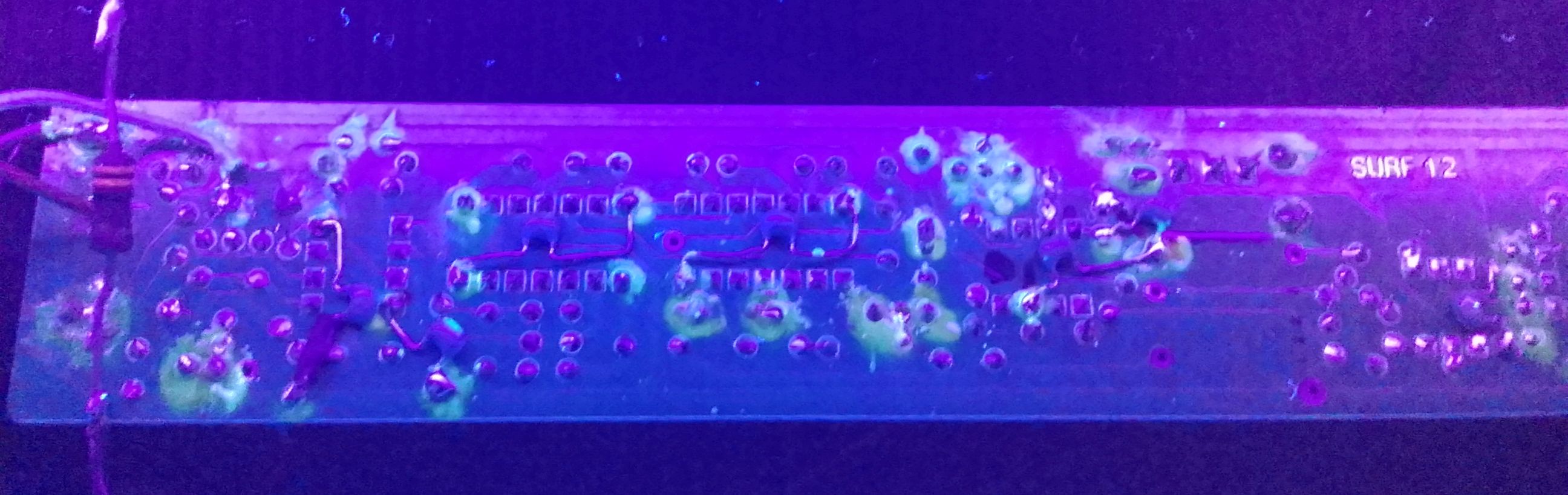

                        Since i have to use solder with an activated flux where I am most of the time now,
                        I've started to learn how to clean pcbs. Here's what's helped me:
                        - Ethyl alcohol 96+ % (I find it smells nice)
                        - Windex (Window cleaner, the ammonia component is the important part here)
                        A mixture of 50:50 does the trick for me.
                        I use toothbrushes for the scrubbing.
                        Rinsing with pure water (RO or distilled).
                        Dry well.
                        If you want to see how much flux is on your board,
                        you can use a "black light", which is also used for checking banknotes.
                        Heres what it looks like: Click image for larger version
