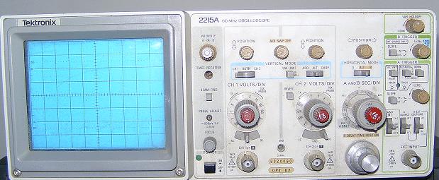

Took out my Tek 2215A 60Mhz Oscilloscope from storage to use on projects here. Was working a year ago since being in storage. Well.......

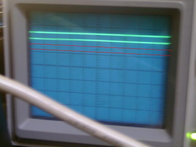

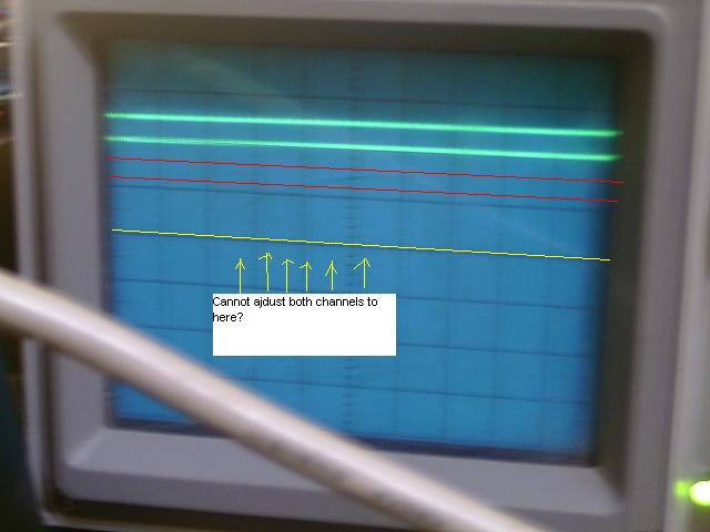

Powered it up today, unit ran perfect for about 5 minutes, then i noticed the square wave signal on the CRT i was viewing began to shrink slowly towards the center on the screen, then followed a burning bad smell beginning to emerge from the case. (similar to a bad cap).

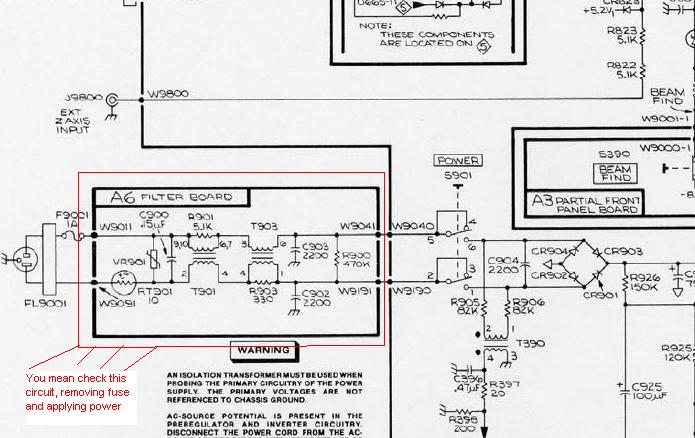

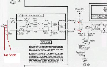

Interesting thing happened though......Upon switching unit off, 3 seconds later my house safety switch tripped and i lost AC 240 Volt to my power points.....HOW Can that be?

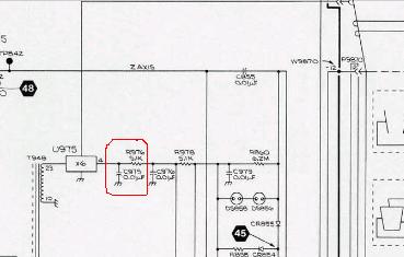

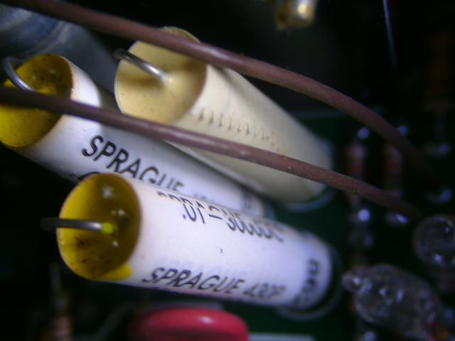

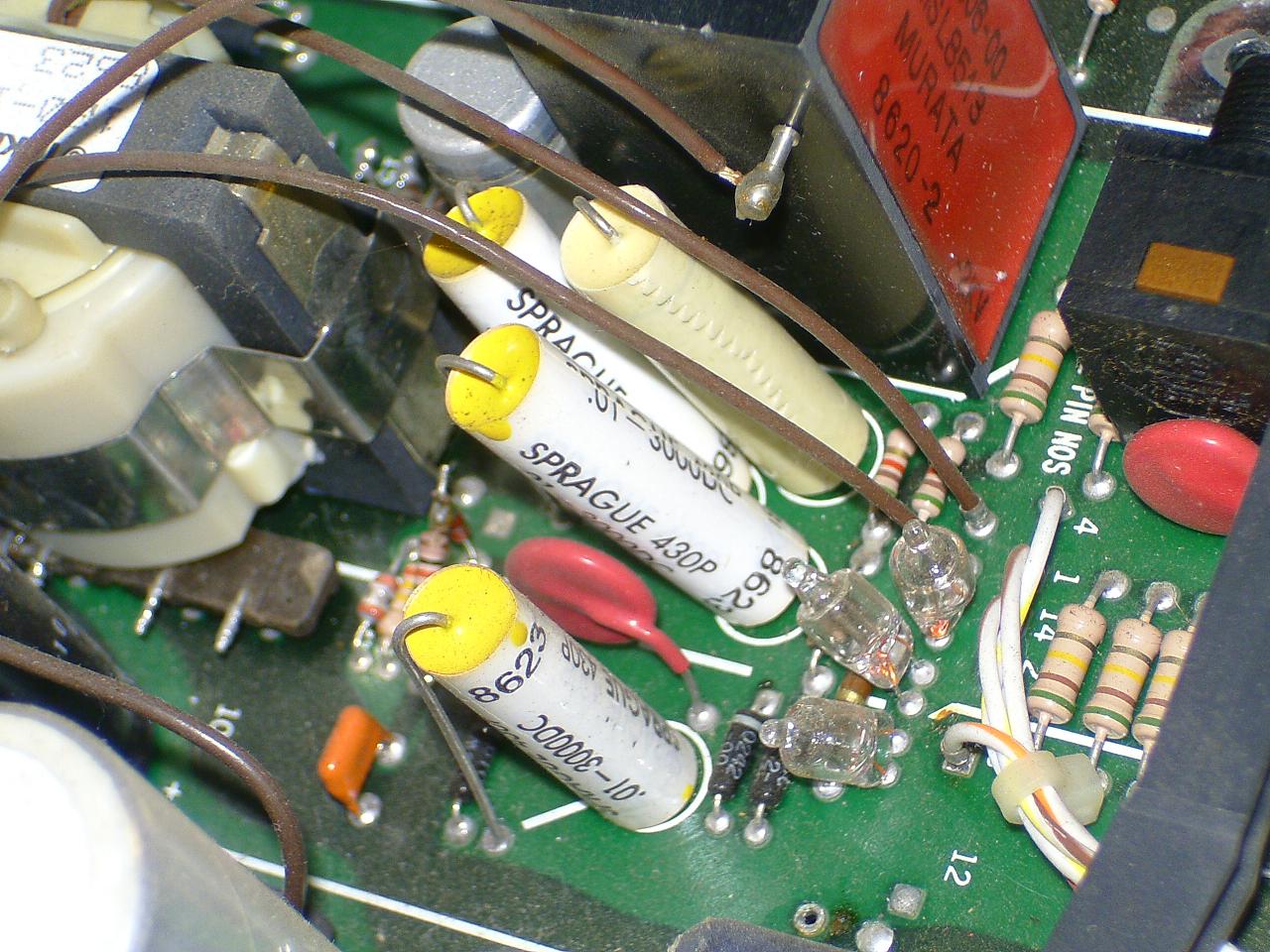

Any way, i removed the covers to inspect the unit and this is what i have discovered so far. I suspect the power supply has given up, considering the unit is 28 years old and looks like it has not been refurbished since being built from factory. Original factory caps noted.
The Pics's below show the suspected faulty visible part. Its a 0.01 mf Capacitor which is connected to ground. Not sure what other damaged parts could be there.

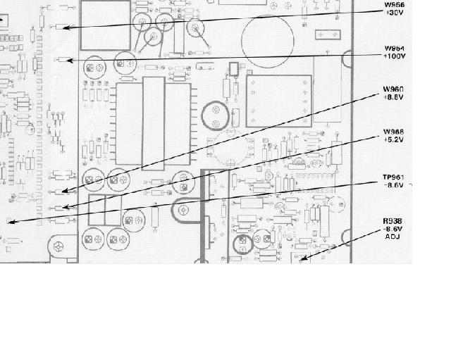

I have the Full Service manual for this scope, but not familiar with SMPS, apart from the obvious warnings of high voltage's floating around this area and the anode lead that goes to the CRT from the flyback transformer. I have discharged that lead to ground but have not done the SMPS caps so far.
