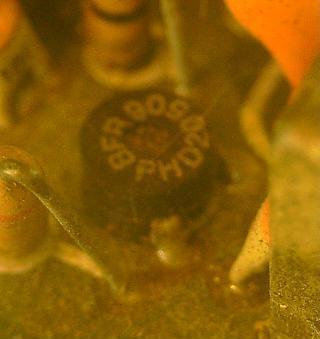

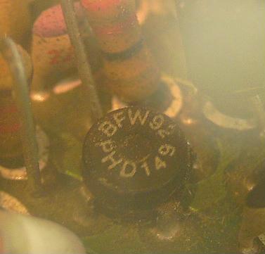

      Hi Wm6, i have only found the below transistors on some old UHF Transceiver boards, not the exact replacement, but thought to post for you to have a look and see what you think?
      Both the BFR90 and BFW92 are UHF transistors (NPN).
      Cheers
        Forgot to mention, same package type to the original OEM.
        Cheers Sido

          You can try with one of those too, check twice for correct pin connection before solder.
          BFR90
          Type Designator: BFR90
          Material of transistor: Si
          Polarity: npn
          Maximum collector power dissipation (Pc): 180mW
          Maximum collector-base voltage (Ucb): 20V
          Maximum collector-emitter voltage (Uce): 15V
          Maximum emitter-base voltage (Ueb): 2V
          Maximum collector current (Ic max): 25mA
          Maximum junction temperature (Tj): 150°C
          Transition frequency (ft): 3GHz
          Collector capacitance (Cc), Pf: 0.8
          Forward current transfer ratio (hFE), min/max: 25MIN
          Manufacturer of BFR90 transistor: PHILIPS
          Package of BFR90 transistor: TO51
          Application: Low Power, Switching
          BFW92
          Type Designator: BFW92
          Polarity: npn
          Maximum collector power dissipation (Pc): 130mW
          Maximum collector-base voltage (Ucb): 25V
          Maximum junction temperature (Tj): 125°C
          Transition frequency (ft): 700MHz
          Collector capacitance (Cc), Pf: 1
          Forward current transfer ratio (hFE), min/max: 20/150
          Manufacturer of BFW92 transistor: PHILIPS
          Package of BFW92 transistor: TO51
          Application: UHF, Low Power
            Will do so Wm6. I have downloaded the datasheets for the two now. Will look at them tomorrow and use what seems close to the original specs if i cannot find the BFR96.
            I am sure i have the BFR96, just cannot remember where?
            Talk to you soon.
            Cheers Sido
