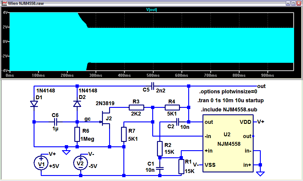

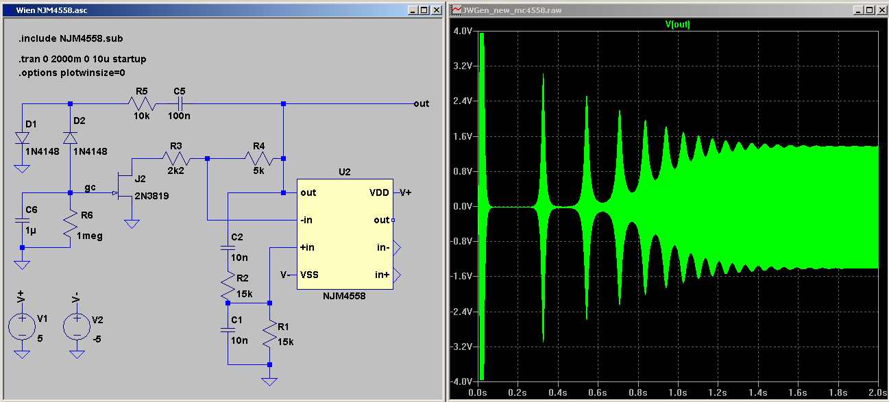

                          I recycled a wien bridge oscillator to show you how it works. This one is also for mikebg and his fascination with PID regulators in oscillator circuits - it acquires stability ... eventually, but only illusory stability - it will re-flutter once faced with any quick load change. Oscillator's envelope behaves as an integrator with constant slew rate, hence oscillation.
                            Davor, your circuit diagram contains P-I controller. It can be redesigned for better operation.
                              And yours doesn't. That's the whole difference. Of course it works better. A charge pump adds only a single pole in the loop, hence no flutter.
                              Everything else considered, yes, some kind of control is OK in the oscillator circuitry if it achieves any of the design goals, but NOT the PID because of the "I" component. Considering the oscillator by itself is an integrator with all the saturation effects near the rail amplitude providing the proportional regulation, it is a self contained PI regulator. You could add some kind of control to avoid near the rail non-linearities, but be careful about it - regulating conduction angle is a bad idea.
