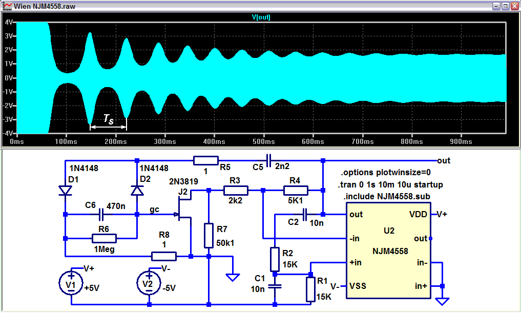

    The algorithm for practical design of PID-controller is:
    1. Disable derivative action (minimize D-gain).
    2. Disable integrative action (minimize I-gain)
    3 Decrease slowly the proportional action (P-gain) until ringing becomes decaying sinusoid.
    4. Measure period of ringing Ts.
    5. Calculatre integrating timeconstant Ti ten times more than period of ringing, ie Ti=10Ts.
    6. Calculate derivating timeconstant Td equal to period of ringing, ie Td=Ts.
    7. Enable integrative action and decrease proportional gain until overshoot disappears.
    8. Enable derivative action, the system will operate with minimal settling time.
    9. Check for noise. To suppress noise, increase HF filtering for derivative signal.
    I will illustrate how to make this with SPICE for above circuit diagram.

              To Russian colleagues. See circuit diagram in post #18.
              Resistor R8 involves derivative action. The action is disabled by using 1 ohm resistance.
              Resistor R5 makes HF filtering of derivative action. The action is disabled by using 1 ohm resistance.
              Resistor R7 is used to reduce P-gain. To obtain ringing, the action is disabled by using high resistance.
              Voltage divider R3-R7 can increase integrating timeconstant.
              Note that unlike original circuit, the output has symmetry and distortion is reduced.

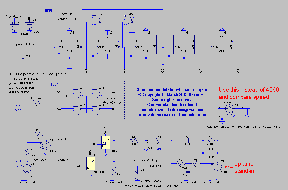

                Need to help make model CD4016 CD4066 CD4053 for LTSpice?
                Thanks.
                  These models are available at LTspice yahoo group. I think you won't find 4016, and the models of 4053 and the other more complex switches are built from SPST switches. I use these models regularly and they are fine.
                  Your simulations would finish much sooner if you use a switch model that is supplied with LTspice as it does not compute the mosfets behaviour as 4066 model does. You have to define the parameters in a .model statement where you put the switch on resistance etc., but otherwise it is a faster method to accomplish things. I use this switch instead of comparators as they are notoriously slow to converge, but with switches all is done in a jiffy.
                  Here is the thing I'm playing with at the moment. I also configured the LTspice switch for this task so you can compare the results.
                    ok 4066 model
                    you helped me, and how to find 4053 ?
                      You won't. 4053 is basically the same kind of switch as 4066, except that two gates are used, and one is driven by an inverter. You can make a macro model with 4066 as a starting point. You'll find HC etc. variants of 4066 at the yahoo group, but not the pre-digested 4053

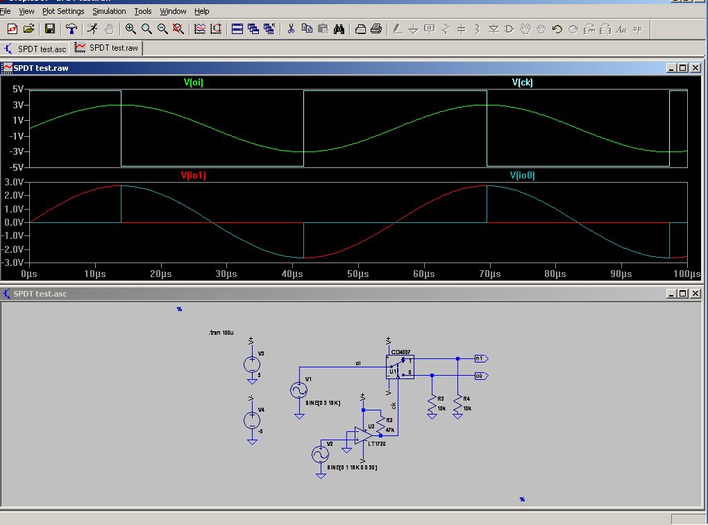

                        Derx,
                        CD4053 is a triple SPDT switch.
                        I pieced together a single SPDT switch (model) from individual MOS transistors like what you would find in a CD4007. Here is a single SPDT switch model/symbol combination that works in LTspice.
                        It works about like 1/3 CD4053, except that my model has no enable input.
                        I did not compare transistor specifications from the CD4053 datasheet against what is here because I am not concerned with such details. I just wanted something that works.

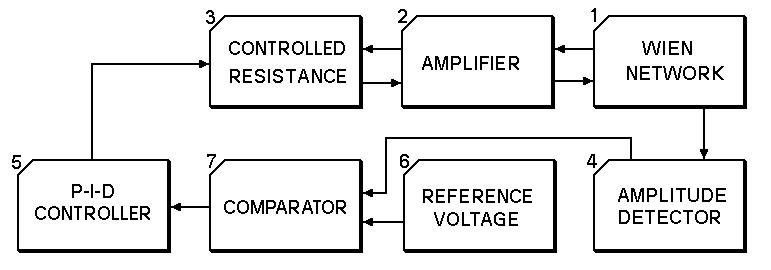

                          LET WE DESIGN WIEN BRIDGE OSCILLATOR
                          Why SPICE can not make the above circuit diagram of Wien bridge oscillator to work better?
                          The reason is not the too bad circuit diagram, but the very bad block diagram. The correct design method requires to start with an analysis of the most suitable block diagram. The SPICE can not show what should be the appropriate block diagram. See how the revision was carried out and the redesign was made for Relic Hawk TX circuit.
                          After the appropriate block diagram is clear, make the implementation of components of each block and obtain the complete circuit diagram by connecting the blocks. Only then apply SPICE to adjust certain values.
                          Below is shown the appropriate block diagram for Wien bridge oscillator. The task of the controller 7 is to maintain a constant amplitude at the output of amplifier 2. The opamp used for amplifier operates with little distortion when the output amplitude is significantly less than the supply voltage. In this case, supply rails are 5V each, so we can choose an automatically maintained amplitude 2V. The voltage generated by the amplitude detector 4 is compared by block 7 with reference voltage 6 and the difference is submitted for processing in controller 5.
                          The controller 5 must contain an amplifier with very high gain that is missing in the original circuit diagram. The additional amplifier is not a problem because the integrated circuit contains an unused amplifier. It remains to connect to it two resistors and two capacitors only.
                          Those who like to construct, let implement this block diagram. The SPICE will show that your design works better than all other Wien bridge oscillators published on the INTERNET because it is designed in the right way.
