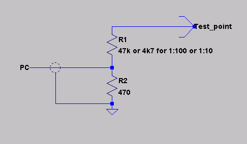

          what are you useing as a probe for the sound card ?
          thanks
            Something like this...
              Hi Davor
              thanks , it has no protection diodes, are they not needed for sound card ?
                I think it's best to insert an old sound card in the PC costing 1e around anyway, so what is one to be - there will be a shame if something goes wrong
                  Protection diodes are not needed if you power your rig with batteries. You simply can't produce voltages nearly high to do any damage. That is actually the only caveat. Real laboratory instruments have carefully designed power supplies that float. You can't expect a piece of consumer electronics such as PC to be as good, so make sure your device under test is floating instead - power it with batteries.
                  You can put antiparallel diodes in parallel with a 470ohm resistor if it makes you feel better.

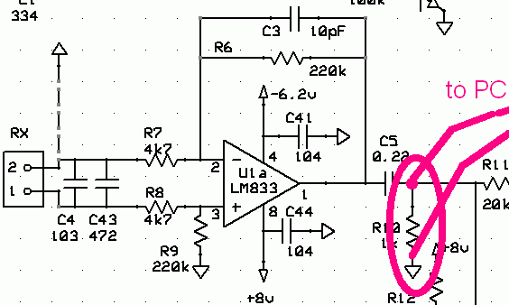

                  To do any meaningful measurements in ~10mV range, you'll have to connect your PC sound card directly. In that case make sure you actually have a low impedance to hook it to, and that you do not expect much more than 100mV there. The best example is hooking the PC to a 1k resistor at the output of a preamp in order to fine tune the coil balance. First you establish a coarse minimum to get below 100mV using a 1:10 probe, and only then you hook it directly, and with no 470ohm resistor. See example:
