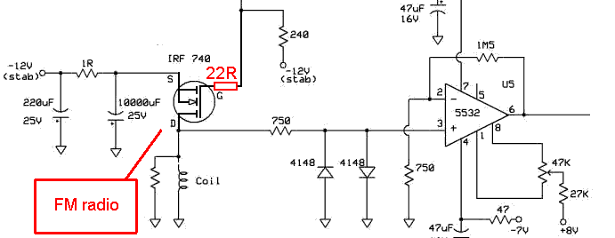

    Hi to all.
    this schematic is for ps g and i make it but i have not the values.
    my problem in bd140,pin3 ne555 i have-10.35v but it should be 10v, drain of irf740 340v by multimeter but i have not voltage.
    and i change ne5532 instead lf357n.
    andin pin 6 lf357 should have -0.2v but i have 5.5to6.2v.
    who can help me?please.

      NE5532 is wrong, must be a single op amp with offset control towards positive rail. Use NE5534 instead.

        ok i change ne 5532 to lf357n.i think it is correct
        thanks.but i have problem yet in drain of irf740 and pin6 lf357n ...
          The offset adjustment method for the 5534 probably won't work for the LF357.

            Mohandes, there's something that can be seen only with an very expensive oscilloscope, but you can hear it with FM radio. This is the VHF ringing of MOSFET, causing heating of IRF740 and interferences the input of preamp to operate normally.
            Place the antenna of an FM radio near to damping resistor as illustrated. If you hear the TX repetition frequency on the radio, there is a VHF ringing. Connect a 22 or 33 ohm resistor direct in series to gate lead of MOSFET. The effect should disappear.

              i test by oscilloscope but i dont analysis the figre on the oscilloscope .i Drawing this figure and post for all,to help me.
              in pin6 lf i have to have -0.2v but i have near 6v.and drain irf740 i have not 340 volt by multimeter so what is my wrong.

                I know that i shoude have in drain irf740 340 volt by multimeter and i have -0.7v and not hot irf740.i check my pcb and every think and i test by oscilloscope but have different result and dont know my problem, ithink my problem in bd140 or bc337 in path of gate irf740.
                and what is the problem for lf357?can you help me ?

                  If you are using a multimeter you won't see 340V even if everything is working correctly.

                            Carl, you are right. When i constructed it, with Oscilloscope reads 400....450 V p-p. So the value by multimeter will be much lower.

                              Right..... offset at LF357 is at pins 1 and 5.
