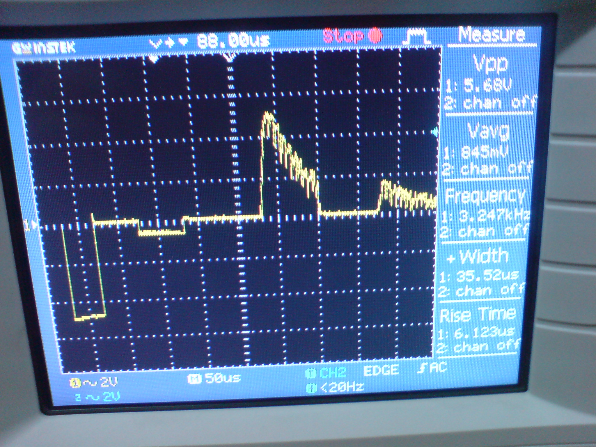

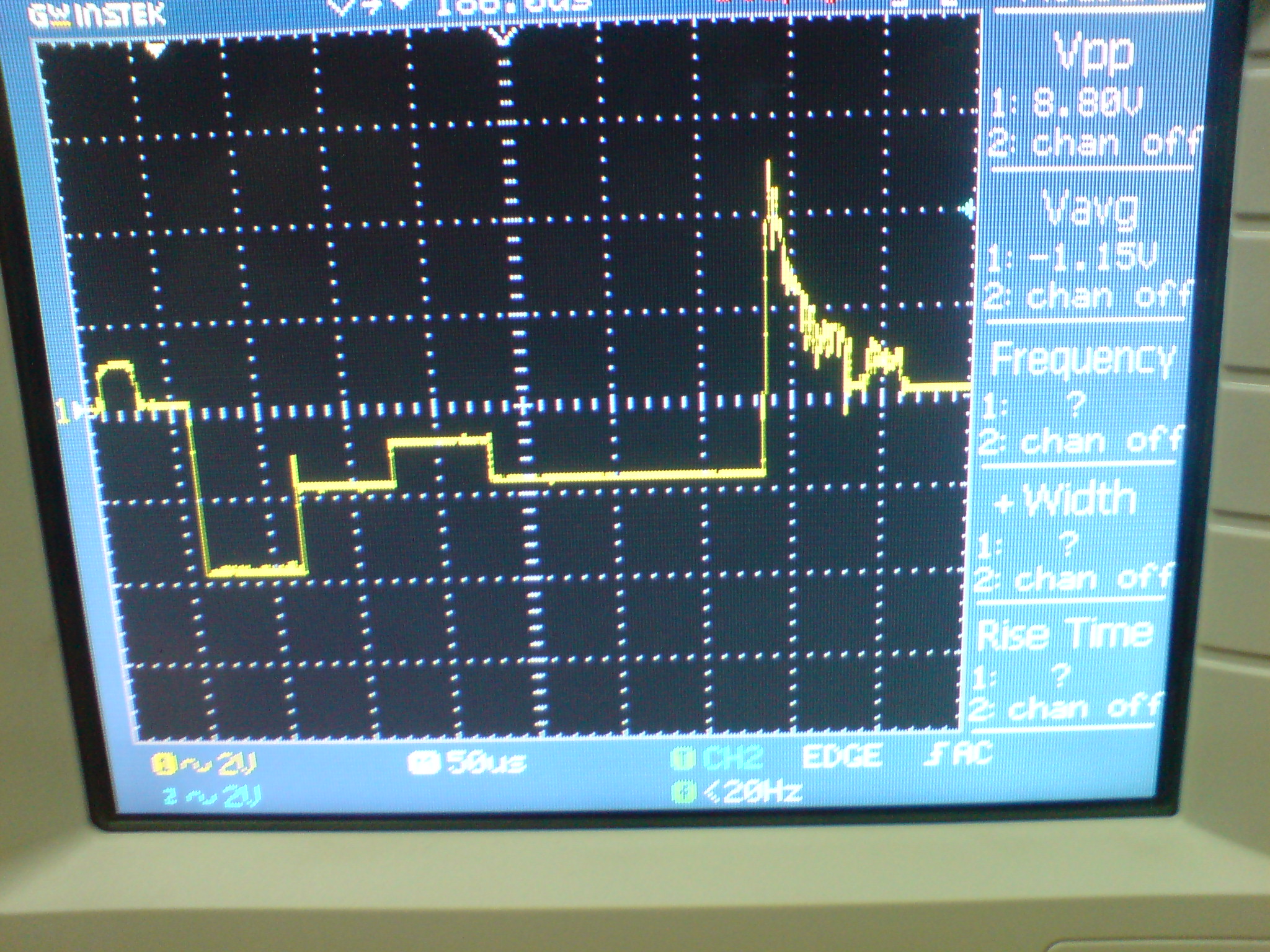

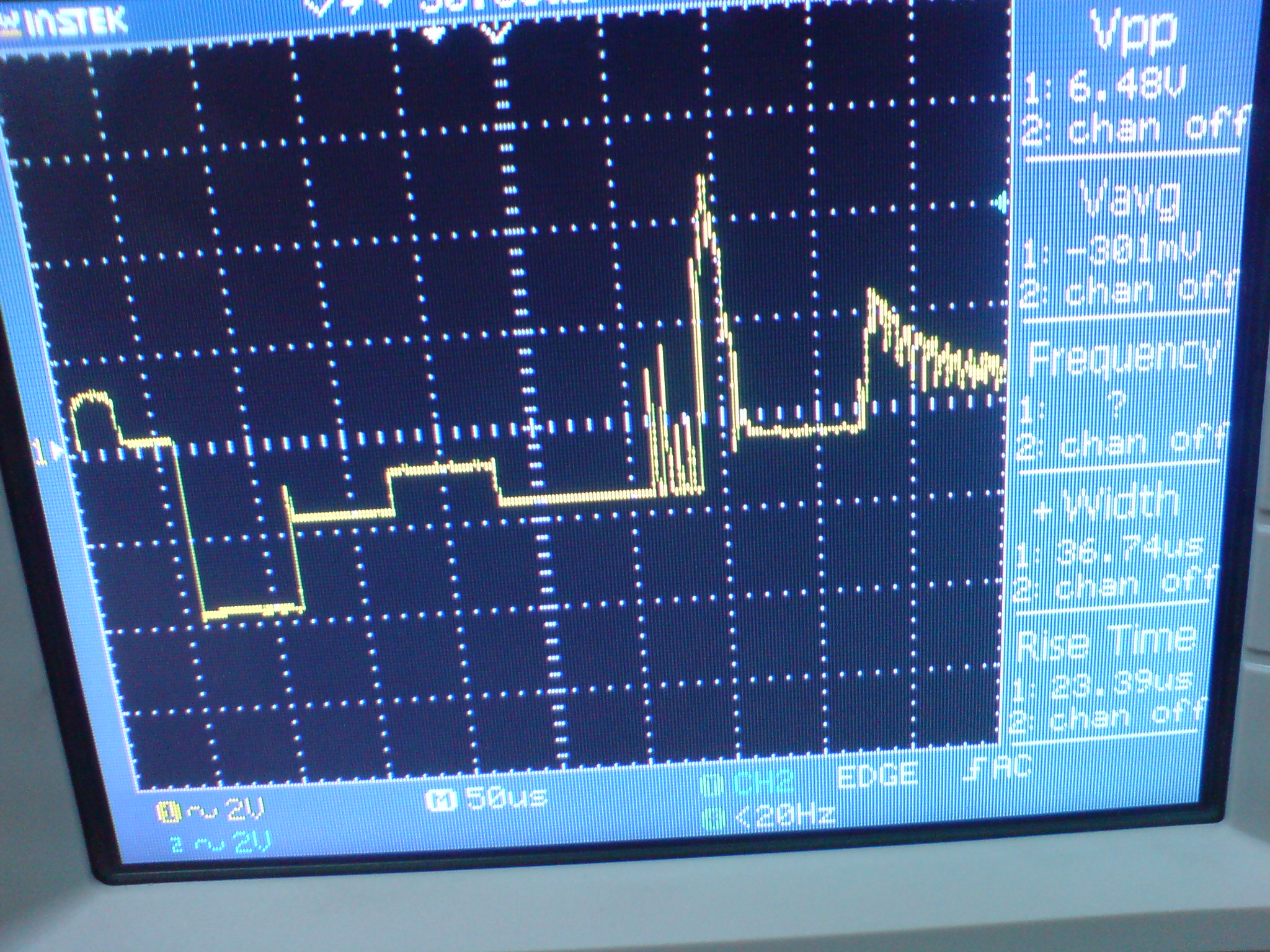

          • Hi
            mr georgi and porkluvr.finally i solve it in my second board
            look at the picture.
            first picture for Sc and sb
            second for otu pu ,x,y,z(x is yellow and z,y are blue)
            finall picture are sequence piture of:x,y,z(when connect third board)
            and i think alexis schematic for third part is wrong too,look the georgi schematic!
            OK AGAIN I check the both schematics and if you help me thanks.please

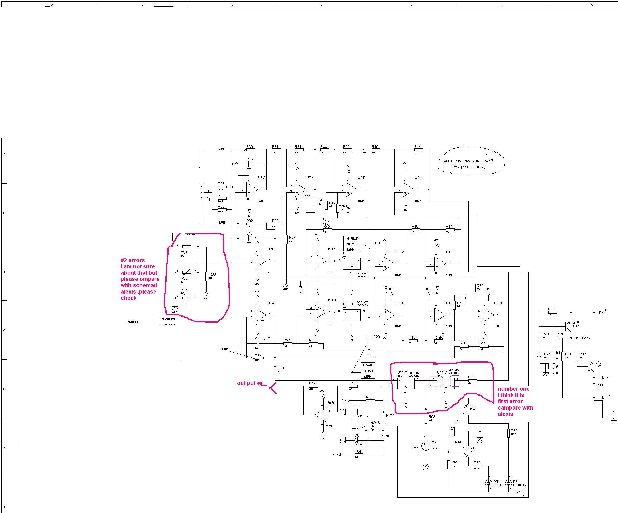

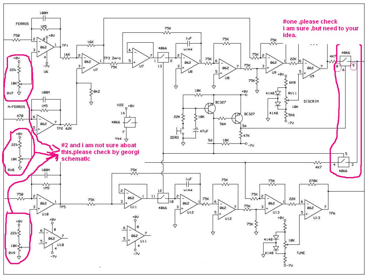

                • Hi all
                  i check the alexis schematic by georgi and found more errors(2 errors) but need your Experience to i am sure.i explain in the picture ,please check and say me.
                  thanksClick image for larger version

                  • Some of those signals look so alike that I am thinking that you have solder bridge somewhere. If that only occurs when the third board is connected... likely that short is on third board.
                    • hi my friend
                      yes ,if you look number 155 and see second picture ,these are for out put X,Y,Z before i connect to third board.can you Simulation x , y,z if you want?
                      and for my second pcb iam sure not connection with solder.
                      please see #158 and say to me your idea about them.i think the problem of hear
                      thanks.

                          Hi all
                          thanks[ATTACH]24692[/ATTACH][ATTACH]24693[/ATTACH]
                          Shematics are correct !Еrrors are with you ,ОК?Check everything again.

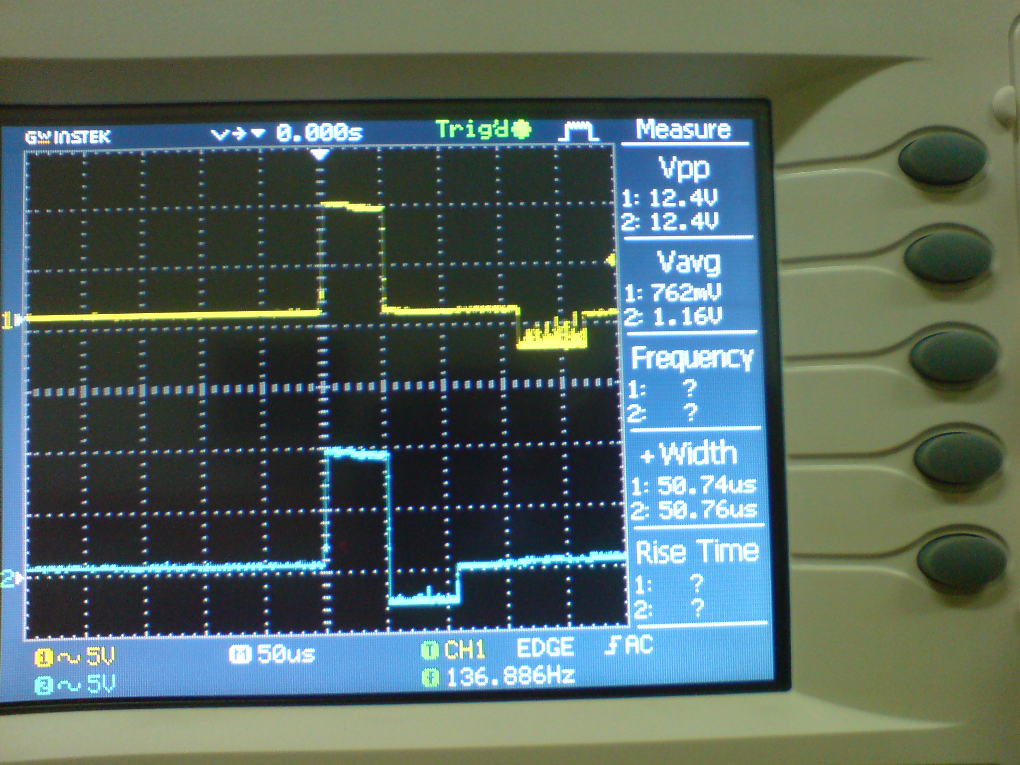

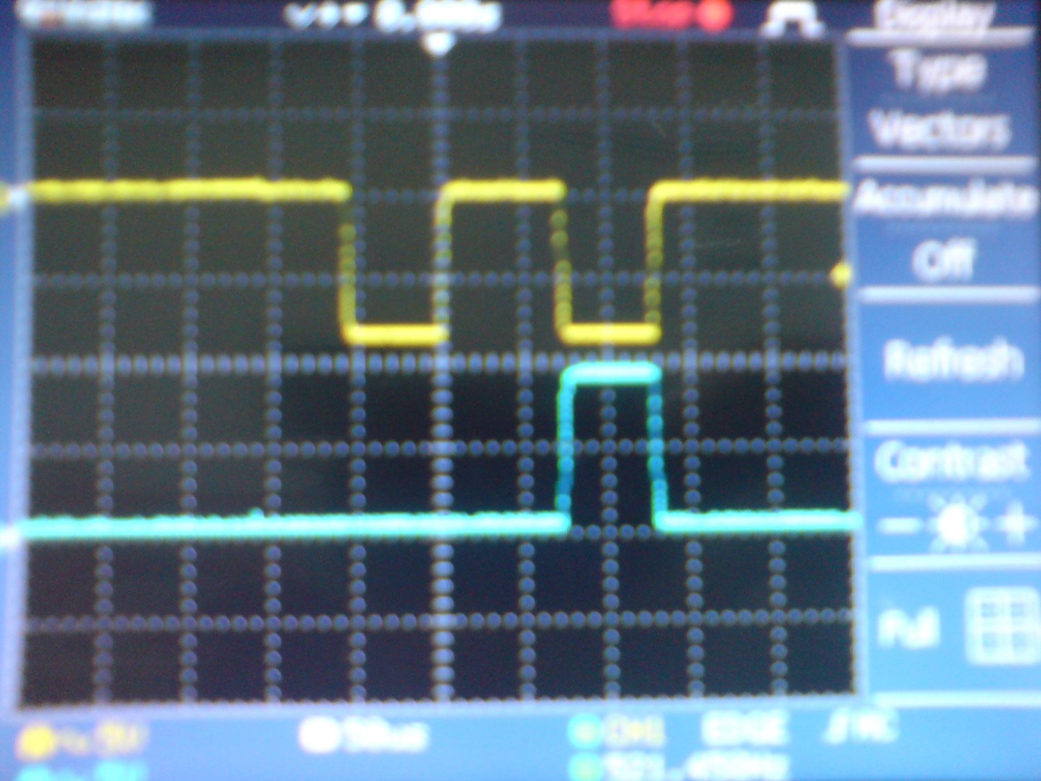

                              Who can tell anything from looking at a single pulse?
                              Don't you have a dual trace scope?
                              On the CD4053, dual trace the following pairs
                              pins 11, 14
                              pins 10, 15
                              pins 9, 4
                              ch1 probe goes to 11, 10, 9
                              ch2 probe goes to 14, 15, 4
                              Show more than a one cycle (pps) on the screen. How about two!
                              Make sure you have +8 on U4-16 and -7V on U4-8 and no solder bridges between pins or between traces.
                                pins 11, 14
                                pins 10, 15
                                pins 9, 4
                                Hi
                                ok i measure by 2 channel forins 11, 14,pins 10, 15,pins 9, 4
                                i check U4(ne5534 and correct for pin 7=8volt and pin4=-7volt)
                                check third pcb all correct.
                                but i can not found U16????
                                dont need i measure by scope some output of third pcb,if need where?
                                thanks
