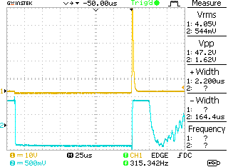

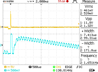

            hi please more explain.for example my coil is 451mkH and 2.1 ohm , so can you tell me more.i set the ne5534 on 0volts and this wave is very bad

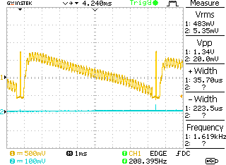

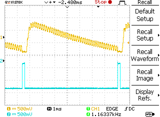

                    hi
                    i do this:
                    befor all , i set ocsillogram , next :
                    first nulling pin3 5534
                    next set pin6 on 0 volt.then find parallel res to coil by pot(i use variable res 2w ,and find that 50 ohm and yet was nulling)
                    when i find the parallel res i disconect the nulling and adjust another ....
                    my oil is 467mkH and 1ohm.
                    pin3 555 and pin6 5534
                    coil and pin6 5534
                    you know res parallel 50 ohm

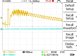

                    • mohandes,put a damping resistor 240 ohm, and do not bother with more resistors . Your problem is reseiver NE 5534, show an image signal pin 6.

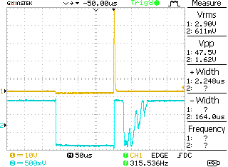

                      • i put 240 ohm 2watt.
                        why i cannot the osclloscoe?

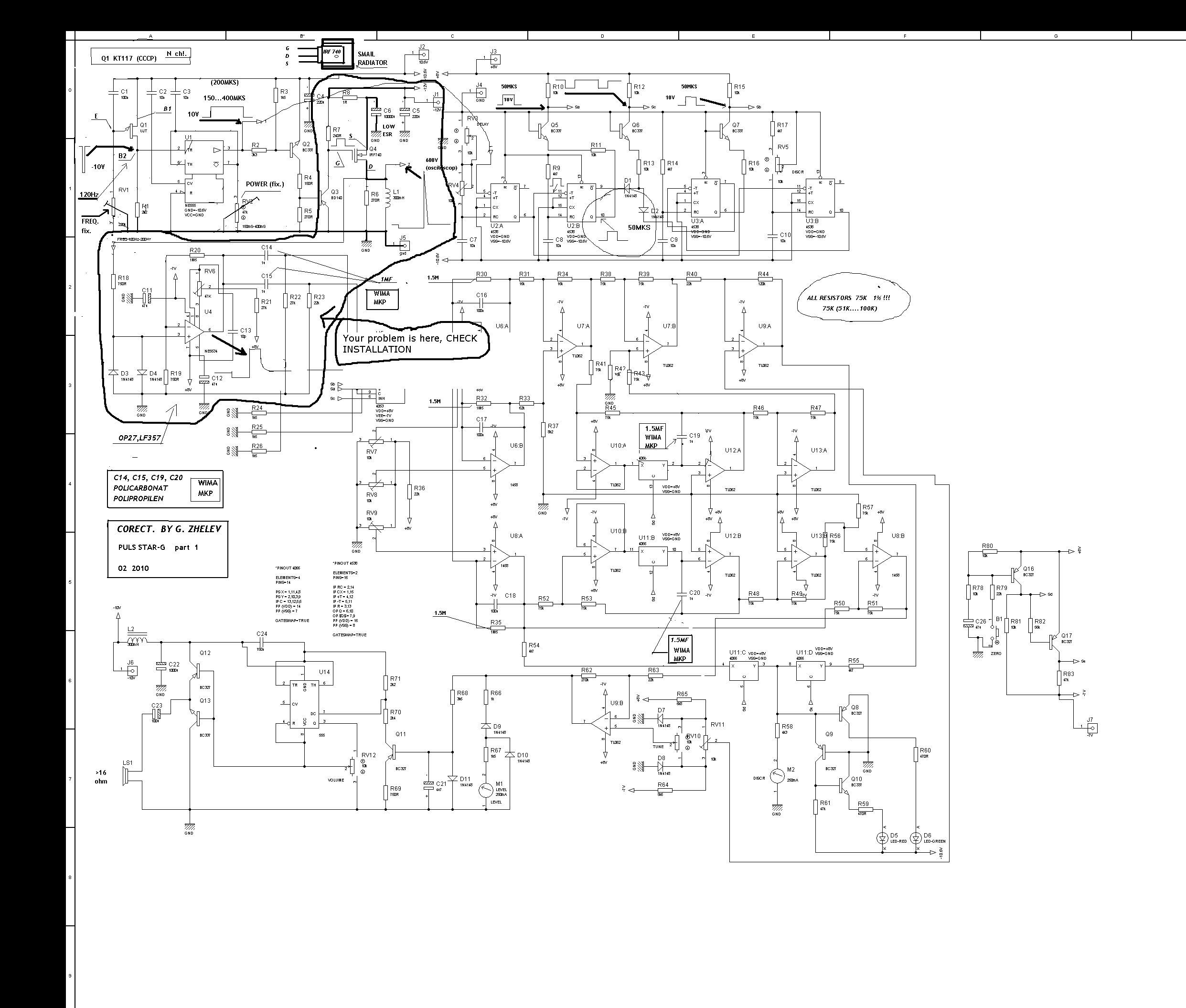

                        • mohandes ,Your problem is here, CHECK INSTALLATION , CHECK PCB . It is very easy, why do not you do it ???

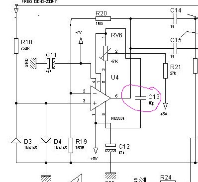

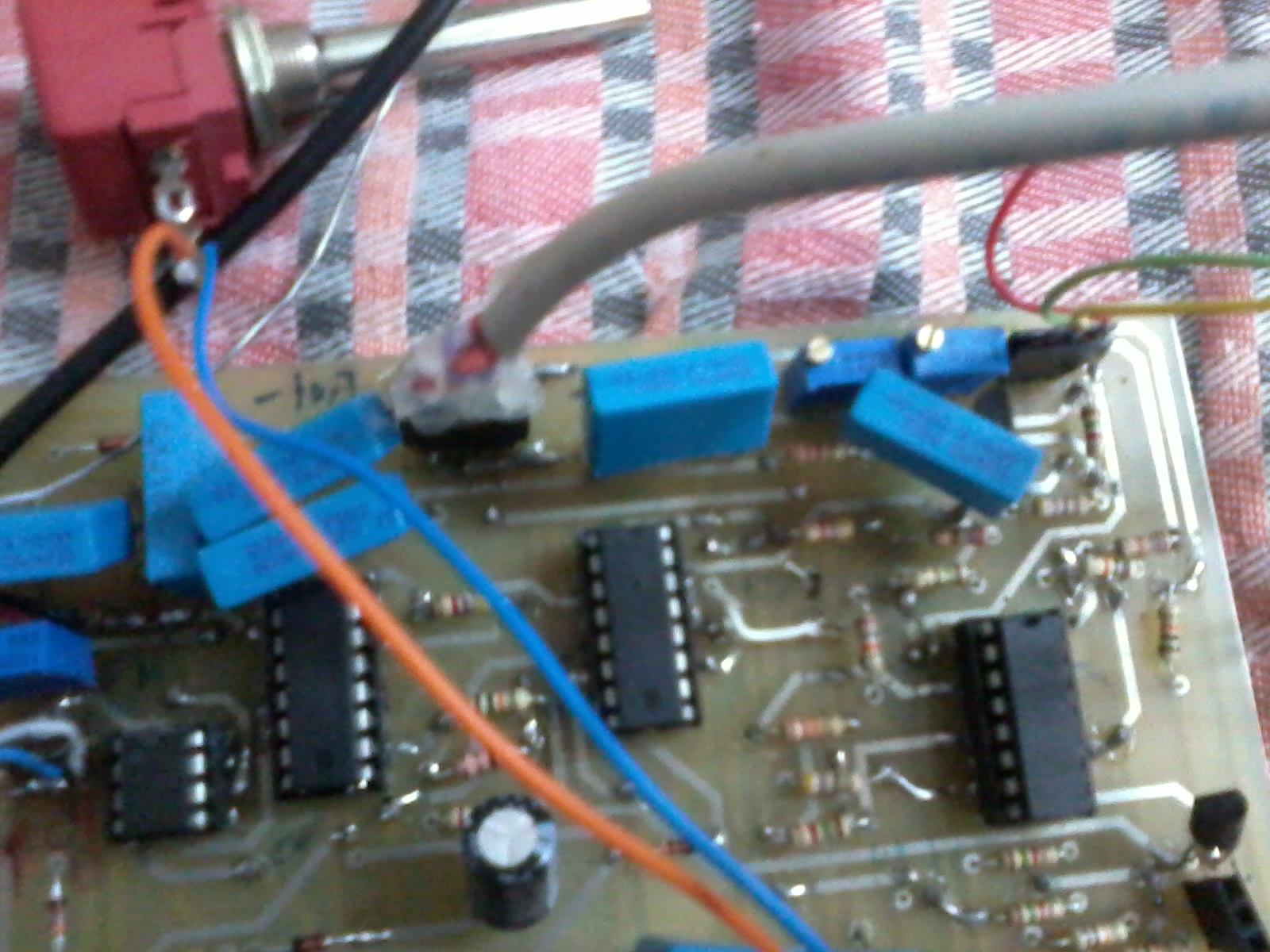

                          • That looks like ringing from your compensation capacitor being connected wrong. How is it connected?
                            Can you show us the back of the board where it is installed?
                            edit: remember, that component was omitted on Alex's schematic and the PCB, and Georgi's drawing shows it connected in an unusual fashion.

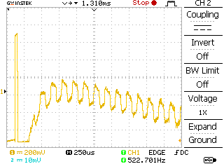

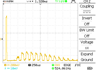

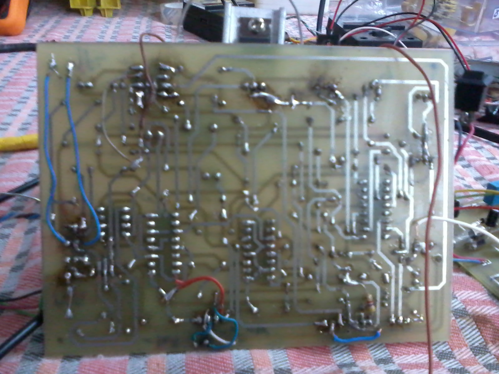

                              hi
                              now i put another pics.i work to find my problem but all are OK!!!
                              if you remember befor ne5534-6 was ok but pin10 second 4538 have 0volts (not wave and i change pot and res that to connect to pin 10 ,then it is ok) so what is your idea?

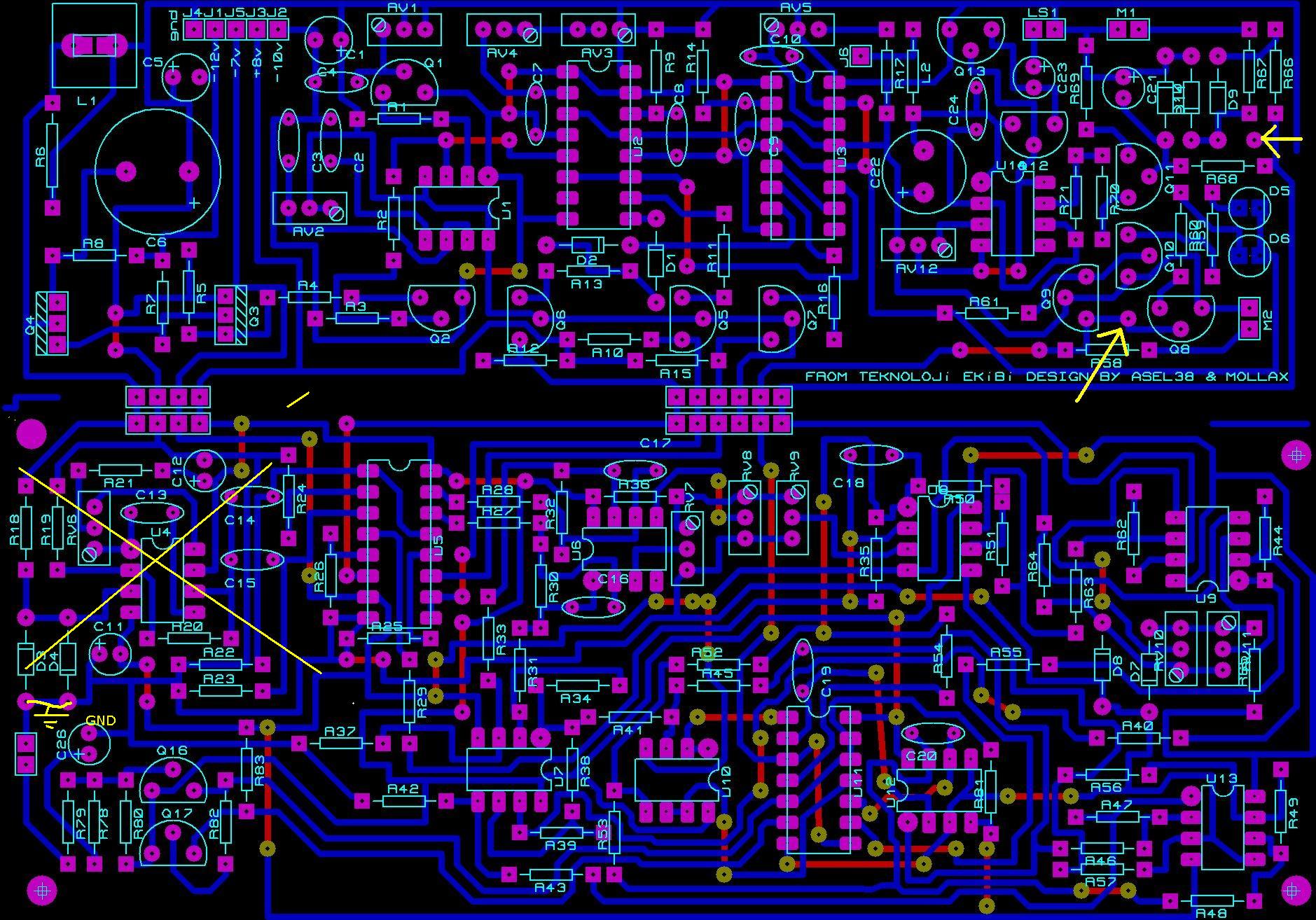

                              • mohandes your PCB IS VERRY BAD DESIGNED , R20 directly to pin 3> pin 6 ; D3,D4, directly pin 3 > GND; C13 directly to pin 1>pin 5 ; R19 directly pin2 >GND. OK?Click image for larger version
