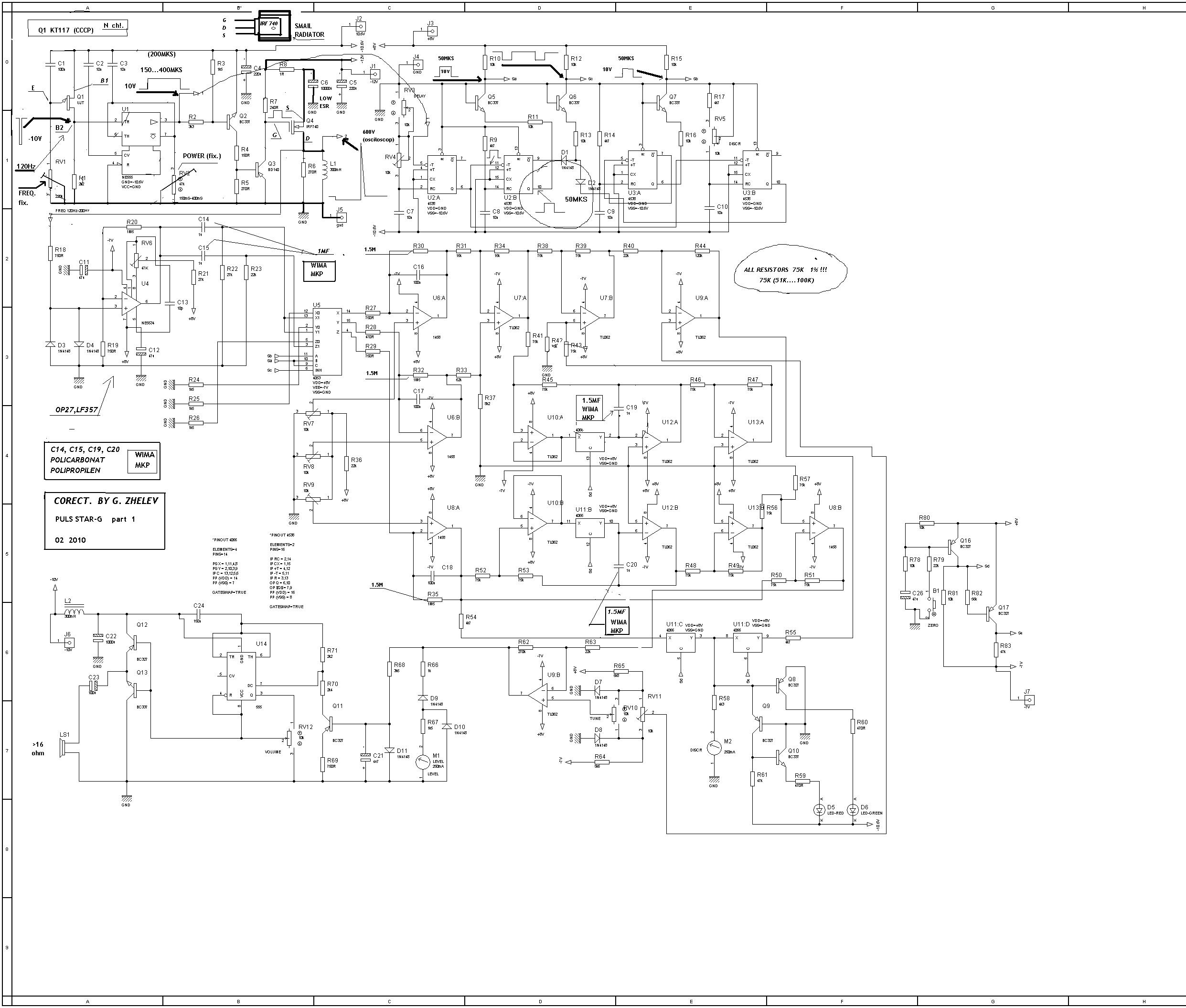

Analysis this schematic
    Originally posted by mohandes View Post
    Hello georgi

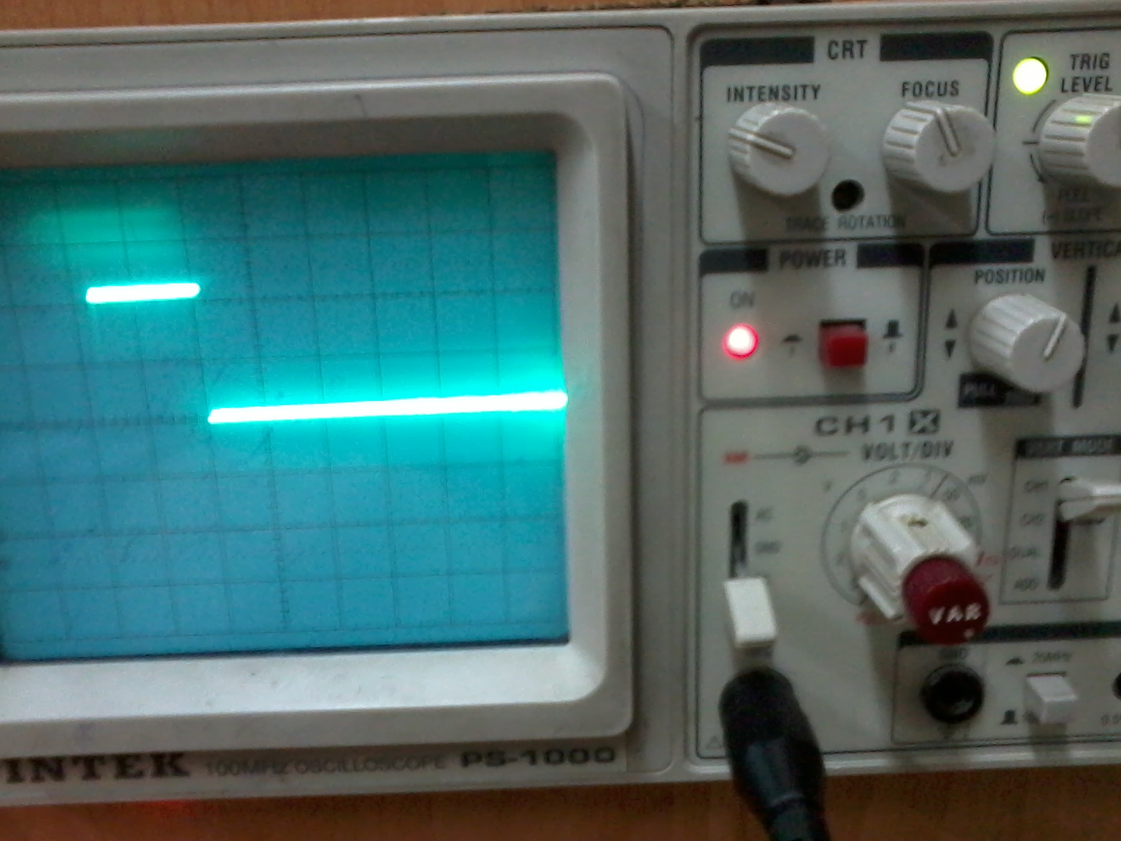

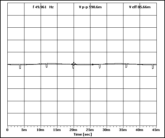

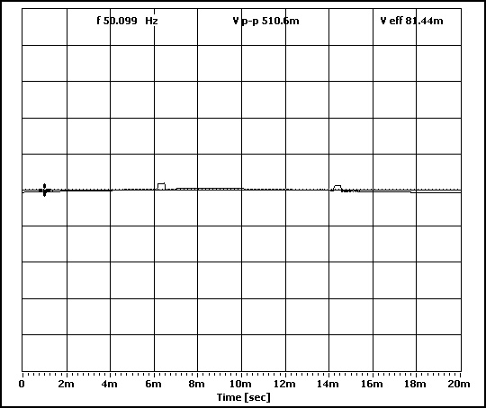

    why when i adjustment other potentiometer pin6 lf357 have variable value?????for example when i adjustment potentiometer 100k and potentiometer 10k(delay) and potentiometer 50k output change?
    and in pin 10 U3(453 i have Fixed value and it -1.6mv?
    mohandes , This is your first MD? Where you live ?
    I'm tired, I'm not a teacher, sorry .
      sorry manmy frist problem is i have not oscilloscope , and second problem is iam not good student but ok, i will make oscilloscope by computer and send for you my results.and other problem is in my city( live in Iran and my city is Mashhad) have not Low Sales parts example ne5534 and lm2940 ,...and i should be go another city and buy it.georgi i am not perfect but you know when you have not measurment instruments this problem become much.ok when i measure by oscilloscope i put my result but i need to your helpthanks
        Hi to all

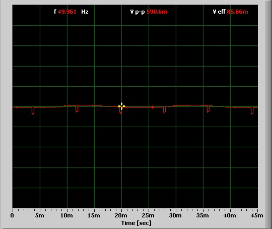

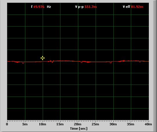

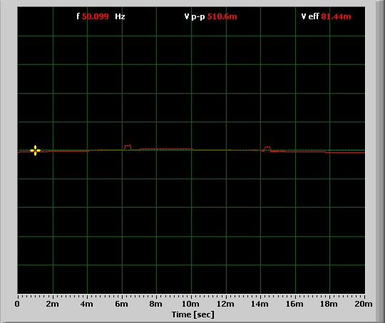

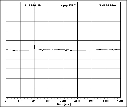

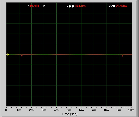

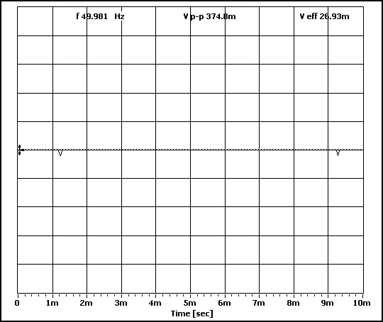

        davor i can not measyre the voltage by the oscope program?and can not measure the small value, why?
        mr georgi i measure by this oscope(in computer) and my results is good but i dont know why the lf357 not work well?
        thanks
Name:	drain irf740.jpg
ID:	335641Click image for larger version
Name:	drain irf740_bw.jpg
ID:	335642Click image for larger version
ID:	335643Click image for larger version
Name:	pin3 lf357_bw.jpg
ID:	335646Click image for larger version
ID:	335647Click image for larger version
Name:	pin6 4053_bw.jpg
          You should get friendly with your scope, but I already mentioned on the other topic that PC scope is too slow for PI.
          Your rig will not work good with lf357, find NE5534!

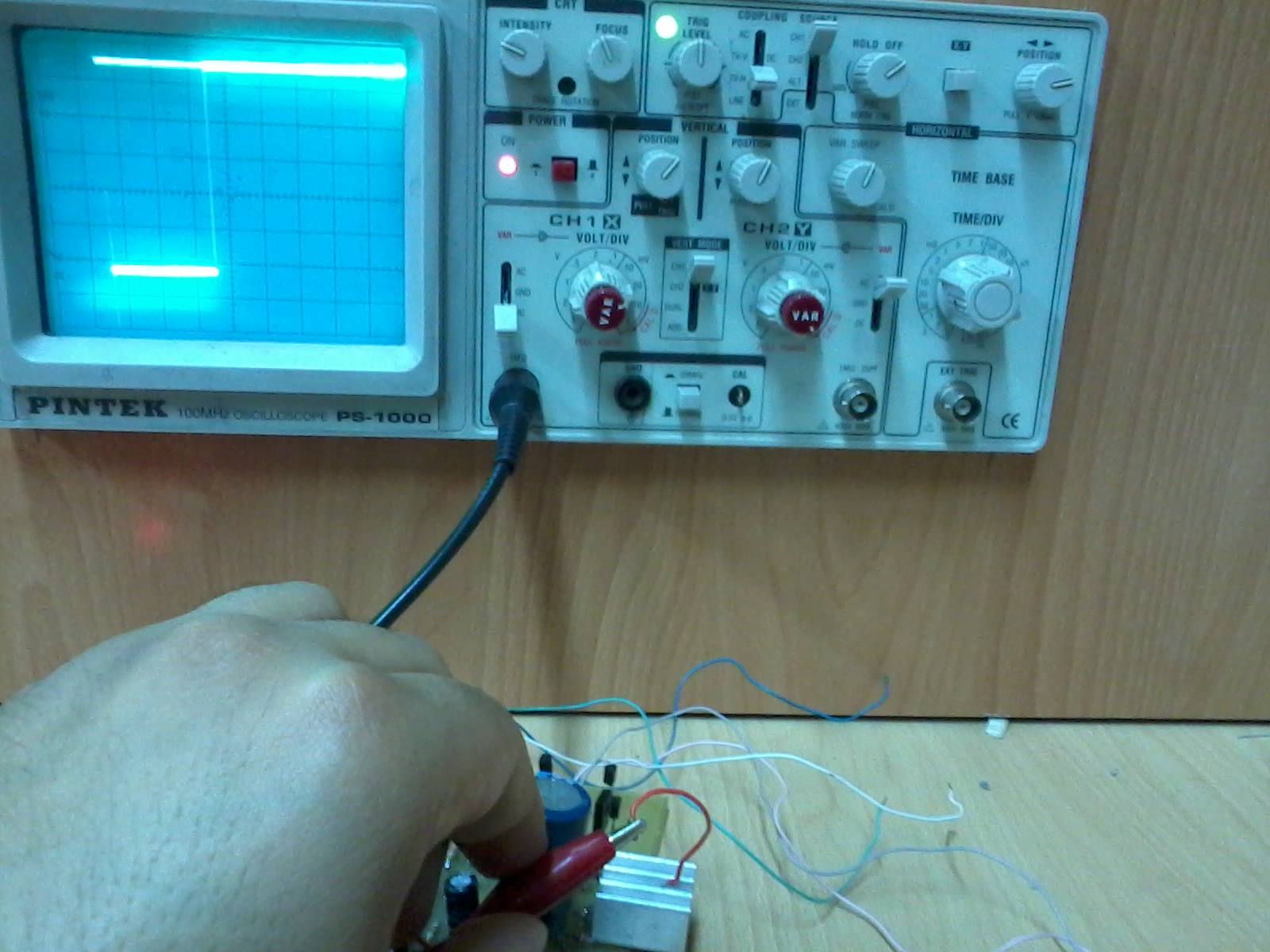

                      i design my pcb for ps g , and all work i do for make this,i check alot pcb conection and ect for find my error but i think my error in my lf357.i change pin5 and pin8 lf357 toghter in my pcb,tomorrow i will go to collage and check all conection by oscope
                      I finish 4 pcb and set part but i am going to check all Step by step.my first pcb (power suplly) work well and i finish that about 3 weeks ago,but the second pcb that i put the picture dosent work well , i want finish it but i dont know my problems exactly.
                      thanks and regards

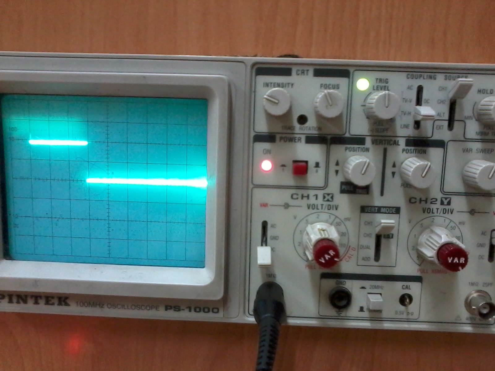

                            Hi georgi and all

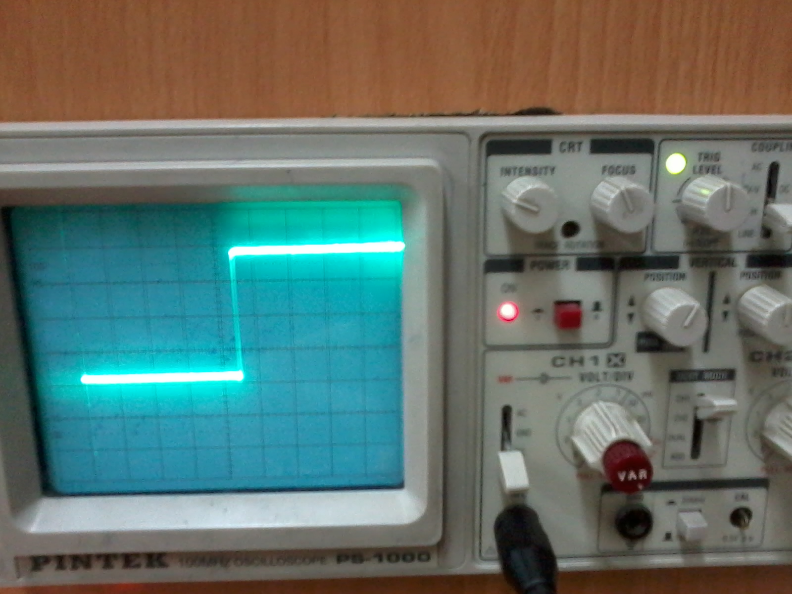

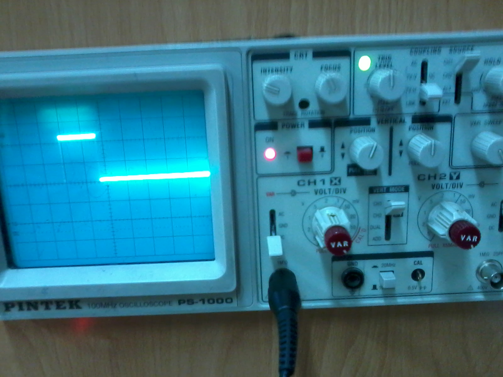

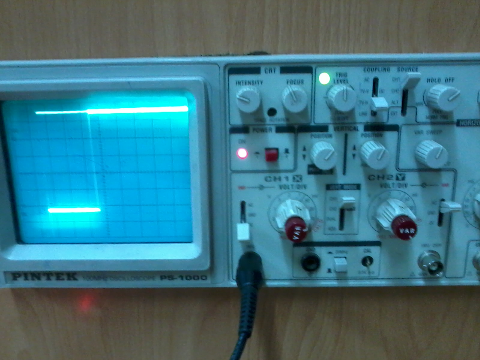

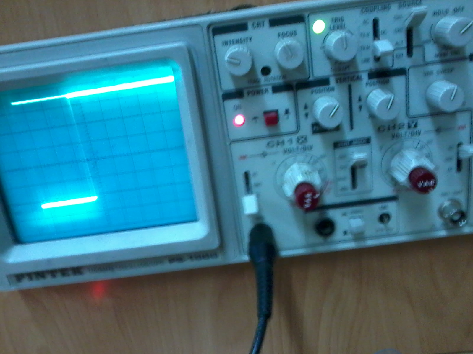

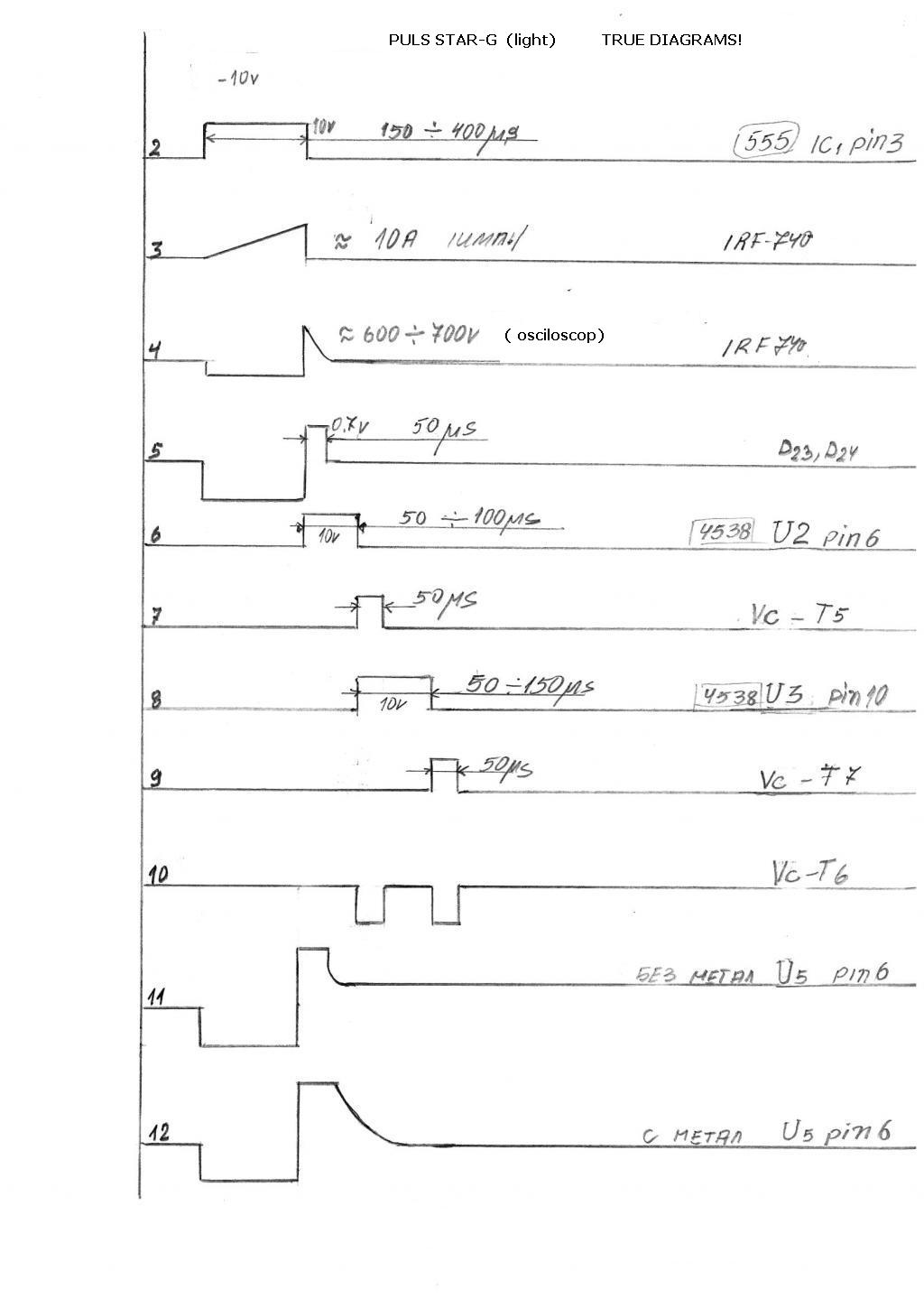

                            ok finally i think give true resuts, but i can not understand why i dont see 600 or 700 volts on ifr740,look at the pictures,please
                            if ther are ok say to me, my oscope is 100MH

                              an other questuon about pin3 of ne5534.is it true?(or D3 and D4)
                              ok say to me if i have an error.

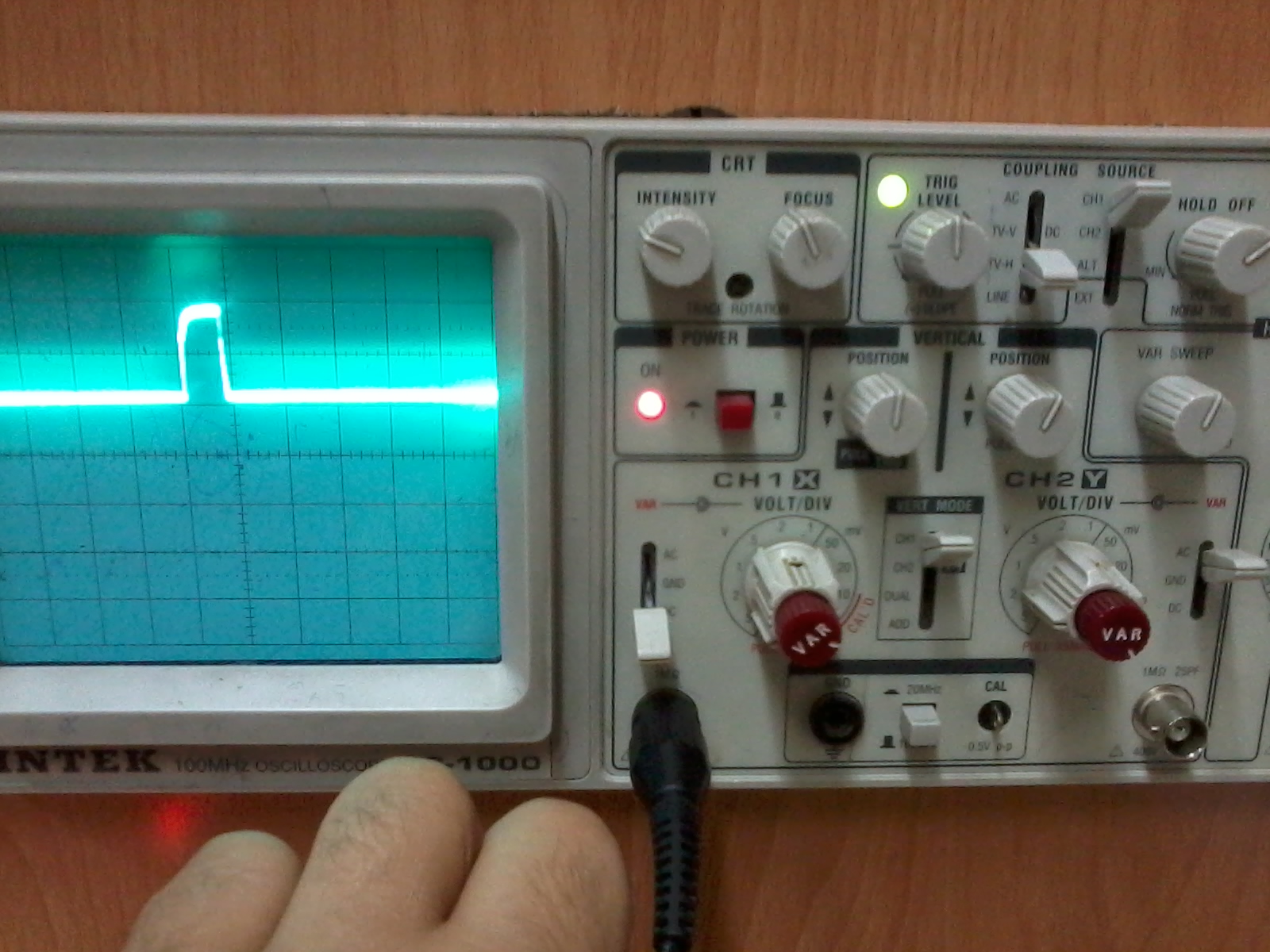

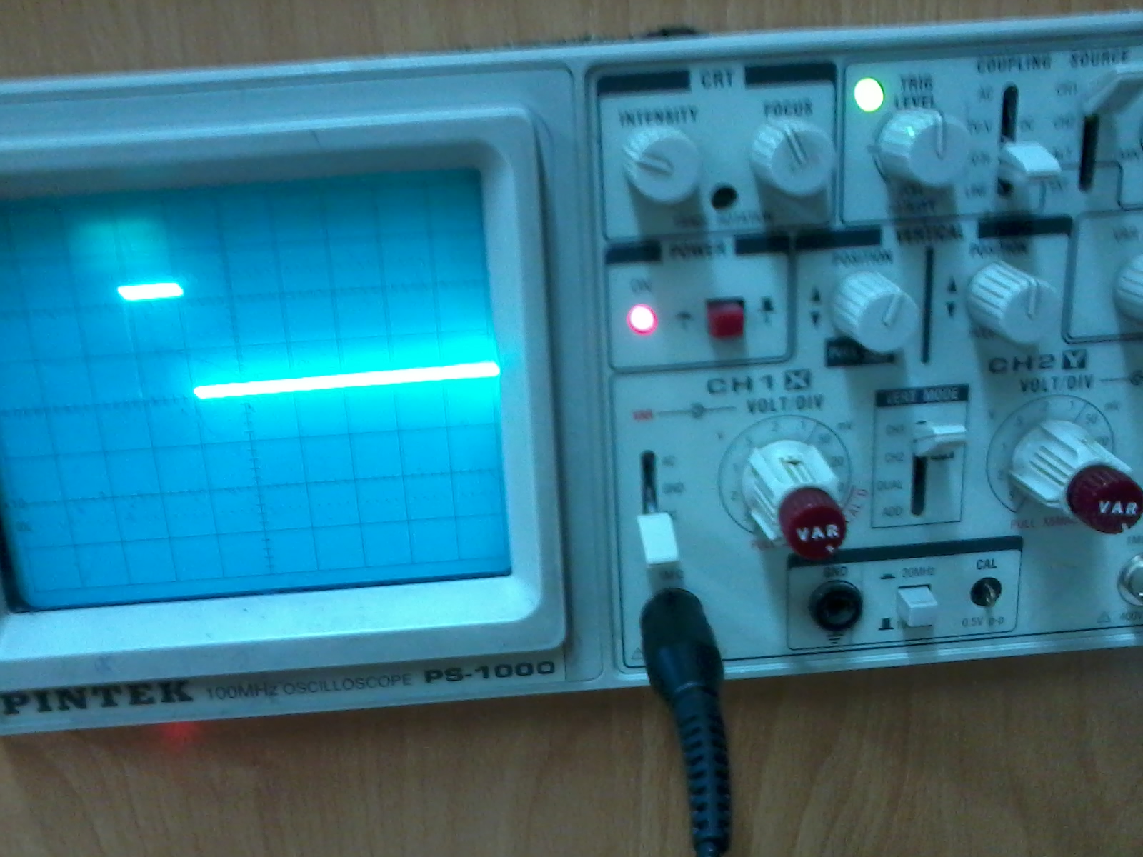

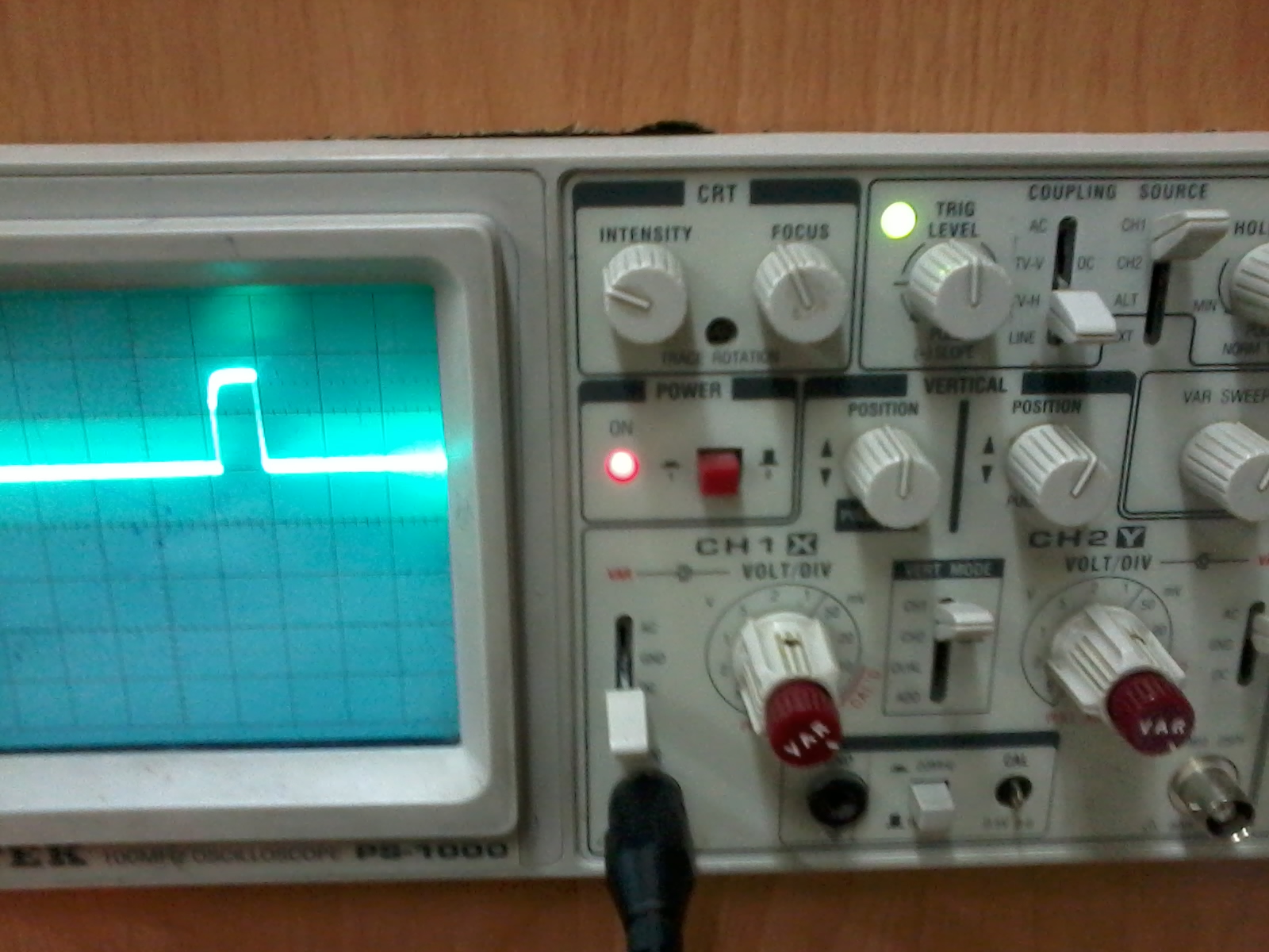

                                ok the last explain for The remaining picture discipline:
                                1-pin3 555
                                2-pin 9,10 4053
                                3-pin11 4053
                                4-pin6 4538(first 453
                                5-pin10 4538(second )
