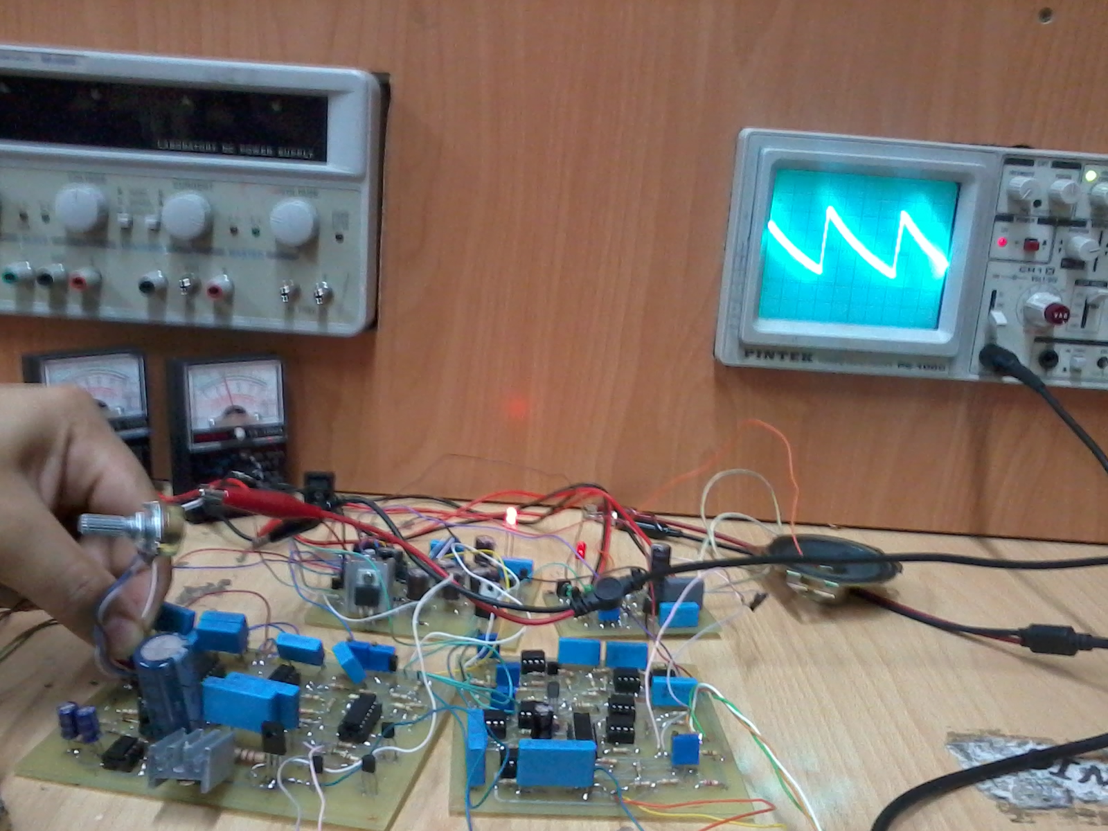

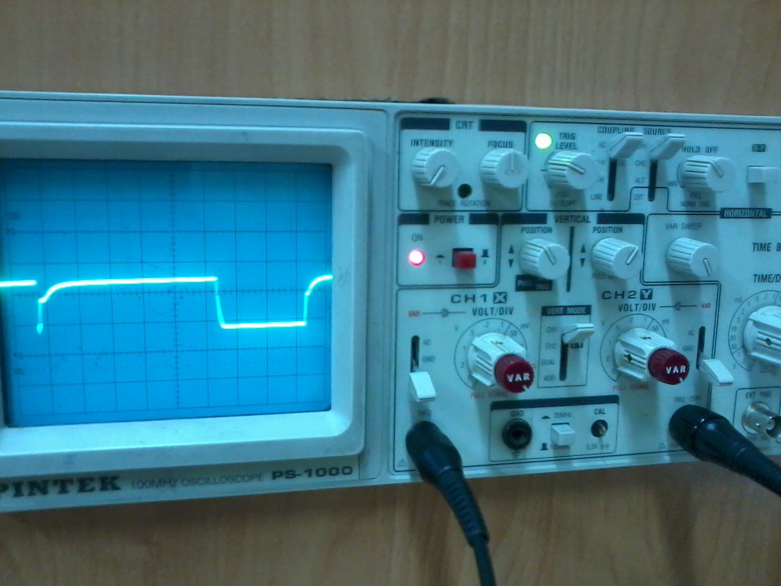

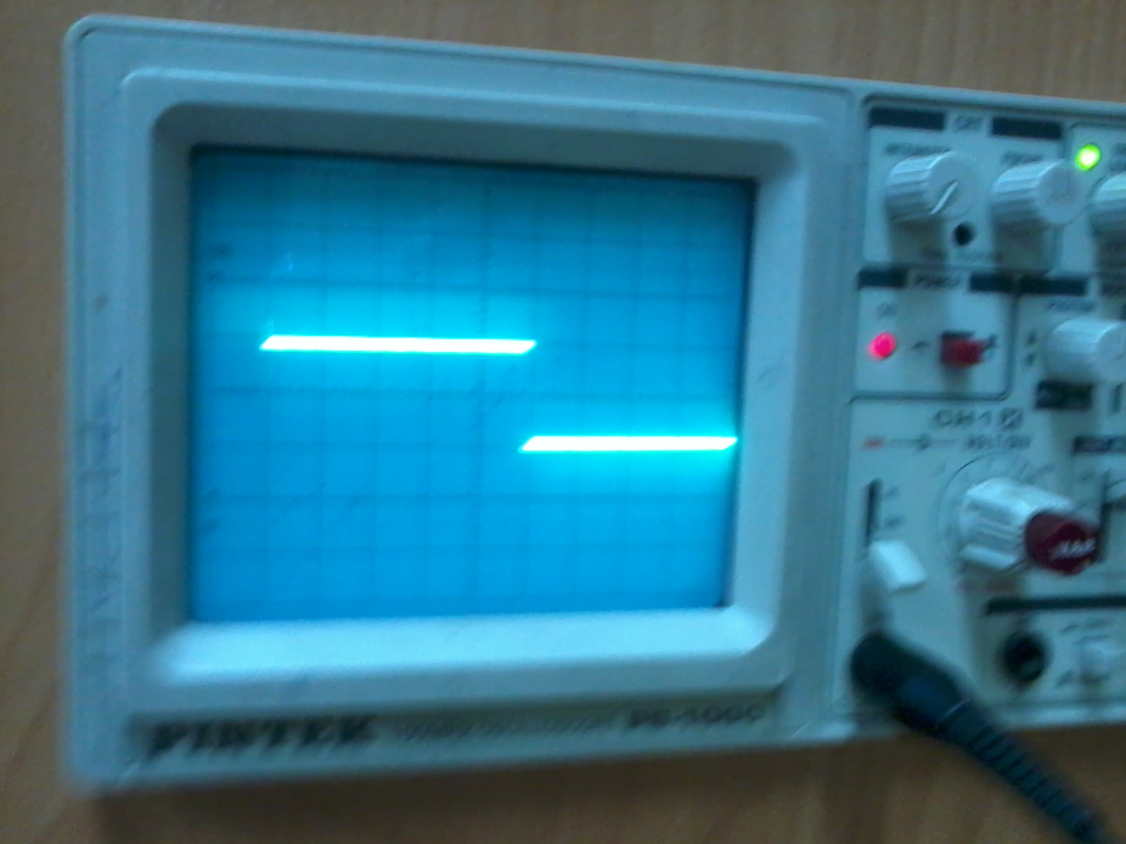

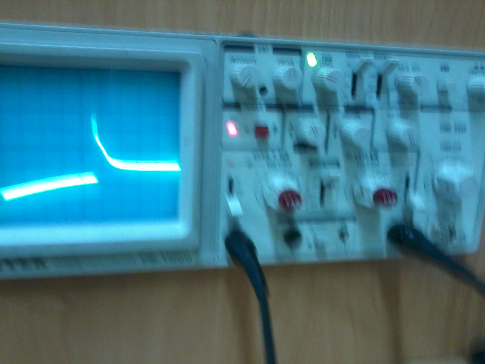

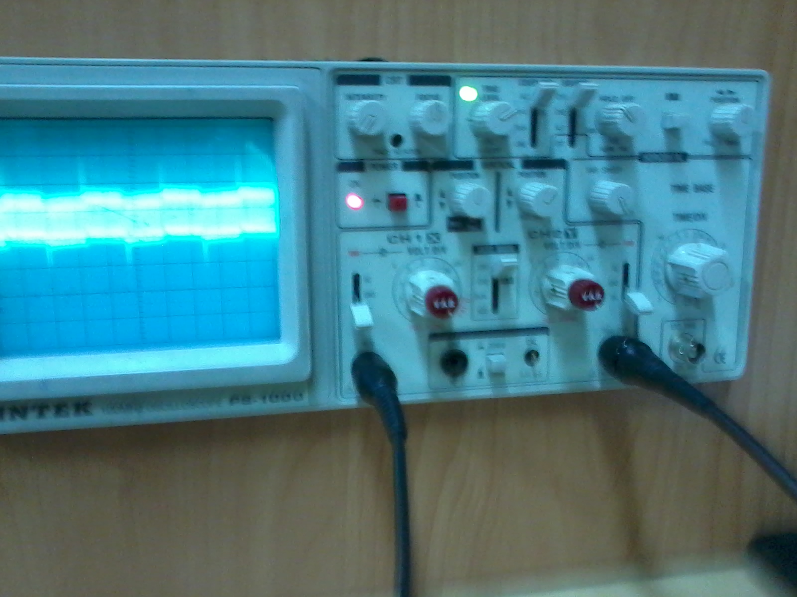

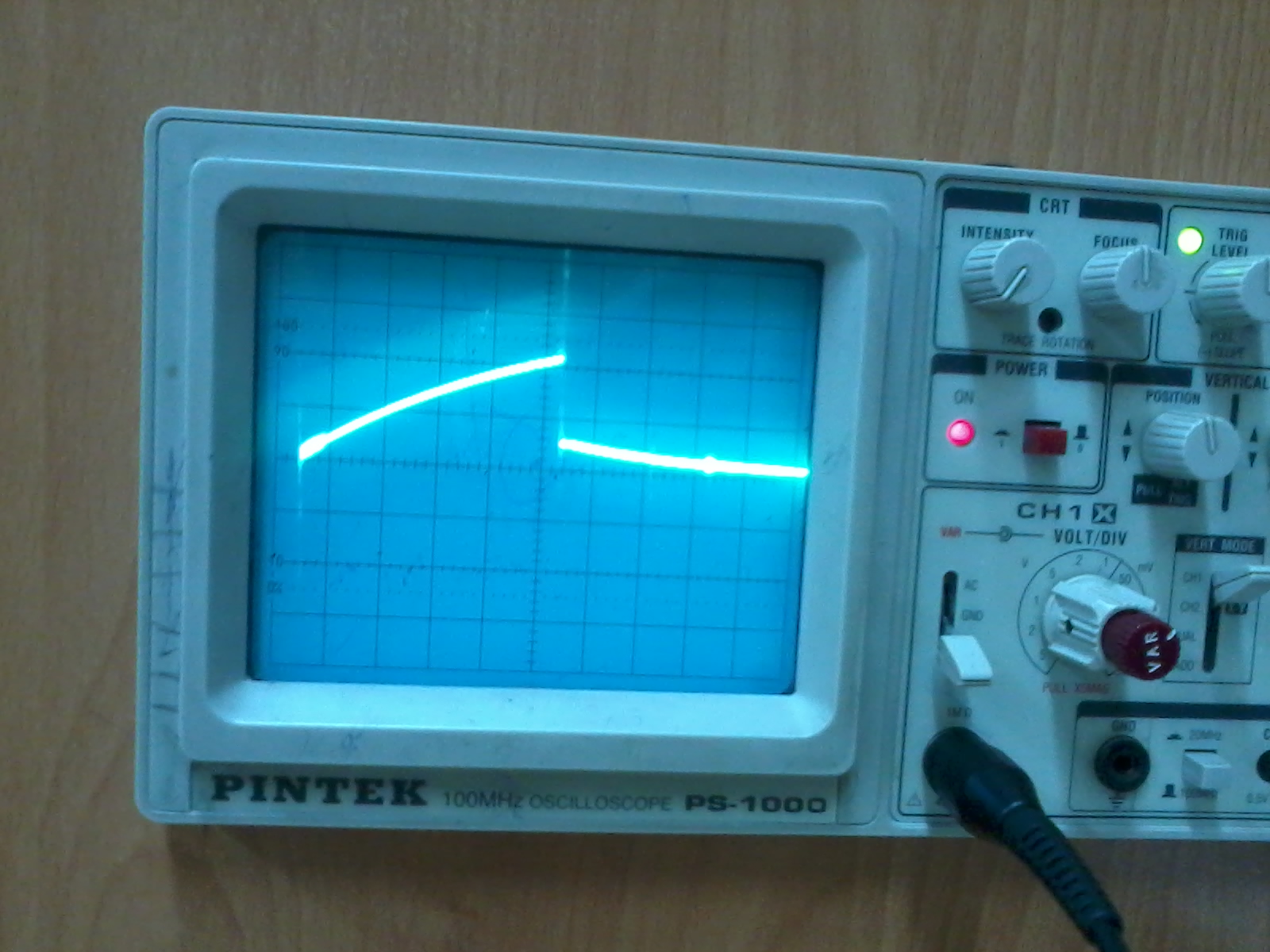

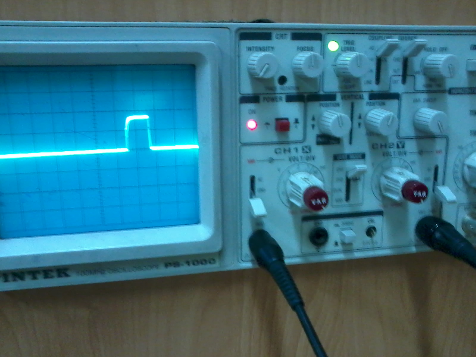

                  Hi daer georgi
                  i read all 20 pages of ps g detector several times and write every think i need ,thank you.
                  but befor you say i again go collage and test my pcb With search coil.
                  this is amazing becuase i test it befor and good work but today not well.

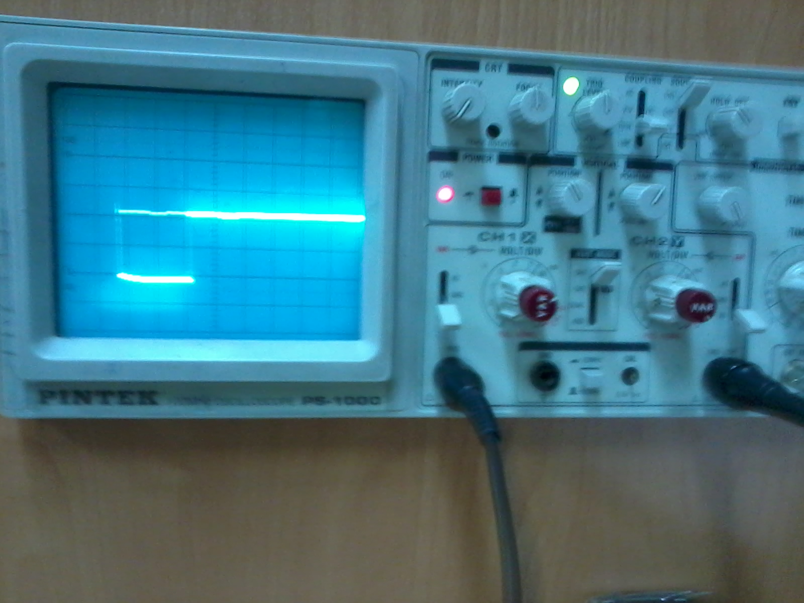

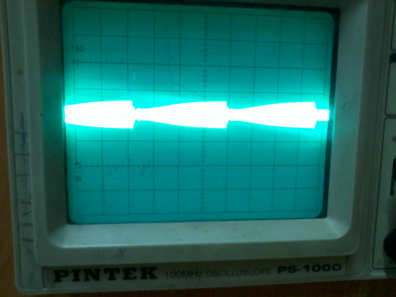

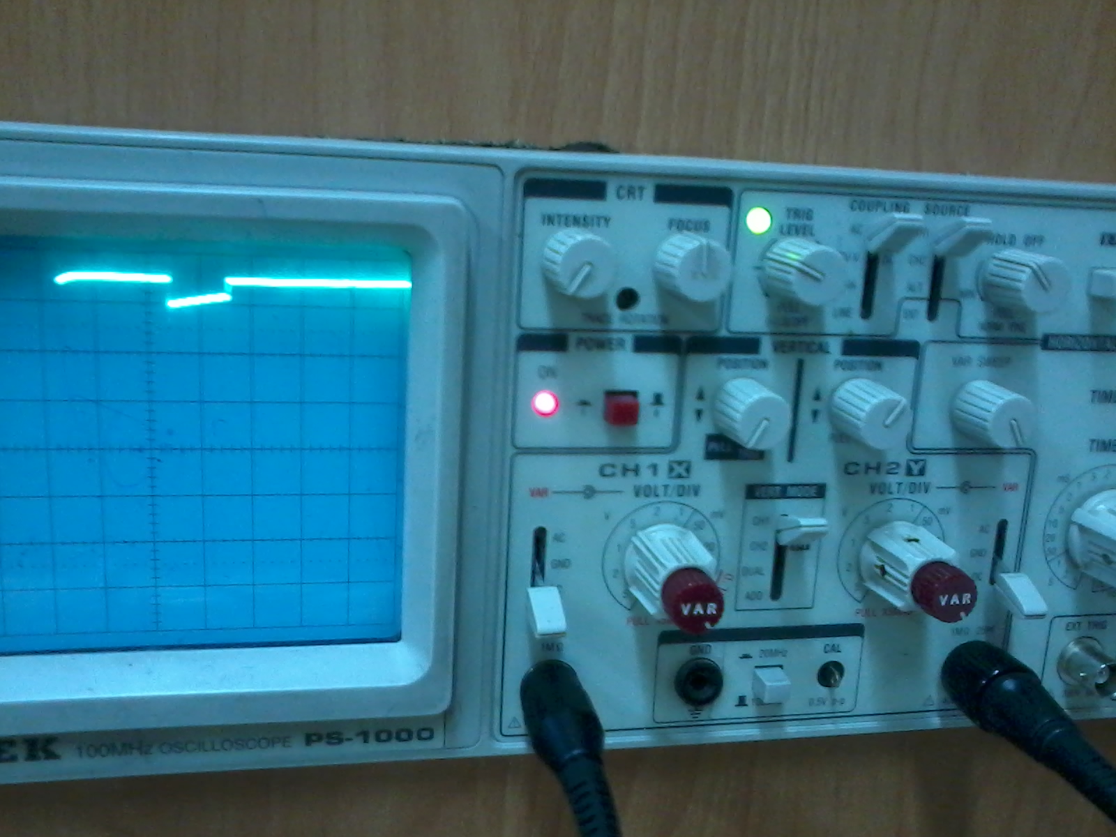

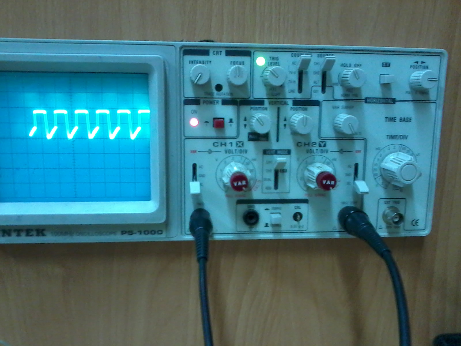

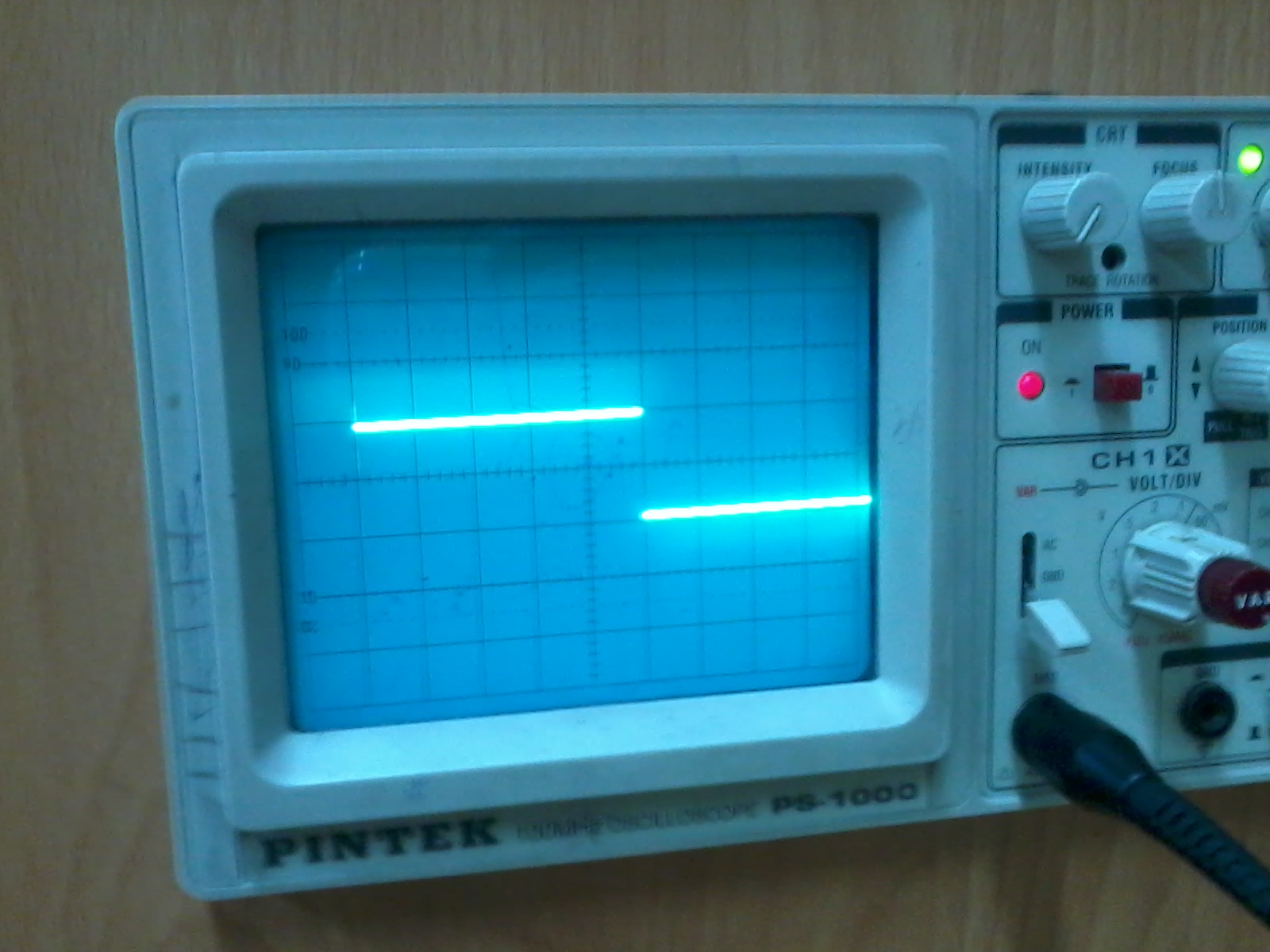

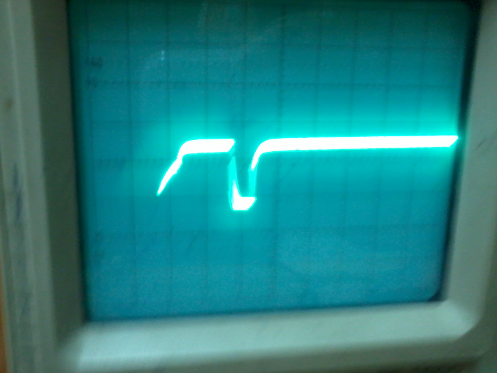

                  1-i set pin2 555 in 8.33ms for duty (T) or 120hz.next i set pin3 555 on 150Us (pulse width)
                  2-i check pin9,10 4053 was and good.BUT pin6 4053 have a problem(i put the picture).and pin11 4053 have Terrible out put(like Modulation & i put this picture)
                  3-set pin6 first4538 (but i set the duty cycle by multi tern relate to Delay,why ?) and pin 10 second4538 was good.
                  4-It is emportant set but i have bad figure in osope for ne5534 in pin 3 and pin6 whether Without coil and With coil.i put the mlti turn on 27k and when i measure pin6 the value not -0.2volt,how i adjust that.?
                  5- It was interesting when i set the second pcb i Effort to set the third pcb(TP points you say georgi to alexsis)but dont work adjustment on this,why?
                  and...
                  iam not Tired soon.
                  exuse for my english
                  i wait to your help my friend davor and georgi

                      • #71
                        explain for above:
                        first picture and twain end piture is for pin2 555.
                        second and third picture for pin3 555.
                        forth picture for pin9 4053

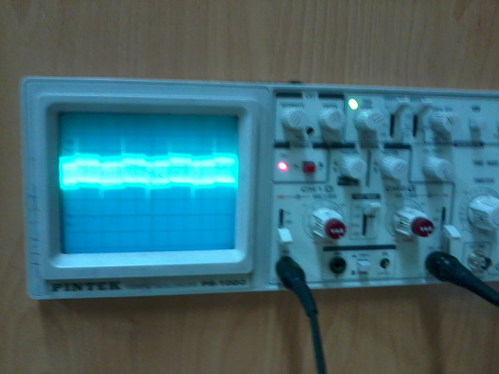

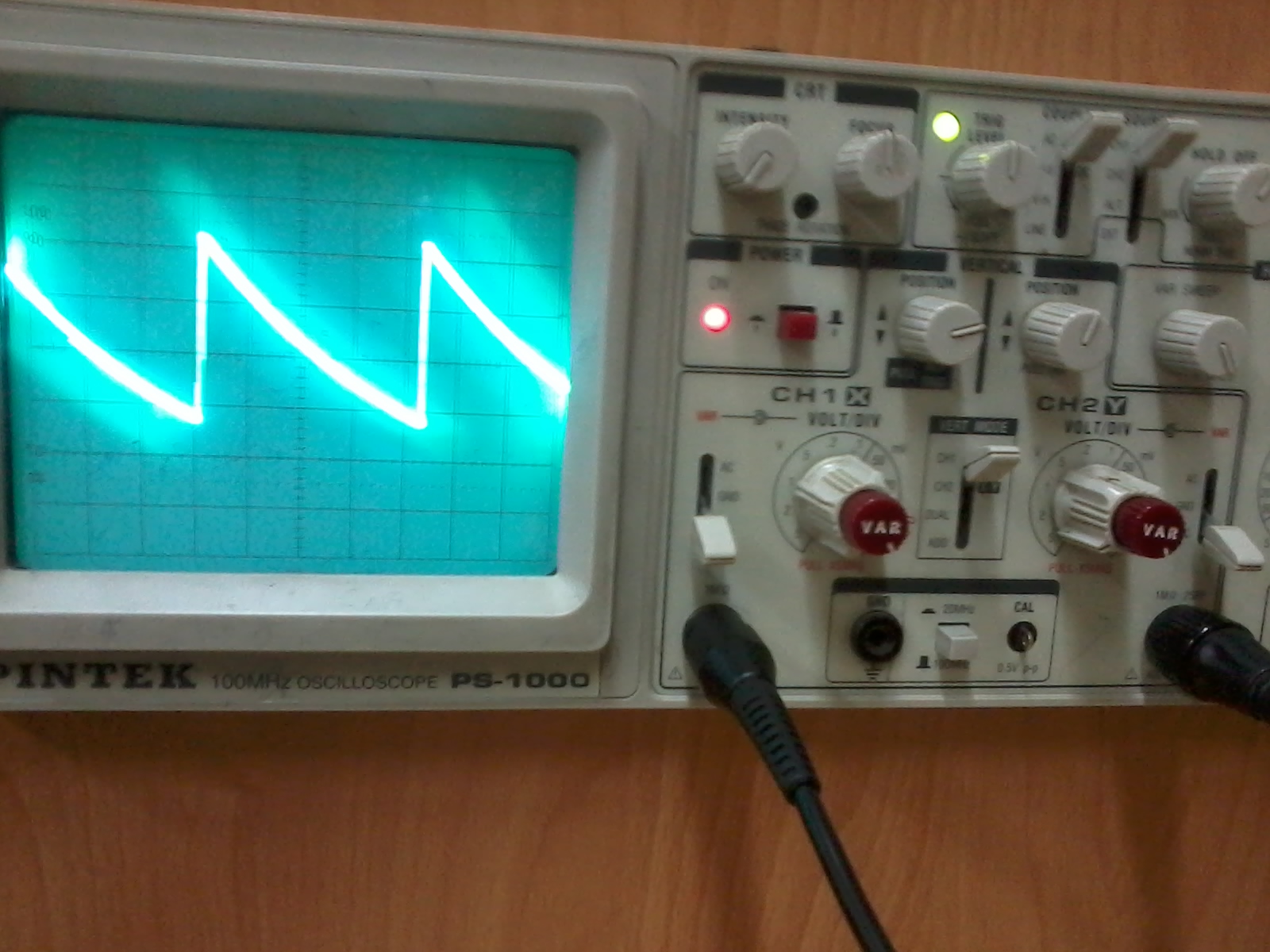

                        • #72
Name:	2013-04-18 16.52.54.jpg
ID:	335884Click image for larger version
Name:	2013-04-18 16.19.25.jpg
ID:	335885Click image for larger version
Name:	2013-04-18 16.28.49.jpg
ID:	335886Click image for larger version
Name:	2013-04-18 16.28.57.jpg
ID:	335887Click image for larger version
Name:	2013-04-18 16.30.26.jpg
ID:	335888Click image for larger version
Name:	2013-04-18 16.52.50.jpg
                          • #73
                            explain fpr abov epictures,attention No connection coils:
                            first and final picture for pin10 second 4538
                            scond for pin6 4053
                            third and Fourth ,pin11 4053
                            and fifth picture pin6 ne5534

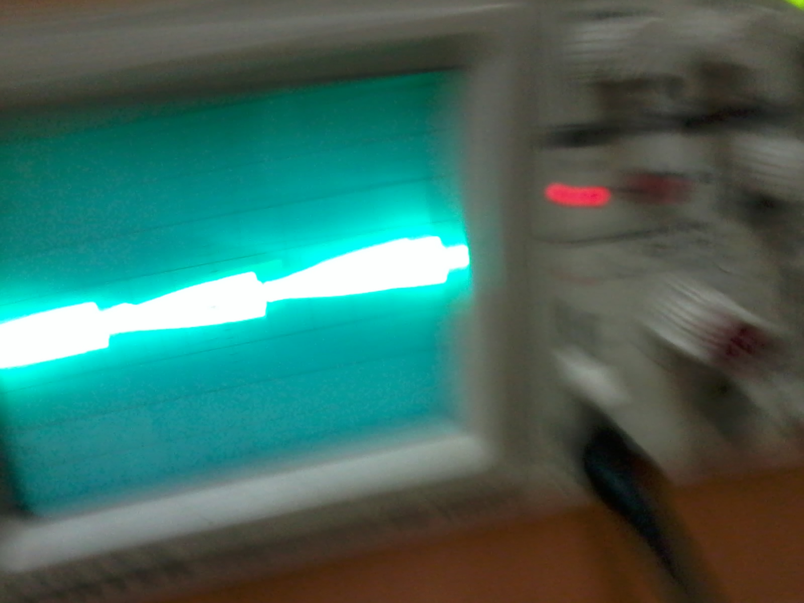

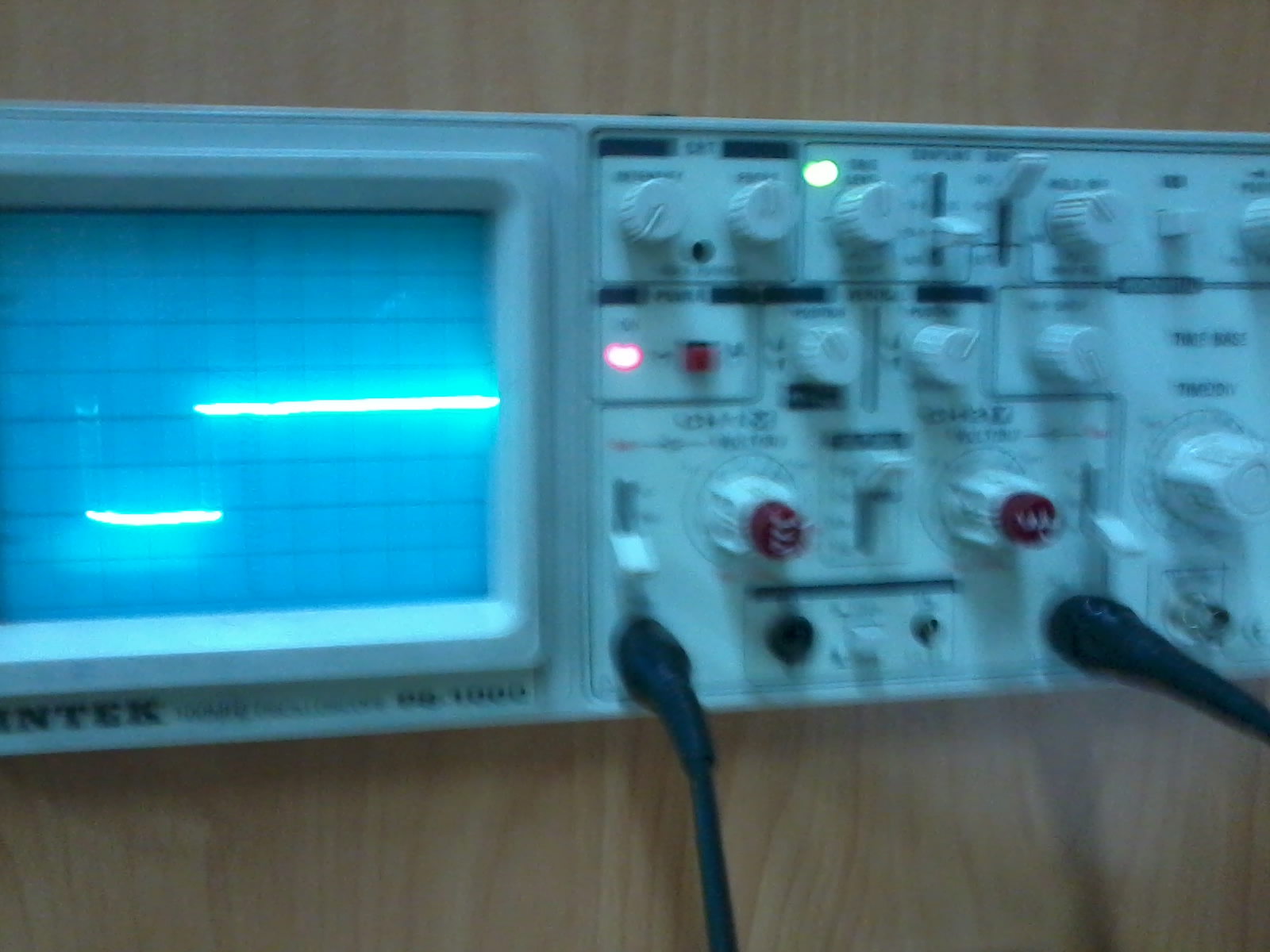

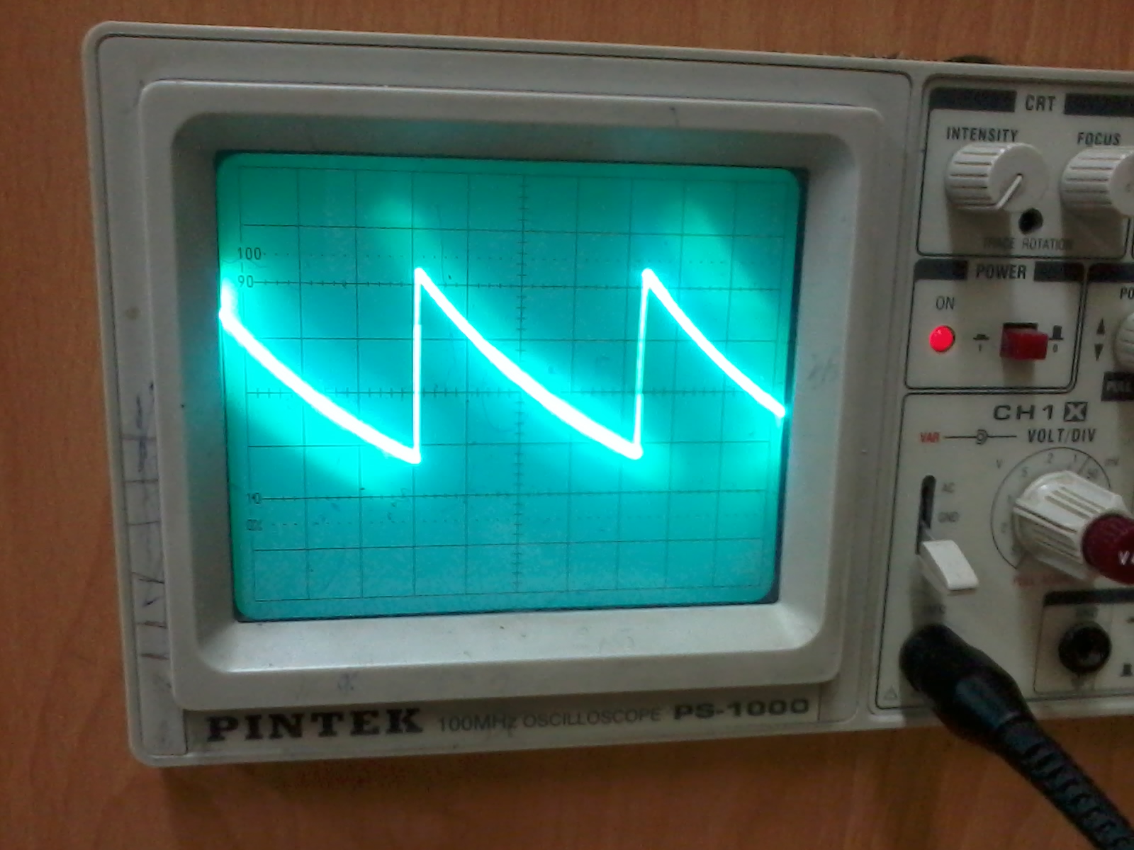

                            • #74
Name:	2013-04-18 16.57.33.jpg
ID:	335890Click image for larger version
Name:	2013-04-18 16.59.48.jpg
ID:	335891Click image for larger version
Name:	2013-04-18 17.07.01.jpg
ID:	335892Click image for larger version
Name:	2013-04-18 17.20.13.jpg
ID:	335893Click image for larger version
Name:	2013-04-18 17.20.16.jpg
ID:	335894Click image for larger version
Name:	2013-04-18 17.26.22.jpg
                              • #75
                                when i connet the coil and again measure
                                first picturepin3 ne5534
                                second picture pin6 4053
                                third anf fourth and fifth pictures for pin6 ne5534
                                final for pin10 4538(volt/div=50mv and tim/div=50Us)
