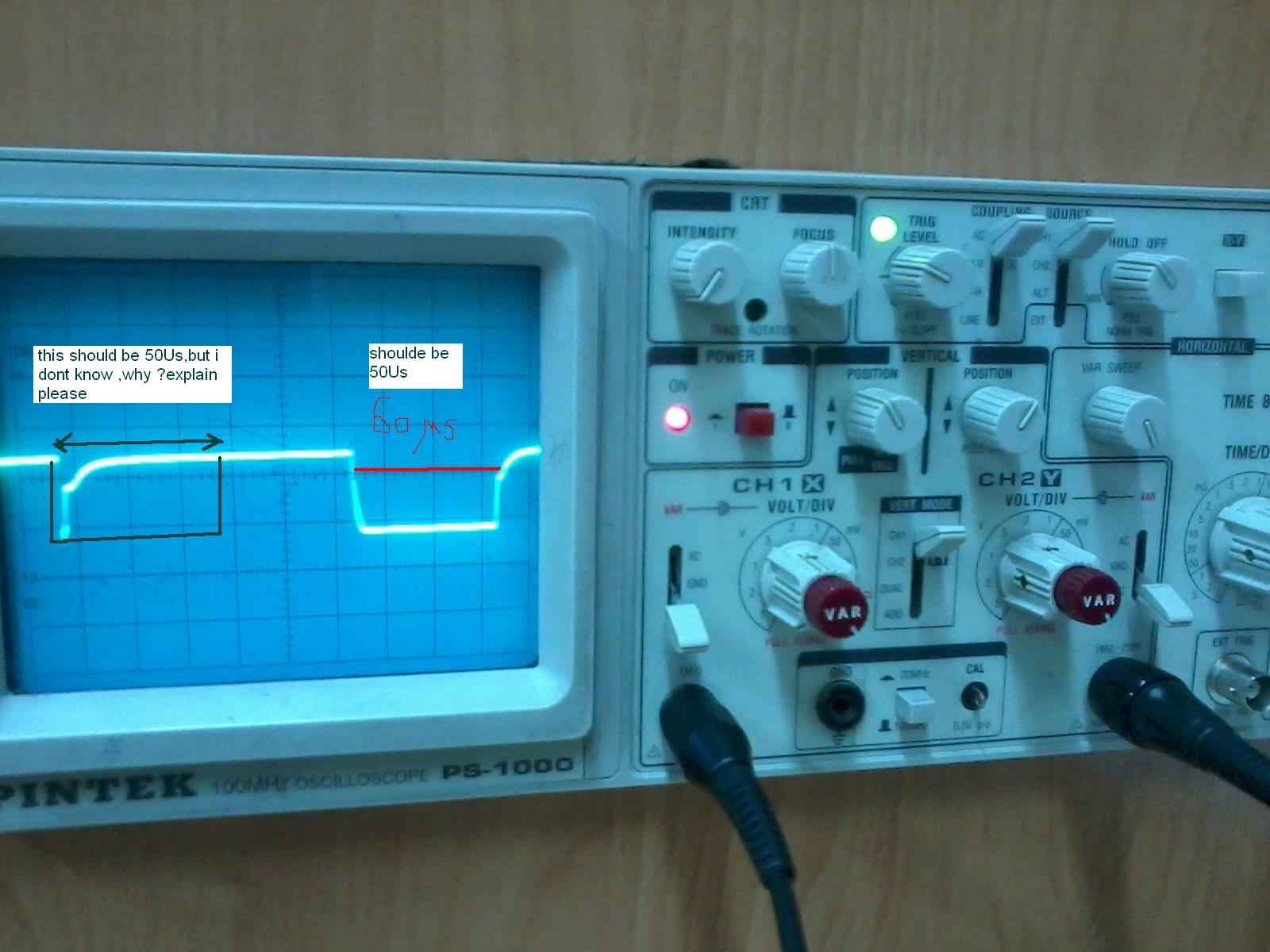

    look at this this is pin6 4053
    If this is OK, and you have no pulse on 4053 pin 11.
    nearly pin6 is ok(i think) BUT you Careful whether with 4053 and without 4053, look at this (like gnd wave), so i check teransistor,pcb and resistor are ok i am confused.
    ok finally i test again all parts and measure all waves by digital oscope(60MHZ)5 day latter,

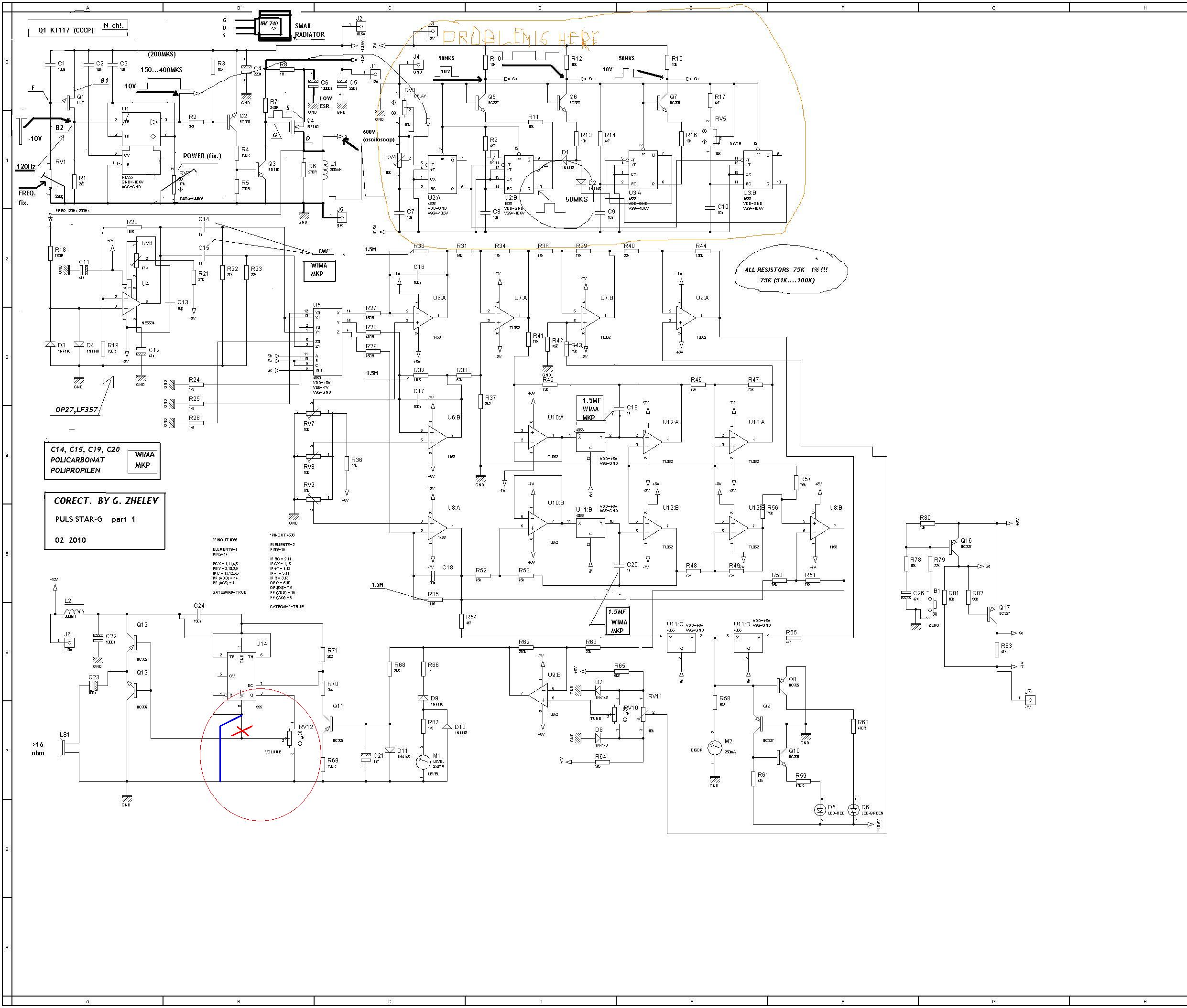

      Problem is here ! SEE shematics.Click image for larger version
Name:	СХЕМА П.С кор PROBLEM IS HERE.JPG

        • As georgi say, problem in timing part. I checked PCB, no visible errors, but recheck for accidental shorts etc. U3 “misfire” this first short pulse due to some reason. Try to isolate problem this way: pulses should look like on gregori's schematic, but 4538 have two complementary outputs, pins 6 \7 and 9\10, measure output, you will see identical signal, just inverted,if just one is wrong, trace that connection or replace chip. But before all this: RECHECK ALL UNUSED PINS,1,4,12,15 TO -10.6V, 3,13 TO GND. If left open, can mess up whole circuit operation. If this is OK, try to probe each MMV, what is on input (5,11) and what you get at output pins to isolate wrong one. Never mind WIMA, company, MKT is just type, fine if value is correct.

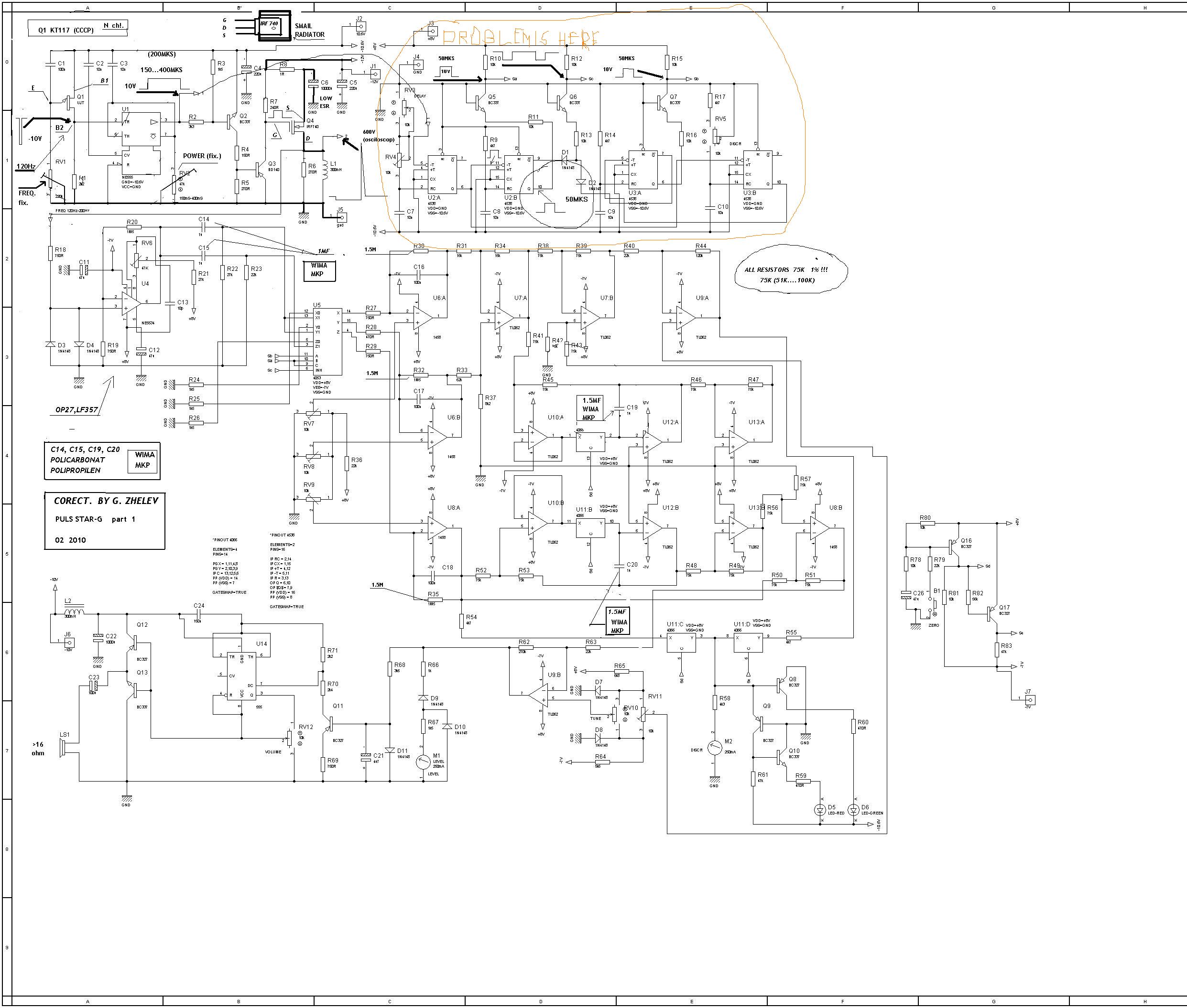

            • SEEshematics.Click image for larger version
Name:	PS-G ZAHR.+GENER FINAL.JPG

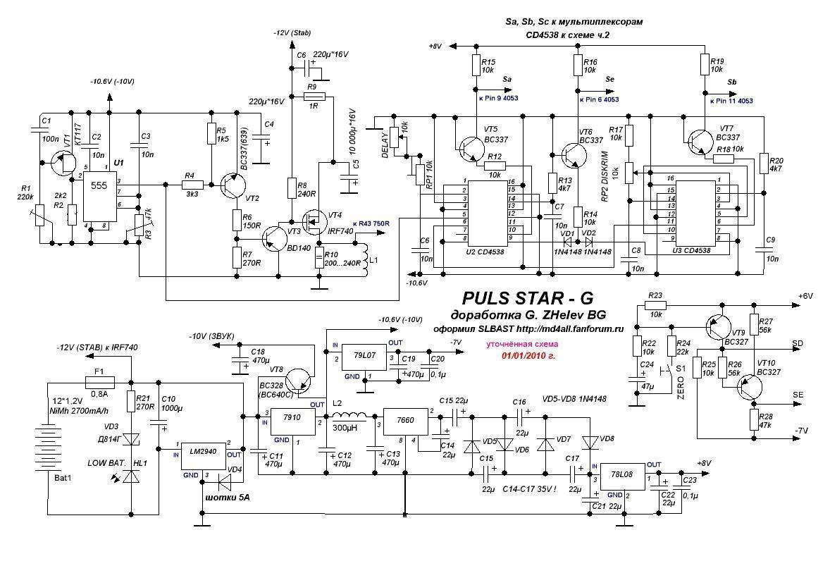

                        i replace all ices and check again pcb and measure by multimeter befor than i go to collage,and again write my result
                        for U2 :
                        pin 6 and pin10 and pin9have -10.8 volt and pin7 is -0.07volts
                        and the ferequency for pin6,7,10 are 115hz for pin9 is 135hz and ithink this ic is OK!
                        for U3:
                        pin 6 and pin10 and have -10.8 volt , pin9 and pin7 are 0 volts ,IS IT OK??????
                        and the ferequency JUST pin10 have 115hz , IS IT OK!(i dont this is my problem but how?i check all and not found it,any body knows my error and can tell me please,what do MULTI TURN in pin14?)
                        thanks just tell me for tomorrow i can give a good answer of me detect.i will go test it tomorrow please help and tell me U3 is ok or no?

                          who guys do know how can i solve the error on U3(or second 453
                          today again i go in collage just pin 10or 9 i think have pulse and pin6,7,9or10i think have not it.
                          and check all parts pcb ,out put of ne555 and ne 5534 are correct,i an adjustment pps and pw for ne555,and my out put in ne5534 change by multi meter on pin8,and for U2(first 453all out put (pin6,7,9,10)are Square wave and 10 volt.and an adjustment pin6 by
                          delay volume.
                          and just pin 9,10 and pin6 4053 are good(pin6 have little error for wave) but the pin11 is very bad.
                          i wait to one guru say me what is my wrong and if need say to me to put the pictures
                          thanks
