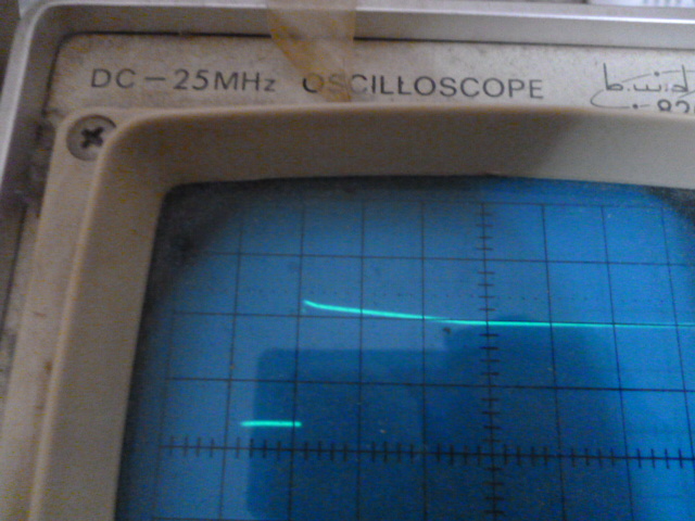

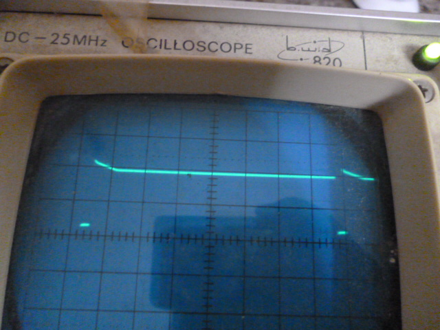

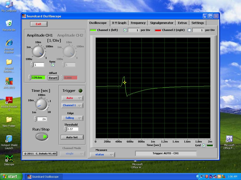

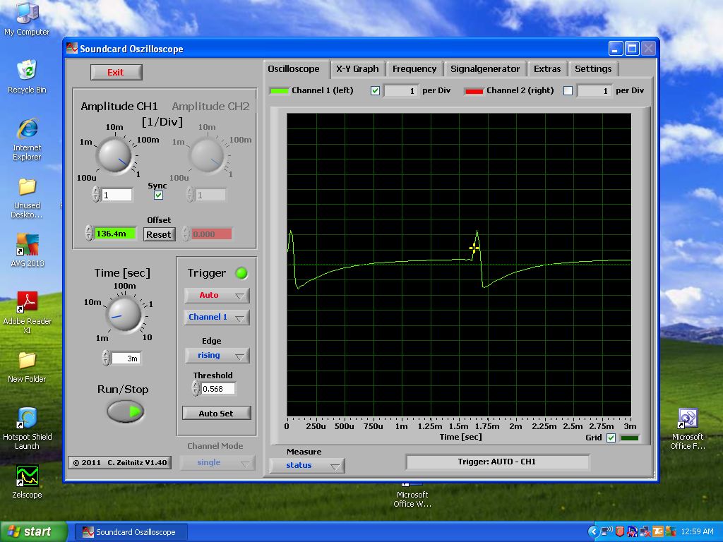

          With the small amount of testing and comparing waveforms with my real CRO and the software
          it is a bit disappointing with the results of the software, but still it was an interesting experiment.
          If my CRO is working correctly, the pulse on pin 3 on the 555 on my Surf PI is about 50 uS long
          you can see the difference in the pictures of the wave form I am seeing on my PC,
          it is not the same.
          This is single pulse 50uS.
            This is two pulses, oh well it was worth a shot.

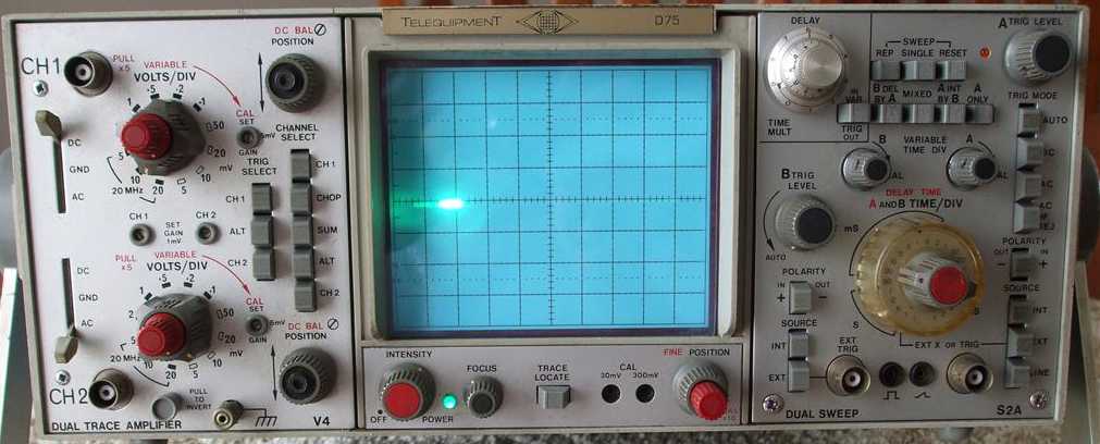

                I may be able to pick one like this up locally, vintage used and in good condition: Telequipment D75 50mHz
                http://www.grix.it/UserFiles/odoardo.../Teleq-D75.jpg I suppose that would work. However, it is rather old . . . so do not know what the mtce would be like.
                  Should do the trick. Could be close to the end of its life though so don't pay too much for it. mtce ? Metric Ton Carbon Equivalent? Depends how local and how efficient your car is I guess..
                    Is $75 too much?
                      At that price buy two of them.
                      Every CRO will father little children to every digital piece of equipment for the next 20 years or so. The best part - they are usually repairable.
