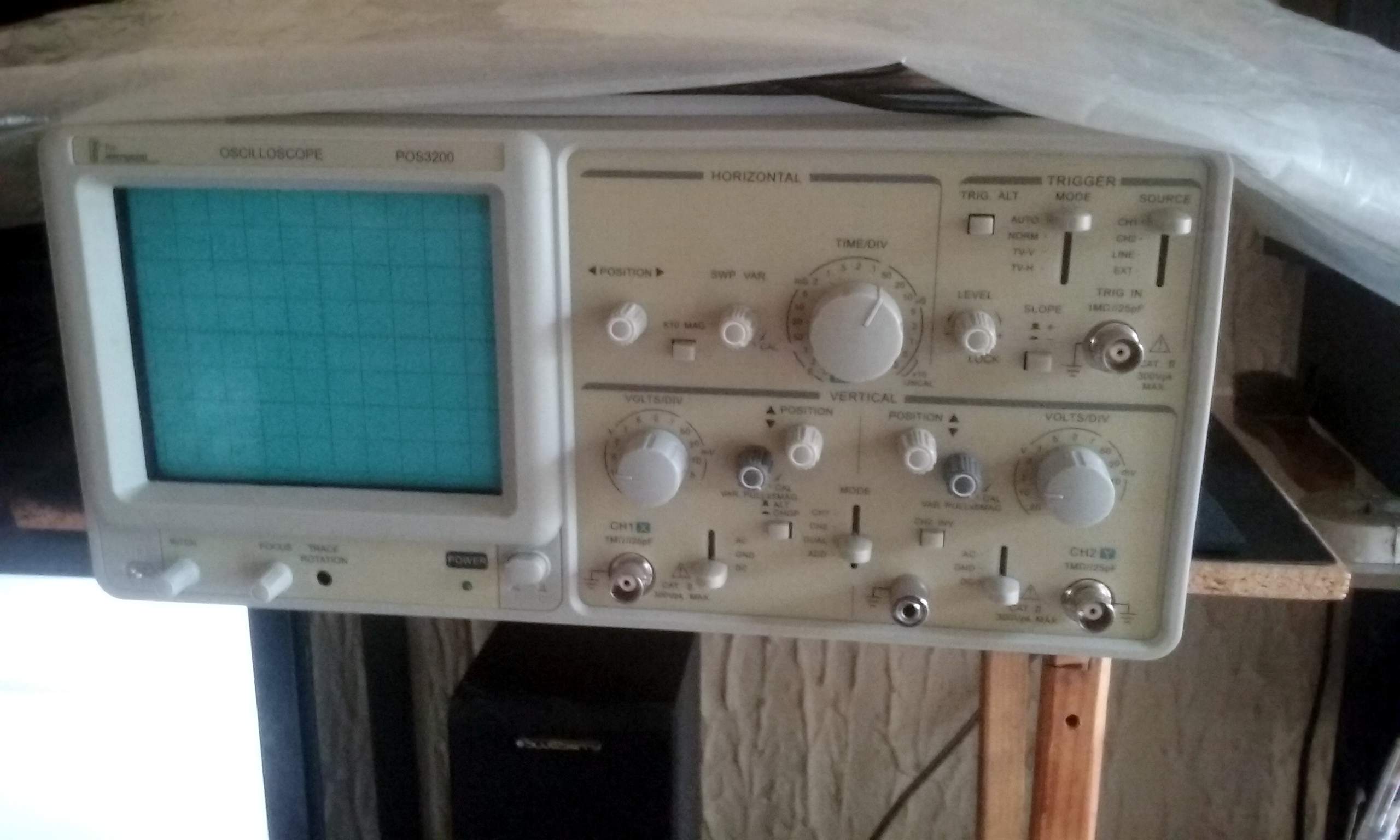

            A good friend helped me to obtain new oscilloscope the other day.
            Analog 2-channel 20MHz. Brand new one, made in China.
            POS3200 model.
            Finally i can measure the signals which i couldn't with several digital ones i had so far, from the lower price range.
            Overall i had probably dozen oscilloscopes so far in my "career". Mostly old obsolete models with very modest performances.
            I had pc based one too.
            If you want to buy digital one; be prepare to spend decent sum of money, because lower price range will not do what you expect from them.
            And on the other side; with very modest money you can obtain analog one which is capable to meet most of the demands.
            These days i am playing with this analog one with great joy. Finally i have "eyes" to see some things.

              ivconic, that looks like a decent one, where did you buy it, the pc ones gp for around $50 to $100 us on ebay, are they no good either, The hanteks model 6022b or something like that, there some youtube videos on it and it looks decent.

                They all decent for some purpose.
                But for measuring whats going on in metal detectors, especially in PI metal detectors; you'll need proper and capable instrument.
                I bought this one from local importer. Who import things from China.
                You can probably find it on Aliexpress, i haven't checked.

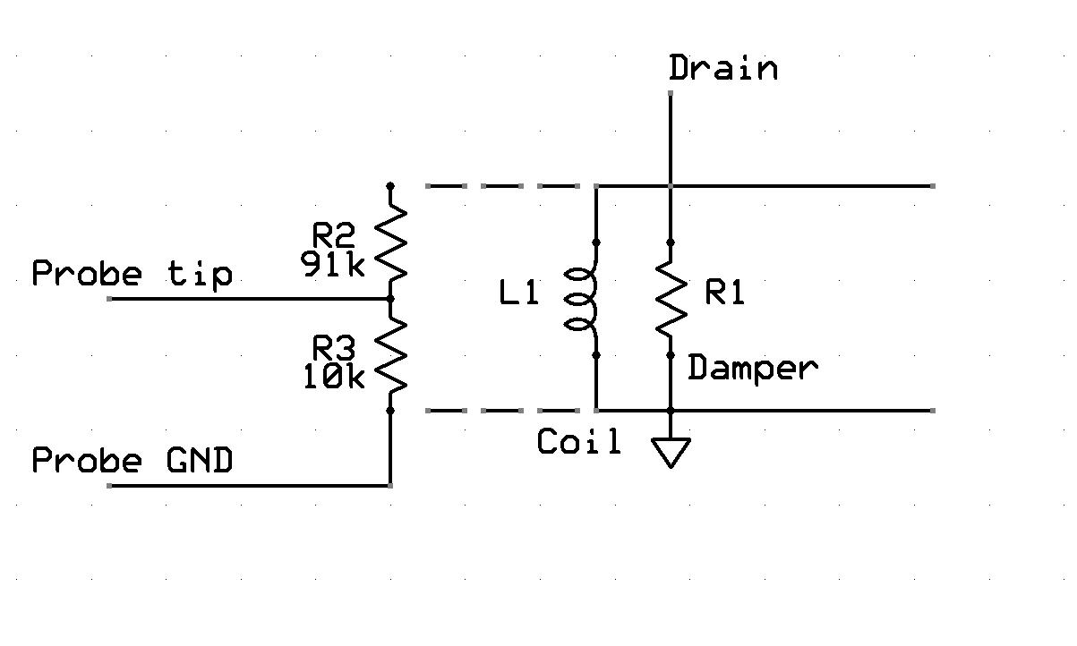

                          Yes, been looking, says 220 volt on aliexpress, would i just need higher voltage probes then for PI metal detector
                            You can always make simple voltage divider with resistors.

                              thank you
