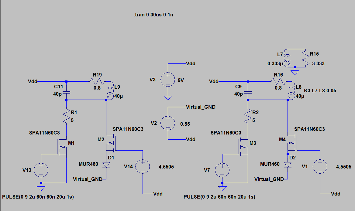

I have a solution for devices such as Minipulse, where damping resistor is a part of a feedback network. It could perhaps be improved, but even this way it enables using a simple trimmer to adjust damping on the go, which seem advantageous when experimenting with various coils.

In short: the simplest PI front-end with low-noise, high gain and single supply. Active component count is 6: 2 x MOSFET, 2 x bipolar, 2 x schottky diodes.

Thank you. I've never seen a current-mode PI detector and the concept seems promising. Think of it like this:Originally posted by green View PostLooks like you have a good solution,hope it works out for you.
- A 1 Ohm coil receiving a 1 mV signal will produce 1 mA if shorted.
- In order to get 1V from 1mV you need need a high-impedance amplifier with 1000x gain. If you use op-amps you can't get away with lees than 100K resistors - noisy! If you do it in stages it's also noisy.
- Now in order to get 1V from 1mA you just need a single 1K resistor. Simple an noise-free. What's more, it's a lot faster than an Op Amp.
You get the idea? And in both cases it's the same target!

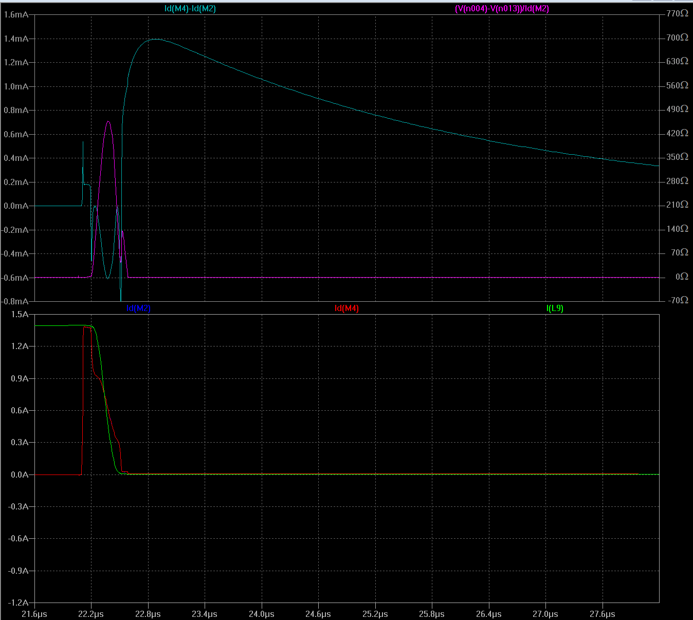

The Vds/Vgs characteristic of the MOSFET does a soft switching. When the Vds is high (coil transient) it works in the saturation region (high impedance), when it's low (end of transient) it enters the linear region (low impedance). Just connect the source to a virtual ground that can absorb the instantaneous peak current, this woud be the virtual ground at the input of a trasconductance amplifier. The target's current I enters virtual ground and a voltage R x I is available at the amplifier's output.Originally posted by Davor View PostInteresting idea. So active damping is used simply to quench the coil response, and you expect to obtain some transformation of target responses by means of switching between a shorted coil and high impedance.

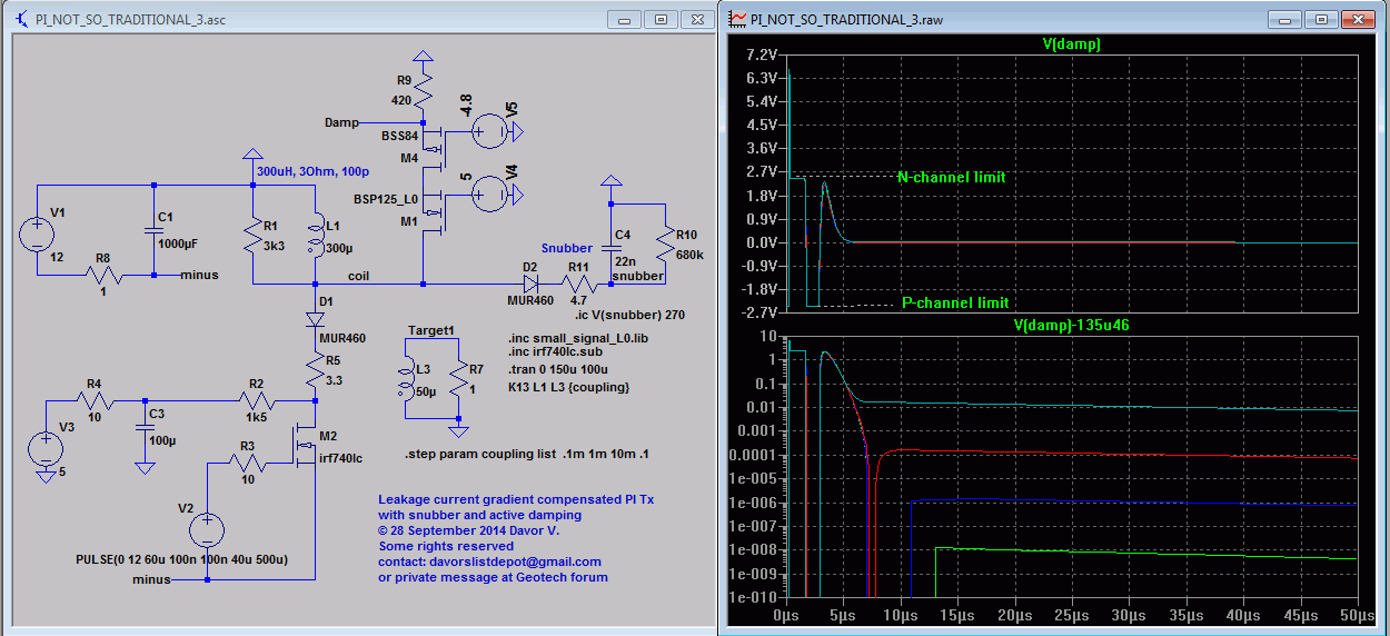

I'm still unable to simulate this. You are aware that you'd need to quench the coil's own response prior to taking a target sample? That means you'd have to use a third impedance that is equal to the critical damping while the coil's own response dissipates, then enter a short circuited stage, and lastly the high impedance stage. Otherwise you'd have weak targets masked by the coil's own response.
The active damping is tuned to absorb exactly the amount of energy stored in the coil with no target. Any target alters the energy balance, so the residual energy after active damping belongs to the target.Originally posted by Davor View PostI'm still unable to simulate this. You are aware that you'd need to quench the coil's own response prior to taking a target sample? That means you'd have to use a third impedance that is equal to the critical damping while the coil's own response dissipates, then enter a short circuited stage, and lastly the high impedance stage. Otherwise you'd have weak targets masked by the coil's own response.
Here's a simulation setup:
damping.zip
The resistance of the damping MOSFET (trace: (V(n004)-V(n013))/Id(M2)) peaks at 458 Ohms in the middle of the transient and goes down to 0.42 Ohms when the target signal (trace: Id(M4)-Id(M2)) is at a maximum. The difference target/no-target is 1.4mA after the transient. In practice you have an offset of 5.4mA (Id(M2) biasing) , so your target is the difference between 6.8mA and 5.4mA. Offset can be reduced using a constant current sink set around 5.4mA.

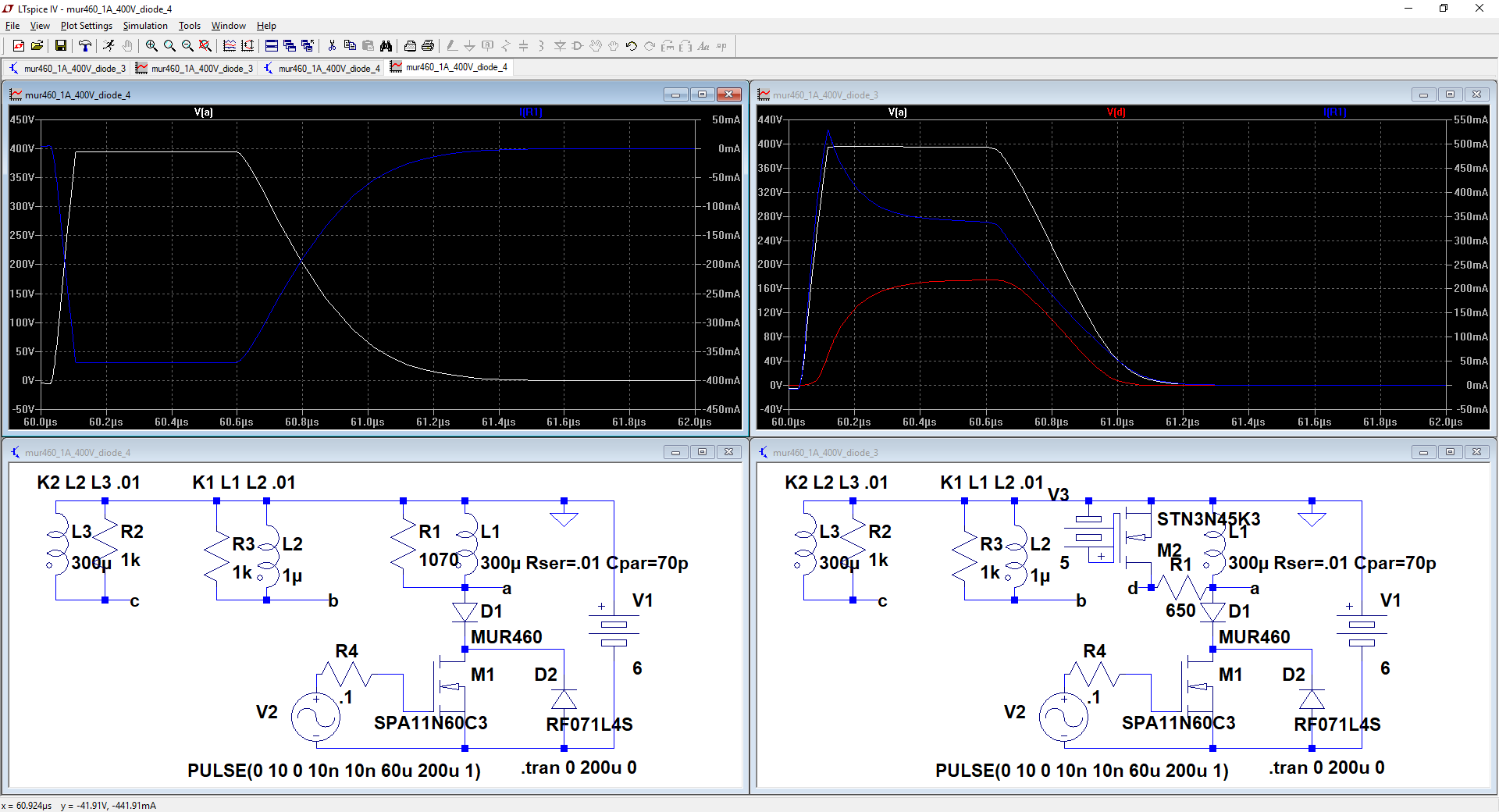

Finally got active damping with spice to maybe look better than critical damping. Have tried some in hardware that didn't work, haven't tried this circuit yet. Wondering if anyone is using active damping that would share there circuit.Attached Files
Lowered R1 to 65 ohms(limits current M2 when Tx on). Can adjust gate volts to get a good looking signal but gate volts setting is a lot more sensitive. Have you tried a similar circuit with hardware? Is temperature a problem? Everything I've tried so far in hardware isn't as good as critical damping.Originally posted by Teleno View PostRemove R1, it slows the decay. Tune Vgs of M2 instead to achieve optimum decay rate.
The gate voltage is indeed very sensitive to temperature, you need a feedback loop to control it.Originally posted by green View PostLowered R1 to 65 ohms(limits current M2 when Tx on). Can adjust gate volts to get a good looking signal but gate volts setting is a lot more sensitive. Have you tried a similar circuit with hardware? Is temperature a problem? Everything I've tried so far in hardware isn't as good as critical damping.
