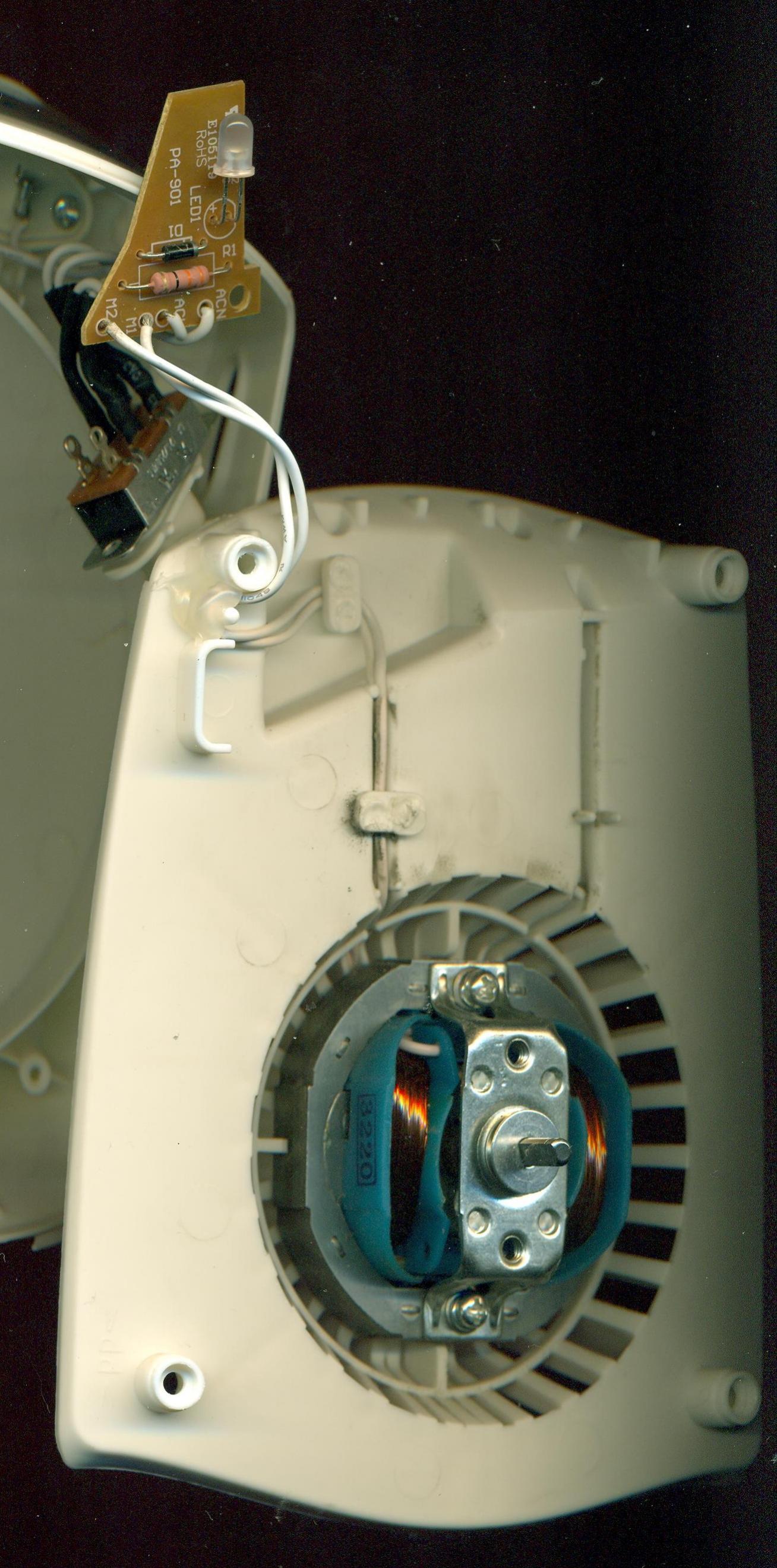

      Here's the top-side view of the PCB, showing the LED, resistor and diode.
      Does this help you make a determination of what could be causing the 027 meter reading to be the same, regardless of whether the meter test leads are touching the diode leads the correct way and then reversing the test leads ?
      In reference to the picture of the underside of the PCB in my previous post #15, I assume you can see the circuit tracks plainly enough when you double-click the attachment.

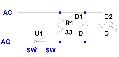

        This is the circuit as I see it.

        So the resistor and diode are in parallel. You are just measuring the resistor.
          CAS,
          As near as I can determine, it appears your circuit schematic agrees with the PCB circuit at my end.
          So I guess you are indicating that when I'm testing the diode with the meter set in the diode position and the meter leads touching the diode leads positive to anode and then switching the positive test lead to cathode, that the 027 meter reading is a false reading....right ?
          If you agree with the above statement, then do you also agree that I would have to clip one of the diode leads and re-test to get a true diode test, i.e. current flow blocked in one direction, but not in the other direction ?
          Bottom line, for my "testing diodes project", me thinks I'll just go buy an assortment of diodes to play with, rather than clip a diode lead on my PCB. As mentioned previously, the LED is working, so I'm going to assume that the rectifier diode is good.

              The only puzzling thing here is the 027 reading, and appears to be a resistance value (close to 33Ω). However, in the diode test mode, I would have expected to see a voltage reading on the meter of around 0.7V. Perhaps this a feature of the meter. i.e. if it cannot detect a diode, it shows the resistance value.

                  The 33 ohm resistor is i parallel with the diode. If you measure a 33 resistor with the diode range thats the figure I would expect. A lot of SMPS seem to have resistors in parallel with diodes and fets etc which make it a pain when trying to fault find.

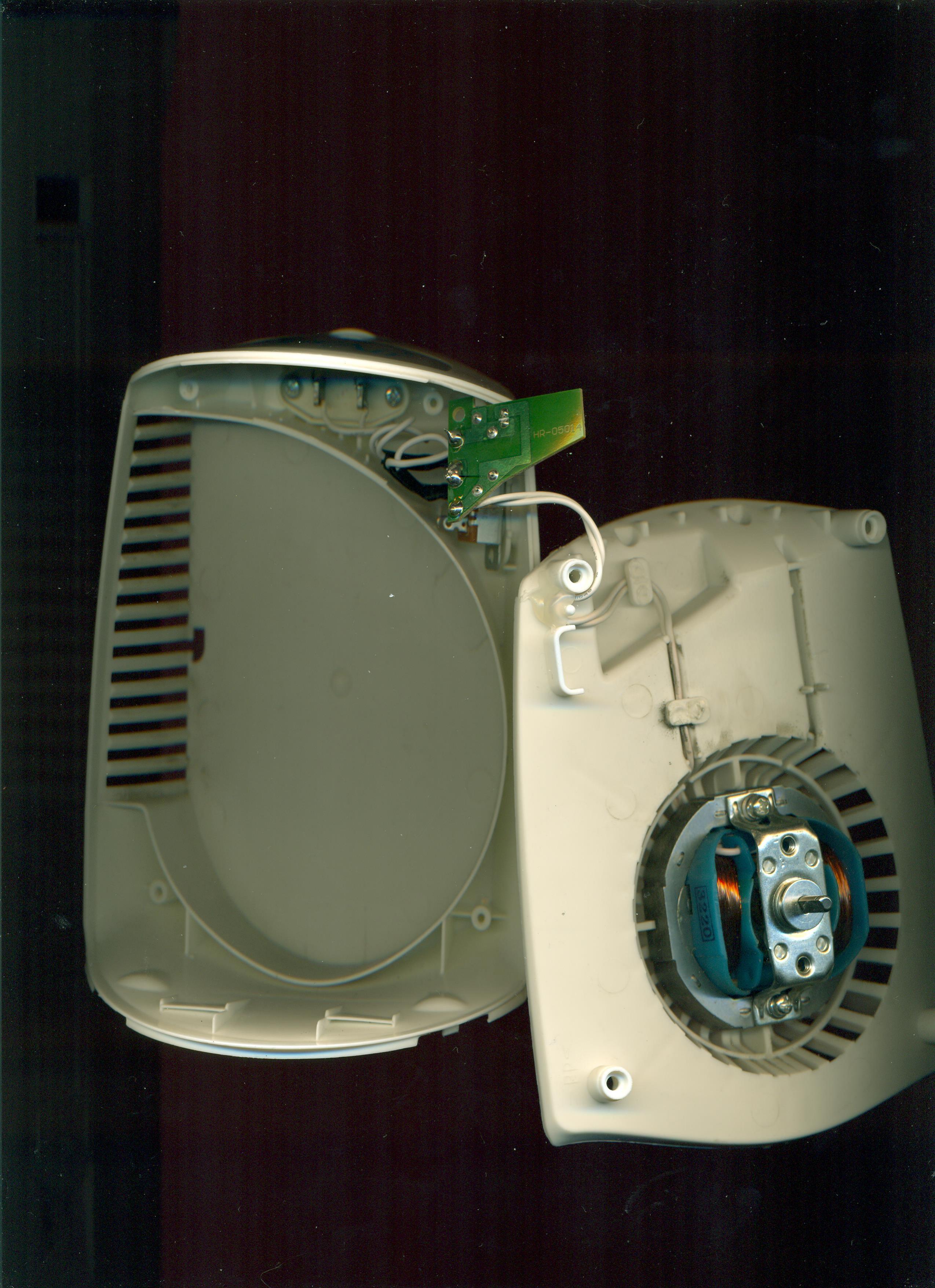

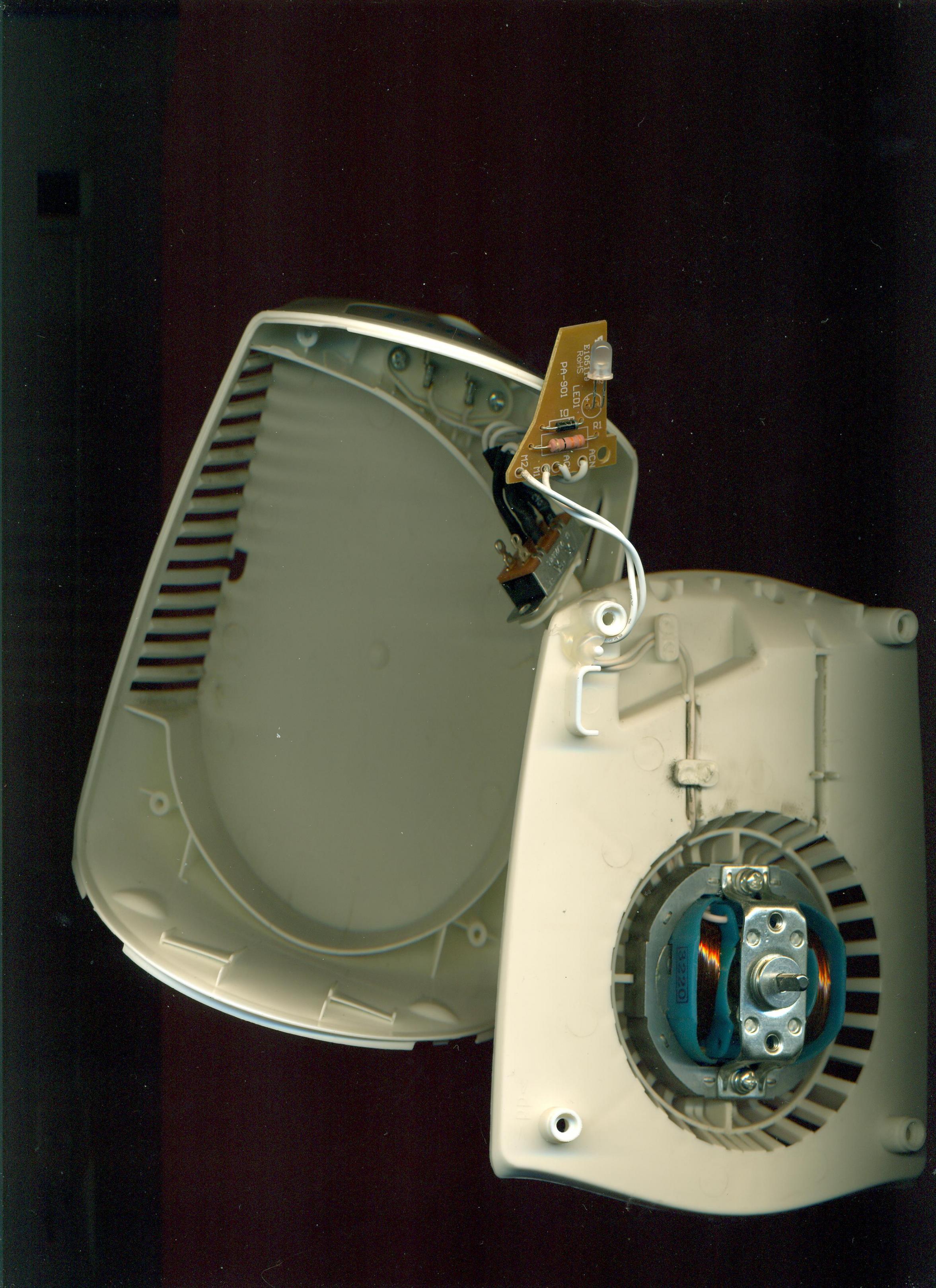

                          Attached are pictures of my fan, showing top and underside of the circuit board and the motor for your reference while reading the following.

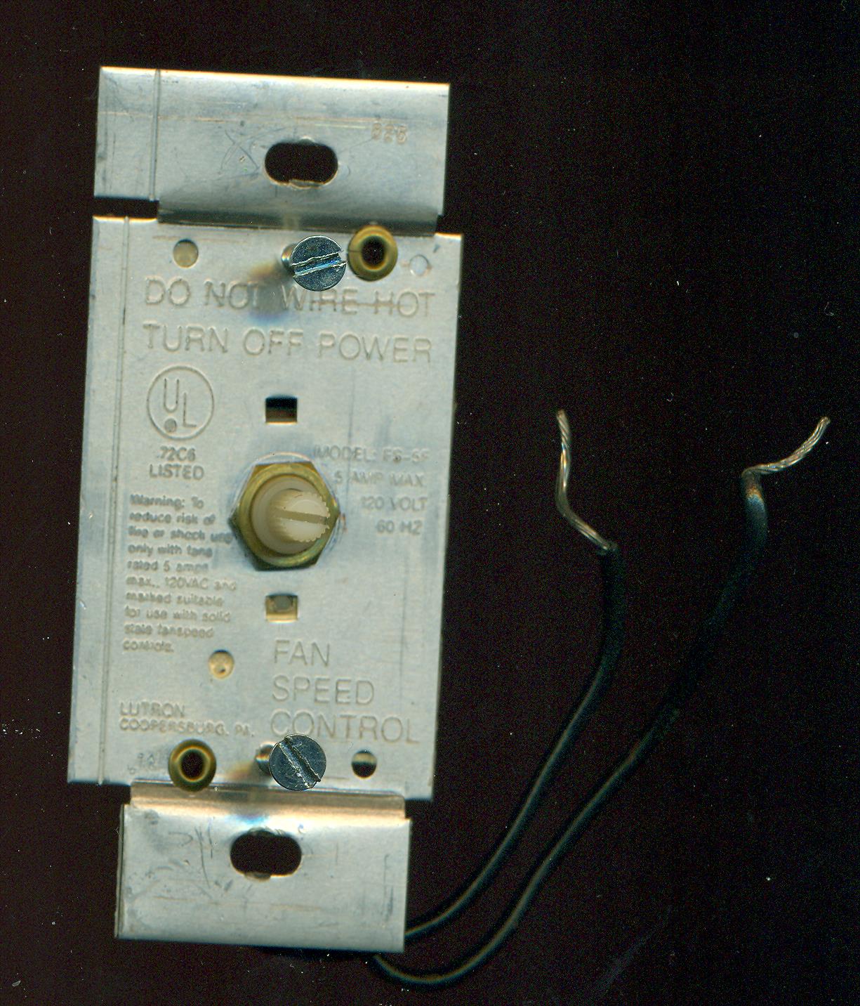

                                Attached is a photo of my LUTRON analog Fan Speed Control. You may have to use your magnifier to see up close and then drag left-right, etc. to see what you want.
                                You know, I remember that " Your fan will only draw what it needs" from a Home-Study course in Electricity and Appliance Repair I took years ago from NRI (National Radio Institute), but I wasn't certain if the warning (pasted in-part below in quotes.) applied to analog type continuously-variable Fan Speed Controls. My rationale for this was mentioned in paragraphs #4, 5 and 6 of my previous post, but from your reply in quotes at the top of the page, apparently the warning doesn't apply in this case.
                                " To reduce risk of fire or shock use only with fans rated 5 Amps max 120 VAC and marked suitable for use with solid state fan speed controls.".
                                I'm happy that you say my Fan Speed Control will work, but I need answers to the following questions if you don't mind, to bolster my "electronic newbie" confidence before going ahead.
                                Questions follow :
                                #1) I guess it goes without saying that I'm going to have to cut the white Fan Motor wires to splice-in the black Speed Control wires.........agree ?
                                #2) Since the wires from my Speed Controller are both black and the Fan wires are both white I would assume there are no polarity considerations when making these connections........am I correct ?
                                #3) After connecting the Fan wires to the Speed Control wires, can I twist the Speed Control knob all the way up (to the far-right) without burning out any of the Motor armature or coil wires ?
