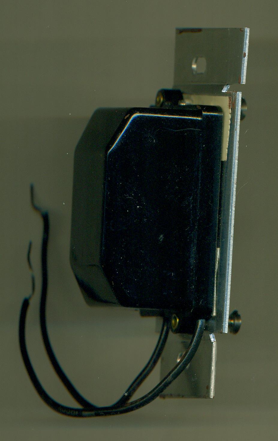

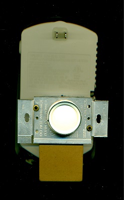

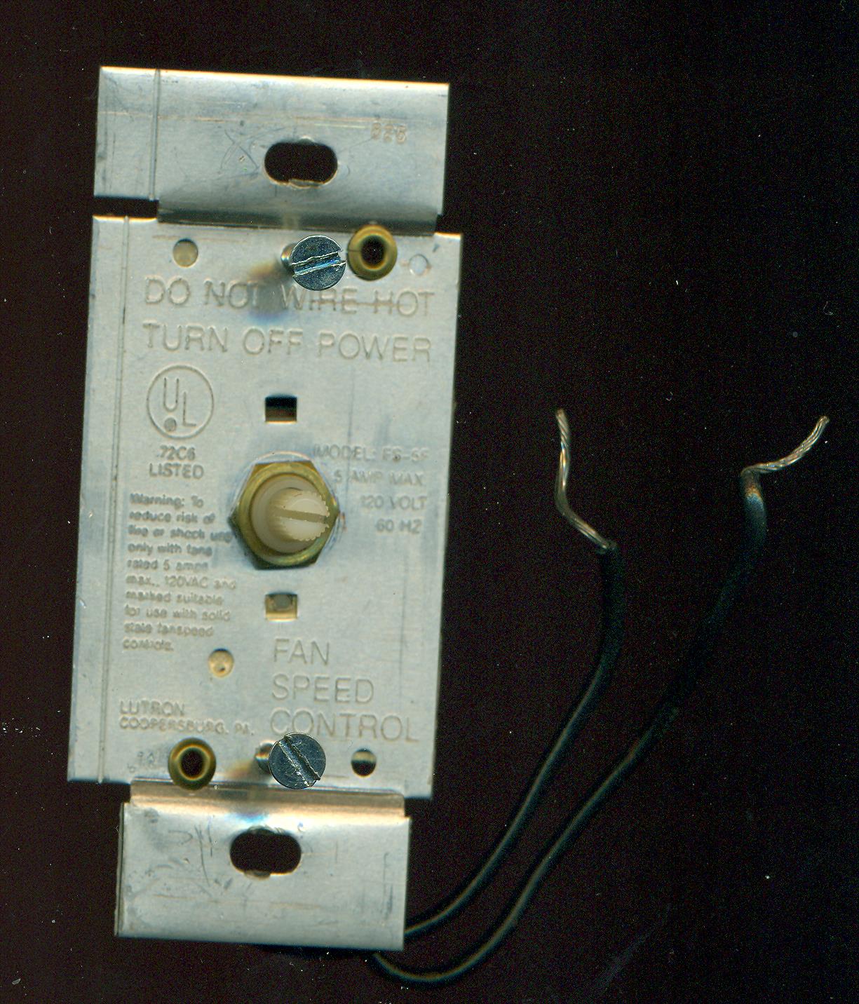

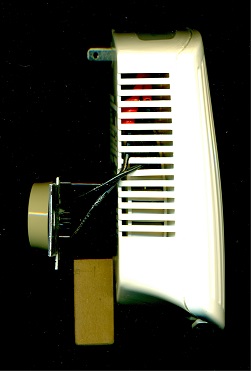

By the look of the controller, its a basically just a variable resistor that will go in series with one of the fan wires. Now bear in mind that not all ac motors are able to be controlled by this type of controller.
Also remember that you are dealing with mains voltage. If you are not sure of something, dont do it.
If I was doing the job, once connected I would be testing insulation resistance of controller to make sure there is no leakage to the exposed metal plate and double checking all connections with professional test gear. Unfortunately there are too many electrocutions and fires caused from people performing mains voltage repairs/modifications/installations that they are not really qualified to do.
, but I do like your comment that "its basically just a variable resistor that will go in series with one of the fan wires."
I checked the operation on one of my ceiling paddle fans and that's the way these Fan Speed Controllers work, for example, High Speed at the ON setting, then progressively slower as the speed setting is changed.
