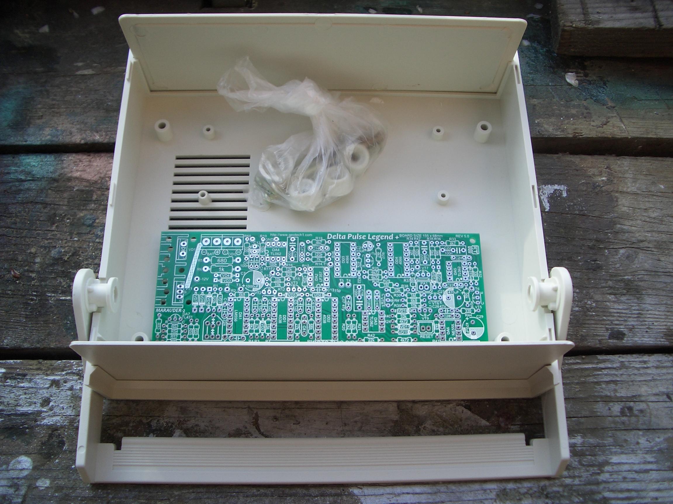

      • received the case. nice for a project.

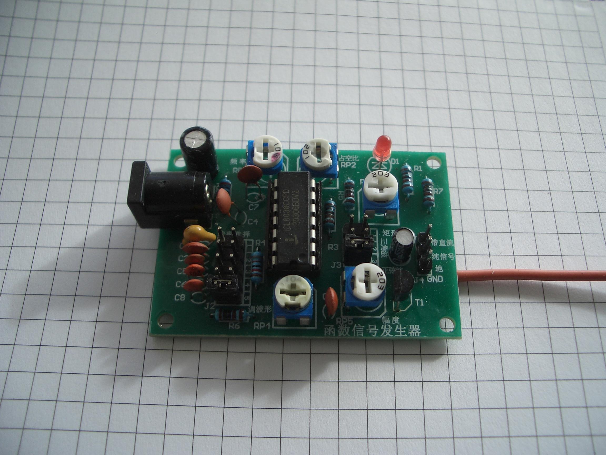

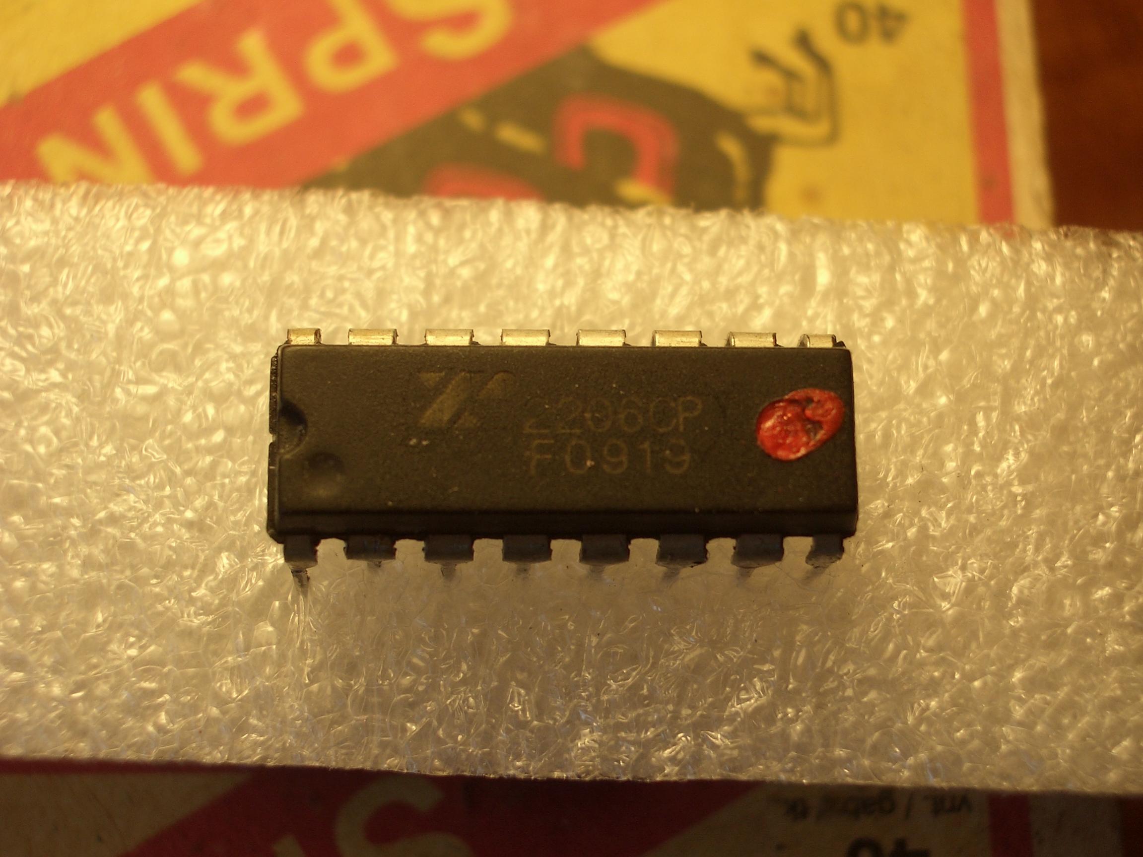

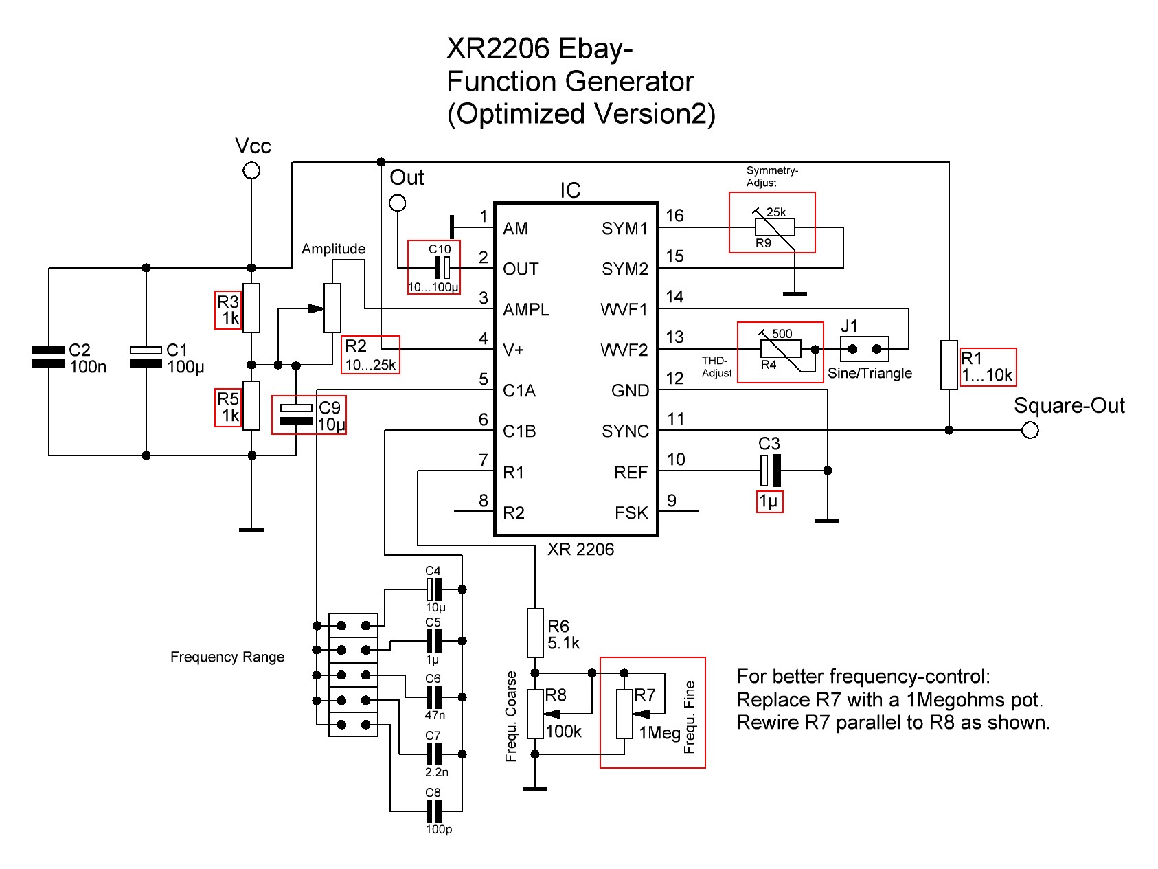

            • fake micro XR2206. i bought it on ebay from chinese.

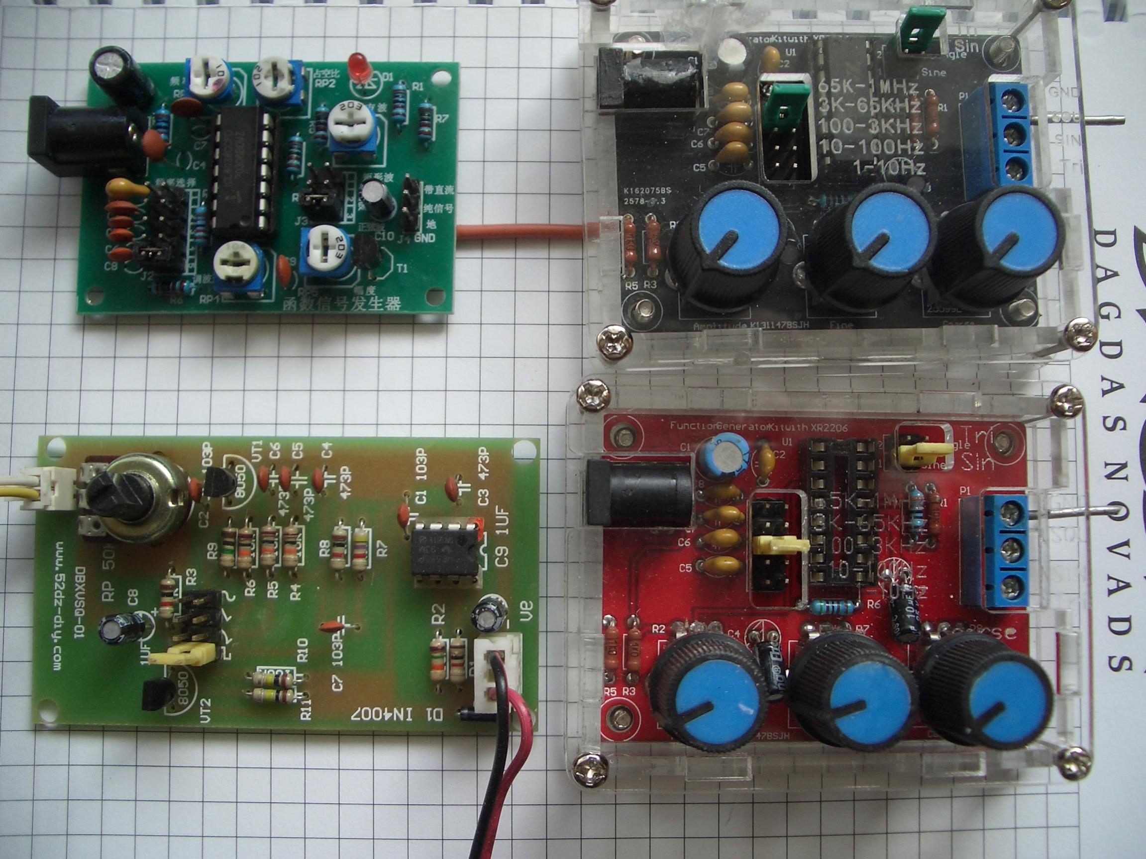

              • Dose it function ? As in Function Generator Functionate ?

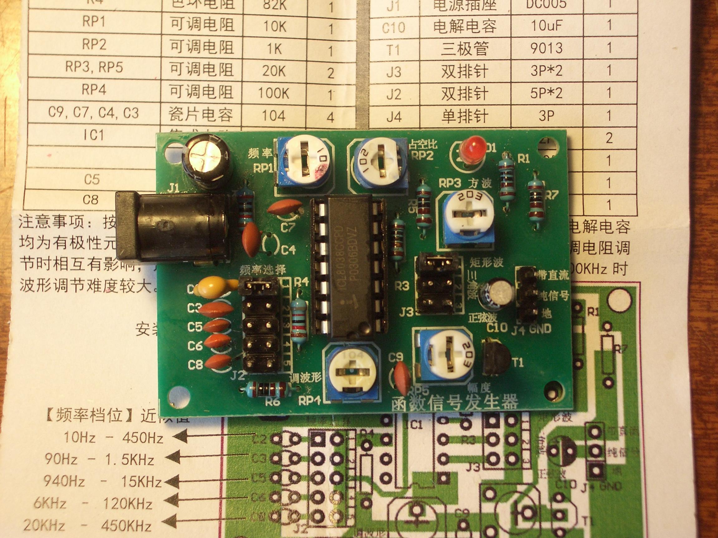

                • i did buy second kit to check the micro. now in black color. this gen is OK. then i checked the micro in both boards and it is not working in both.
                  had ordered still one micro on ali.

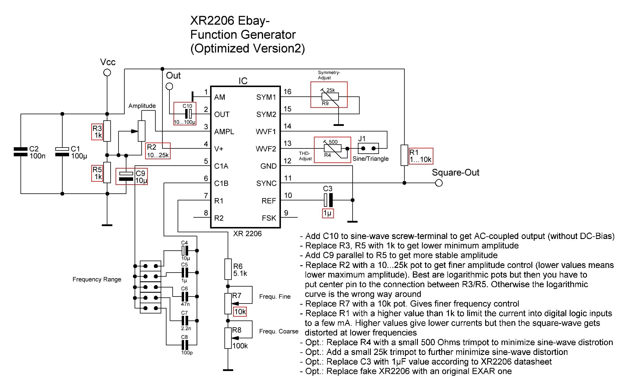

                  Function Generator Functionate perfecto. some mods i try but PCB has to work good without the mods.
                  also caution do not encrease power level above +12V because the micro is not original, not firm.
                    [ATTACH]46638[/ATTACH]
                    You can see the blacktop material in the dimple and notch. Makes you wonder what chip is really in there.
                    • LOL, Probably some Dirt Cheap u Controller.
                      • received XR2206 from ali and again - FAKE.
                          Seems it was discontinued in 2011, so fakes are all there is.

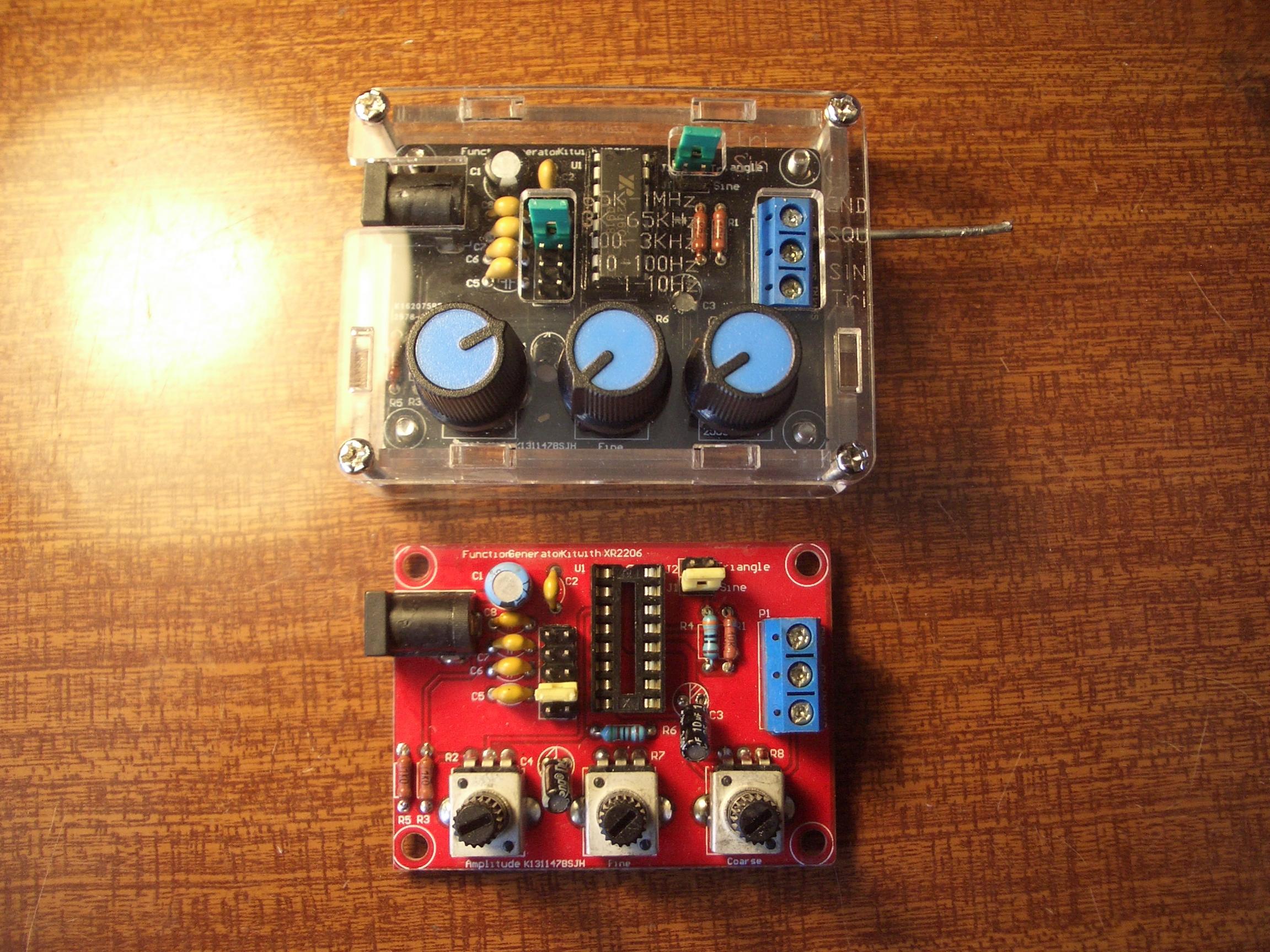

                          • good working kit

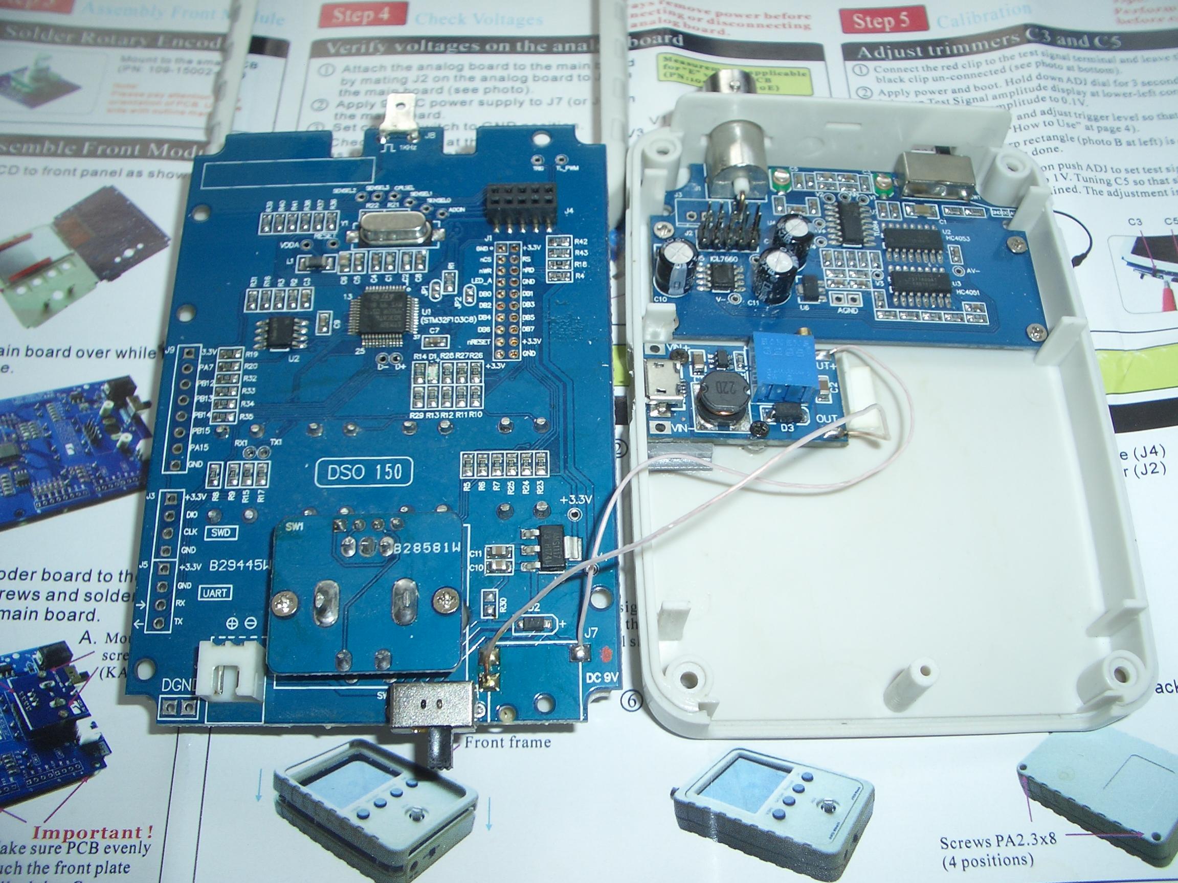

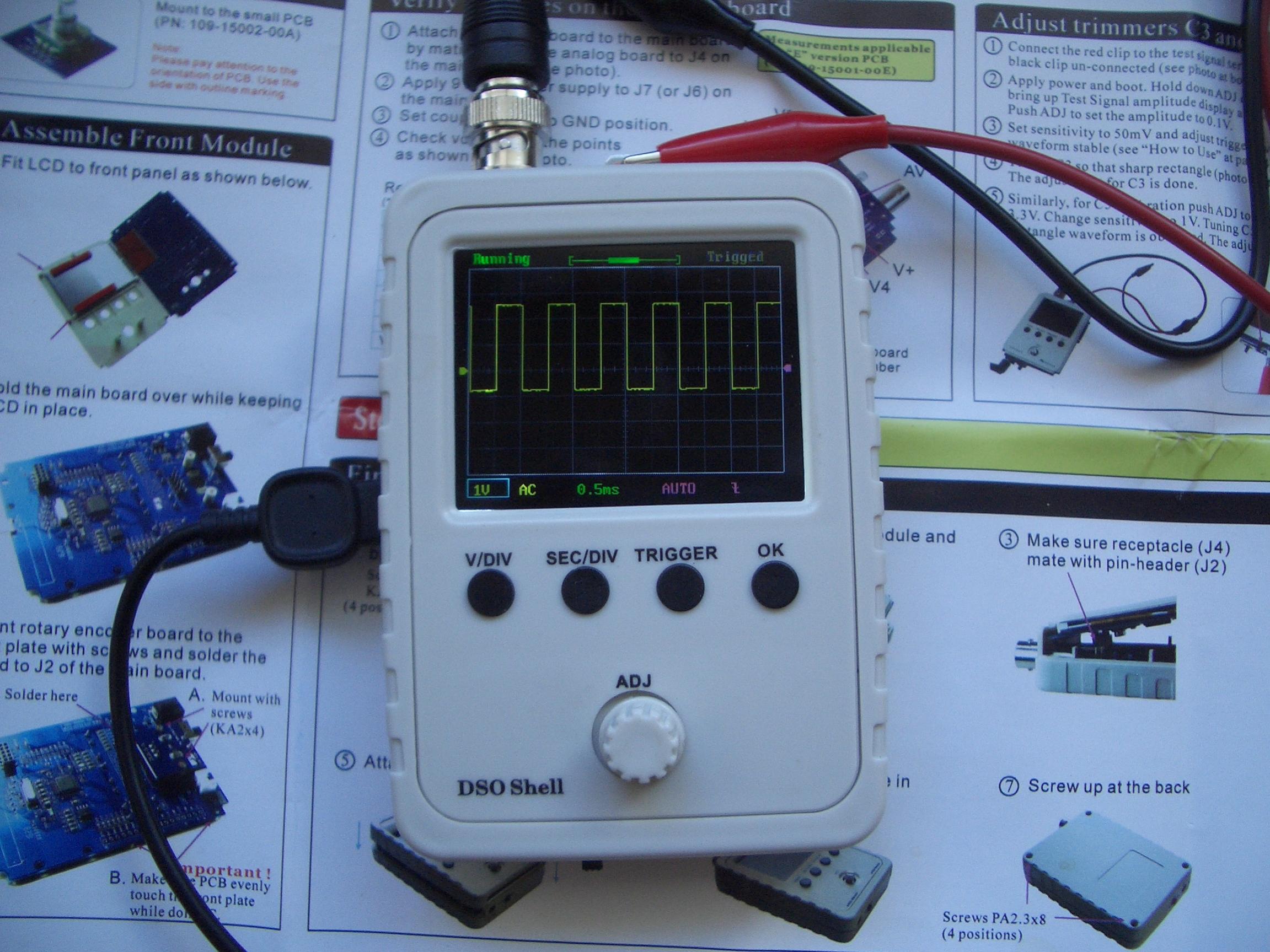

                              • dso150 ended.
